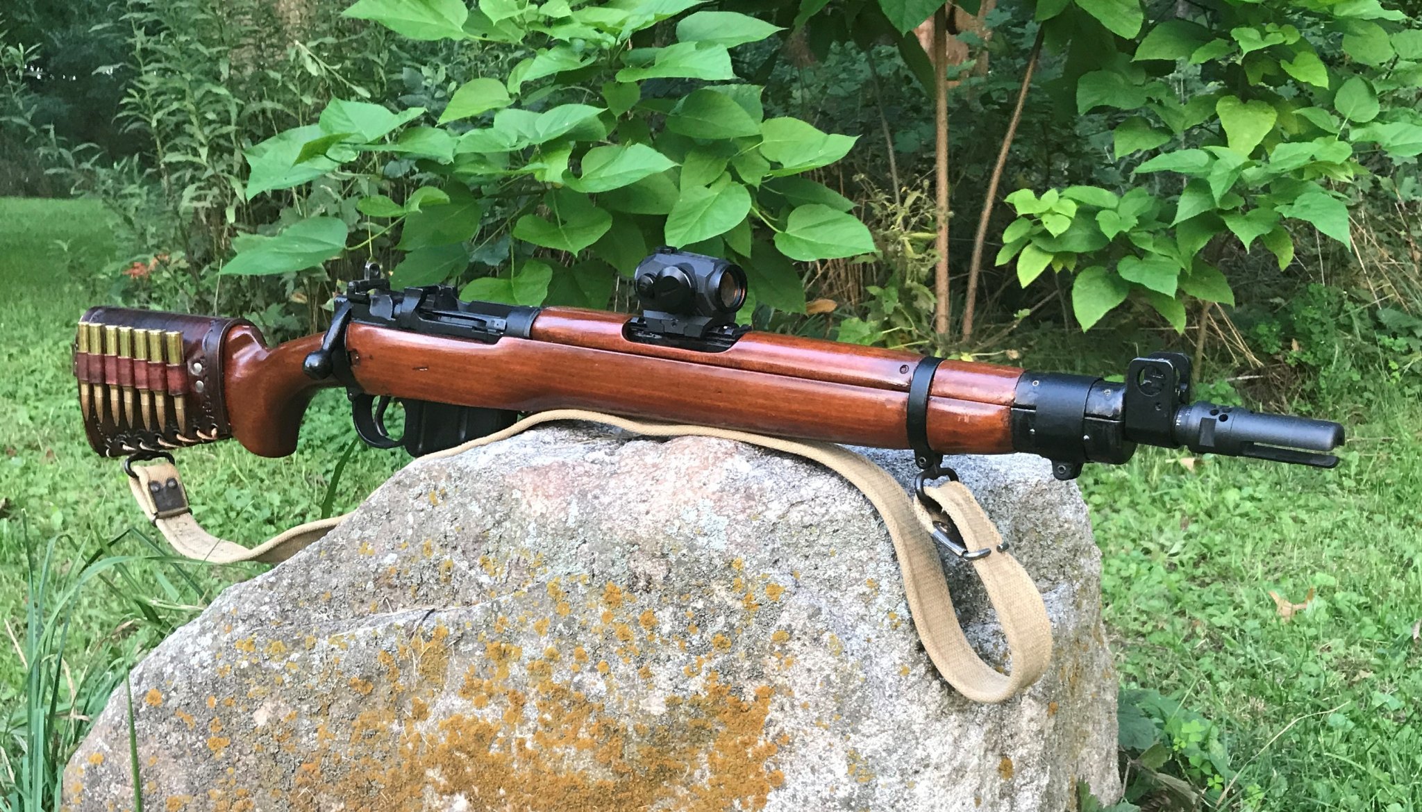

There is a shit ton of things that can be done to a Lee Enfield. Most people do tend to want to restore them. At least that's the way it seems based on the amount of "bubba", and "you destroyed a piece of history" comments I get whenever I'm showing off mine. (that I think is cool) There are those that can appreciate something different, and the fact that these things were made in the millions, so not every single one needs to represent as a historical museum piece. They make good sporters, hunting guns, ect. They used to make great fun plinking guns back when ammo wasn't so pricey. I think mine could actually serve as a viable combat rifle the way it sits now. Do whatever you want to it.
When I did my Longbranch, (I happened to like the original No4 Mk1 lines) I wanted to modernize it with a red dot. I was also thinking about the guys who make the "tanker" Garands, and the more modern M1A Scout Squad, so I just shortened it to a 16.25" barrel, then shortened the stock to match. Changing the buttstock, adding the Warcomp, and red dot were the modern adaptations.
Use your imagination, but as has been stated... let's see the photos.
Here's mine.

Here's mine.

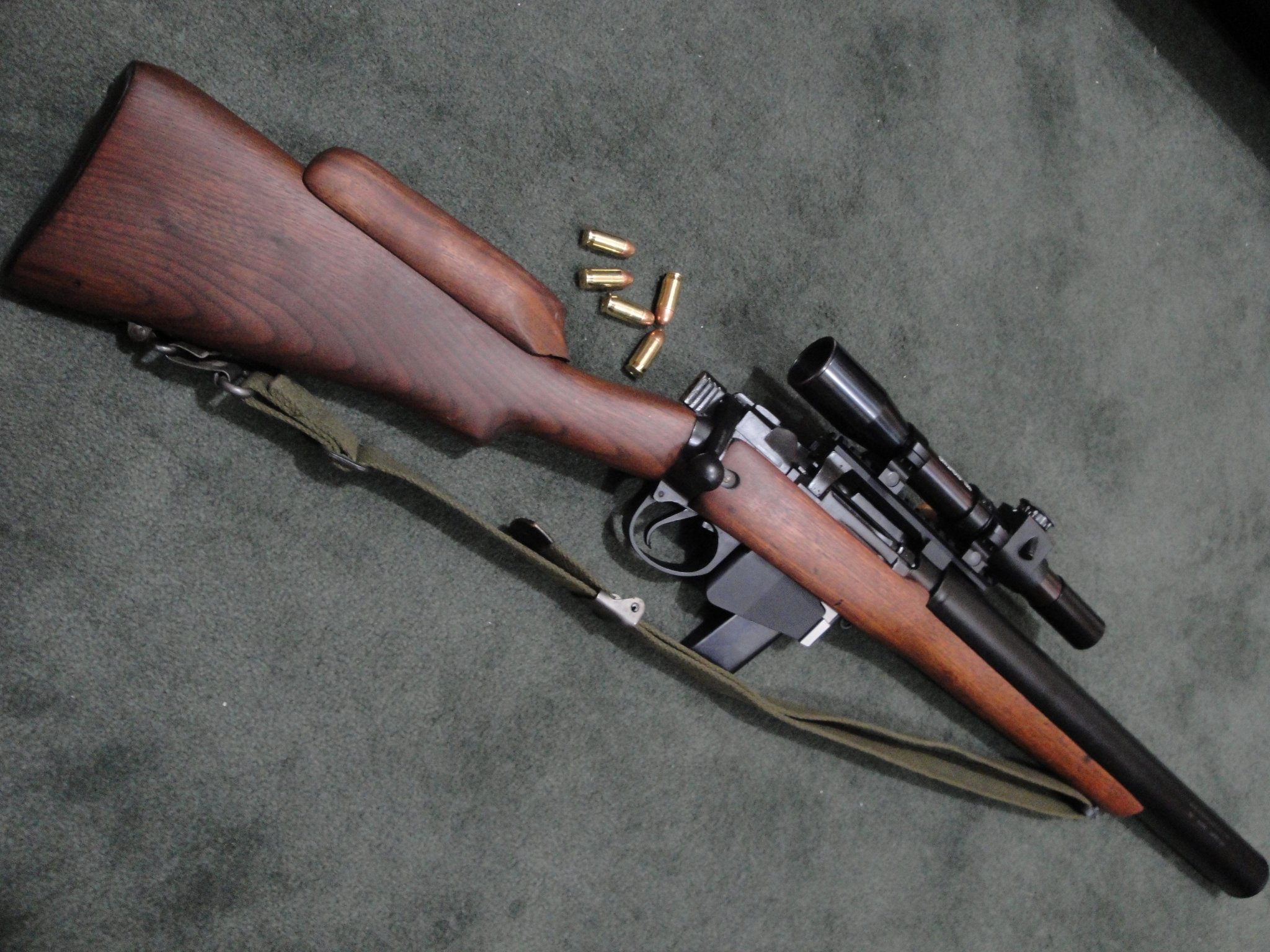

The Warcomp doesn't actually look half bad on that. Not too far off from the look of the original barrel.
I've got a sporterized No. 4 Mk 1 that someone just did a barrel mod and trimmed the stock down on. Not anything special but not as bad as it could be. Been thinking I might rework it into a semi-lookalike of the L42A1 but keep it in .303 instead of dealing with the .308 conversion. Still want to get a nicely sporterized No 1 Mk III, though, if I can't find a genuine Lee-Speed.
Look up what SOE did with the DeLisles... another neat bit of adapting!
Sirhr
Wonder how a DeLisle-ish setup in .303 would handle, even if the suppressor wasn't functional. Probably kick pretty hard.
There's someone makes clones, both SBR and longer ones with and without functional suppressors. Valkyrie Arms or some such name. Forgotten Weapons or another one of those YouTube channels might've done a video using their suppressed SBR clone, I think.

Beautiful!!!

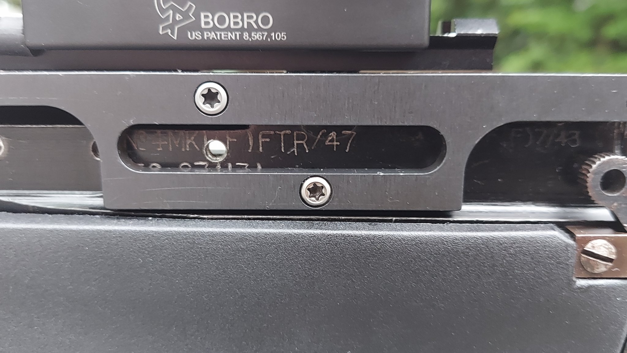

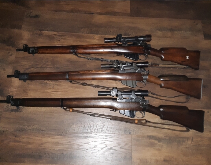

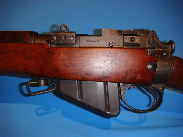

I can assure you that there were never any Mk.2's converted to sniper configuration, not even on a trials basis.
India rebuilt and converted a couple hundred Mk.1's to Mk.1/2 configuration in the 60's and incidentally they are the only No.4 T's that can be positively identified by serial number alone if that's all you had to go on.
Only photo I have on hand right now but the top one is an Ishapore Mk.1/2 conversion.
Reactions: camocorvette
The No.32 scope mount has 3 holes on the front mount (right behind the front ring) and 2 more back by the rear sight.
With the pad removed, there would be 3 holes in the rear location too. Two for the pad screws and a 3rd larger one in between for the bracket thumb screw.

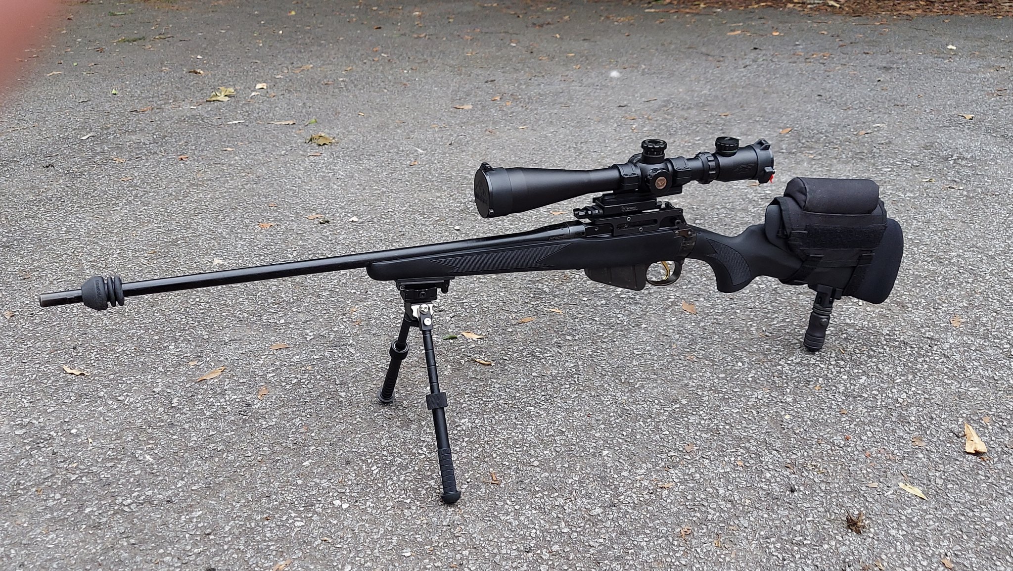

OK. Based on the photos you all are providing. I'm thinking this unit was modified at some point after the factory and whatever mount was added has disappeared over time. My three holes (insert sic comment here) are in a different location and have different spacing.
Assuming it isn't some cheap plastic stock, and everything is more or less aligned down the long axis - Sounds more like a shooter recoil management problem than a mechanical problem. Have you had a trustworthy second shooter have a crack?
IIRC, The accuracy standard during production was something like 4 out of 5 shots into a 1"x1,5" rectangle at 100 feet. Mine usually does about 3-3,5" at 100 yards with german surplus and a(n add on) PH rear sight. If you're getting anything about there, it's shooting about as accurate as expected.
I'm not experiencng this issue with any other rifles. Don't think it's me. But I have been wrong before. I'm hitting the target some where between your numbers and the production values you stated.

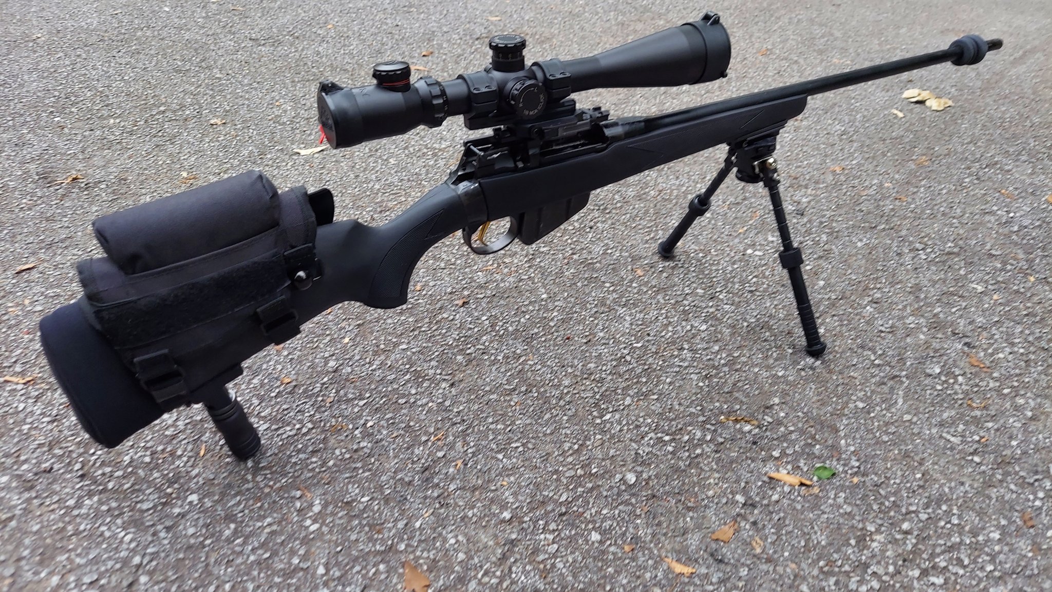

You have a No.4 Mk.1 made by ROF(F), ( Royal Ordnance Factory- Fazakerly) in July 1943 that was FTR'd, ( Factory Through Repair= means it was completely rebuilt at the factory) in 1947 by Fazakerly.
Reckon you got that scope high enough? Geez you must have a neck like a pond gannet.....
I'm surprised you had enough elevation adjustment to zero it inside 300 yards.
That just might explain the weird recoil impulse you inquired about too.
^pond gannet^
That just might explain the weird recoil impulse you inquired about too.View attachment 7623531
^pond gannet^
That's an egret though...

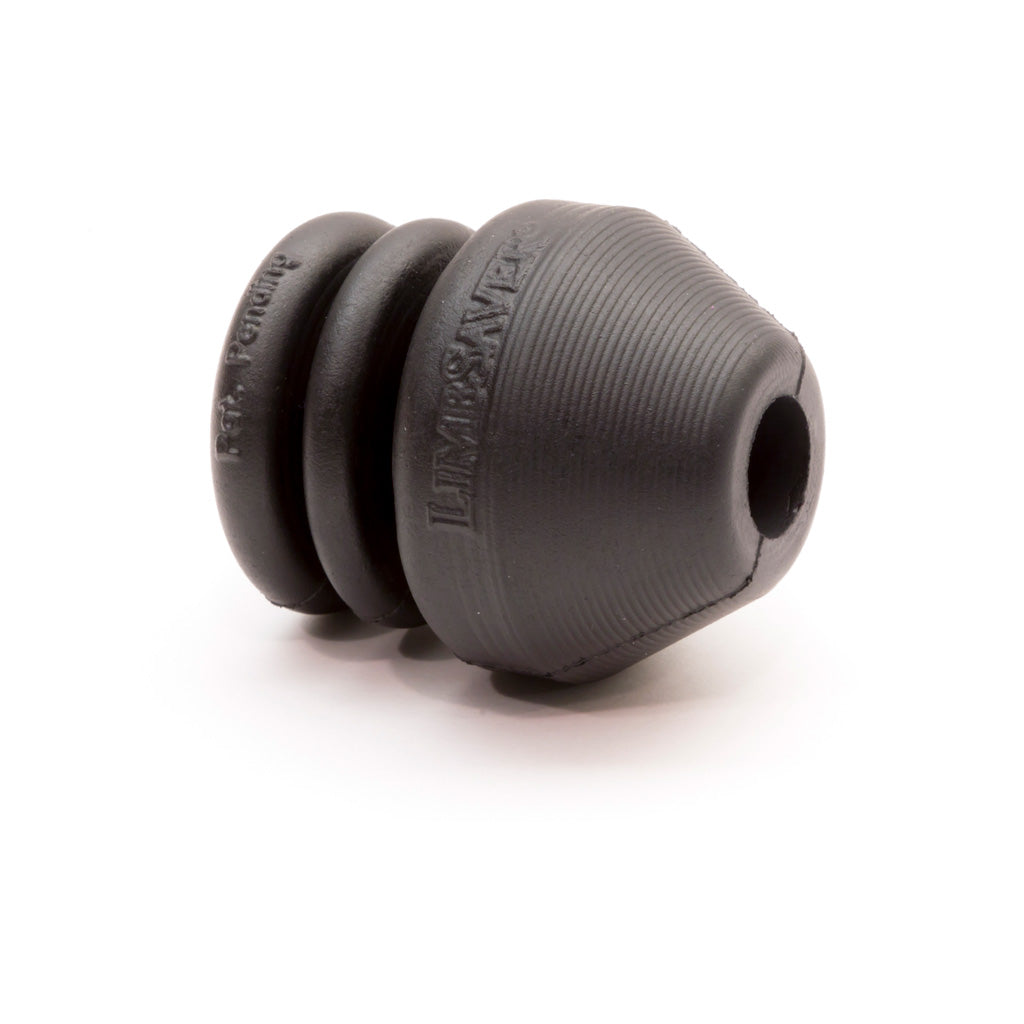

@Secret SQL What's that gewgaw on the barrel there? A weight? Could be affecting your recoil, maybe?
^pond gannet^

OP, you did not hurt that rifle at all.
Curious what that thing on the barrel is?
Sirhr
It is a barrel tuner I believe.
