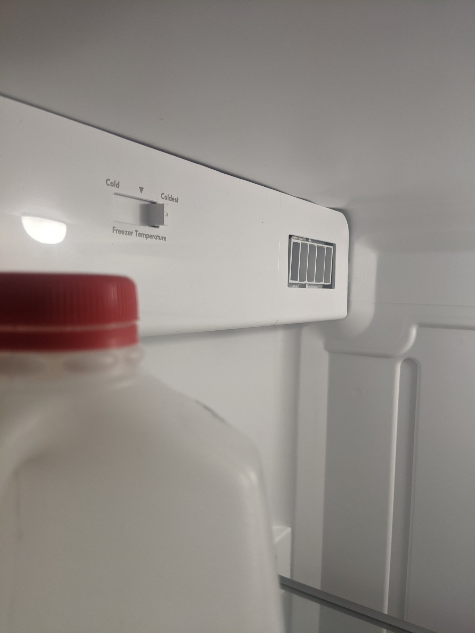

    I’ve got a GE French door deal with freezer on bottom, less than 4 years old and for whatever reason, the bottom part of the refrigerator is freezing crap and the top part is like 60 degrees and keeps ruining my meat. Any ideas? Freezer part is fine.
    Anything blocking the air pass through vent?

    Anything blocking the air pass through vent?View attachment 7693689
    Not that I’m aware of but I’m fixing to go look.

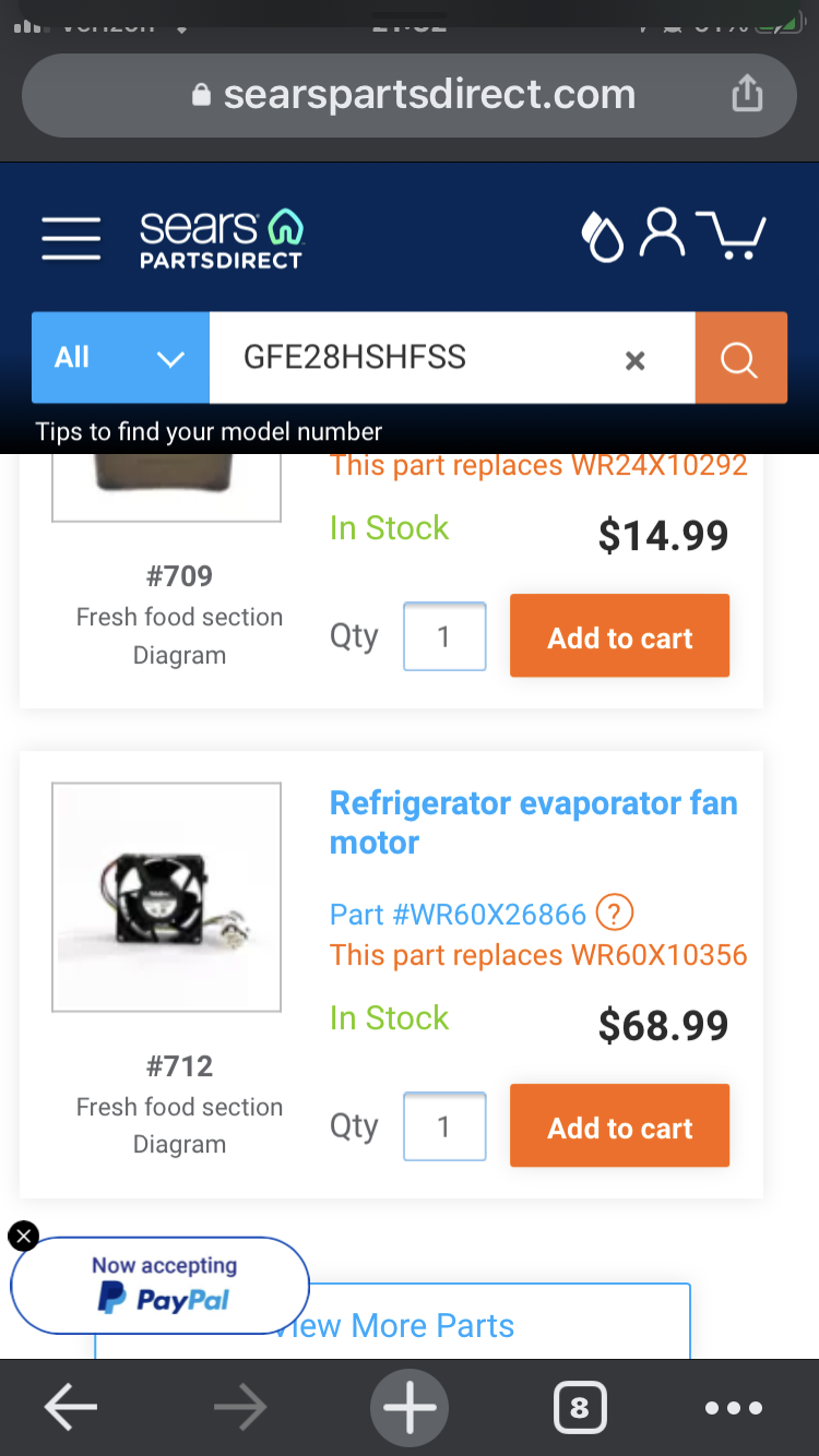

    With your doors open, you should’ve able to press and hold the door switch(s) and wait and see if you hear the Evap fan come on. If it doesn’t come on, usually within the first 10-15 seconds, that’s the problem.
    Your model has the fan mounted directly on top of the Evap and is known to go out, causing the temps to go up and the stuff in the bottom near/under the crisper drawers to freeze up. It’s an easy fix if that’s what’s going on; here’s the part:
    Mine is doing this. I think my defrost heater element was broke, so it never defrosted, iced up, and stopped flowing air to fridge. If I manually defrosted freezer, it was fine for about 3 weeks. Just swapped it out today. We'll see it it fixes it.
    Reactions: SilentStalkr
    You got a manual for this thing? Cause I have no idea how I get access to this but the deal at the very top of fridge is certainly not blowing. Just moved everything to downstairs fridge.
    That was it. Working like a charm even tho the parts guys pissed me off. Made the mistake of sending my wife this morning to pick up the parts and the dude gave her the wrong damn parts. The box numbers were wrong and to add insult to injury the parts inside didn’t match the numbers on the box and had clearly been opened. So around 11ish we high tail it back down there calling on the way to have them hold the correct parts they claim they now have. And it cost me twice as much. $161 for the part and the update module. But it’s done and didn’t have to wait 3 days or pay someone the $600 it likely would have been to come out. I figure it’s $200 minimum for a tech, $160 for the parts and then likely would have charged a couple hours labor so yeah $600 probably about right. Was super easy. Thanks for your help gents!

    Well I hope that was it. It was cooling and then kind of stalled out at 50 degrees.
    Give it some time. I usually tell my customers 24 hours for it to get back to temp. You don’t want to push the system to hard and something else gives. Always set your temps a little higher, say around 42ish degrees, and let it hit that, then set it back to 37 for your fresh food section (37 degrees and 0 degrees are the factory spec’d temps).
    Also, what is the “update module” they sold you??? All you needed was that fan I attached here.
    Well and that’s the thing. Seemed to be running fine when I just put the fan in, but the video showed and update module plugged in via Ethernet and once parts guy got the right parts he confirmed that GE says you need this updated software module with the new fan.
    Those fans run PWM, and there could be new code for variable speed and/or different PWM frequency on the "new" part.

    Mine won’t seem to drop below 40 without turning TC on. It’s been at 40 for about 3 hrs. Certainly a hell of a lot better than 70 but it makes me wonder if it’s still not working correctly. Guess I’ll wait till tomorrow and see what’s up.

    So it edged down to 38 overnight but that’s as low as it goes and it quickly climbs back up once the door is opened. I feel like something still ain’t right. Everything seems fine, no ice build up, no weird noises, fan runs smooth as far as I can tell when it runs. Ice is being made, water isn’t all that cold tho and it just don’t seem to be getting cold like it was and for this reason I have not put anything back in it.
