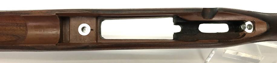

Bedding in my Model 70....

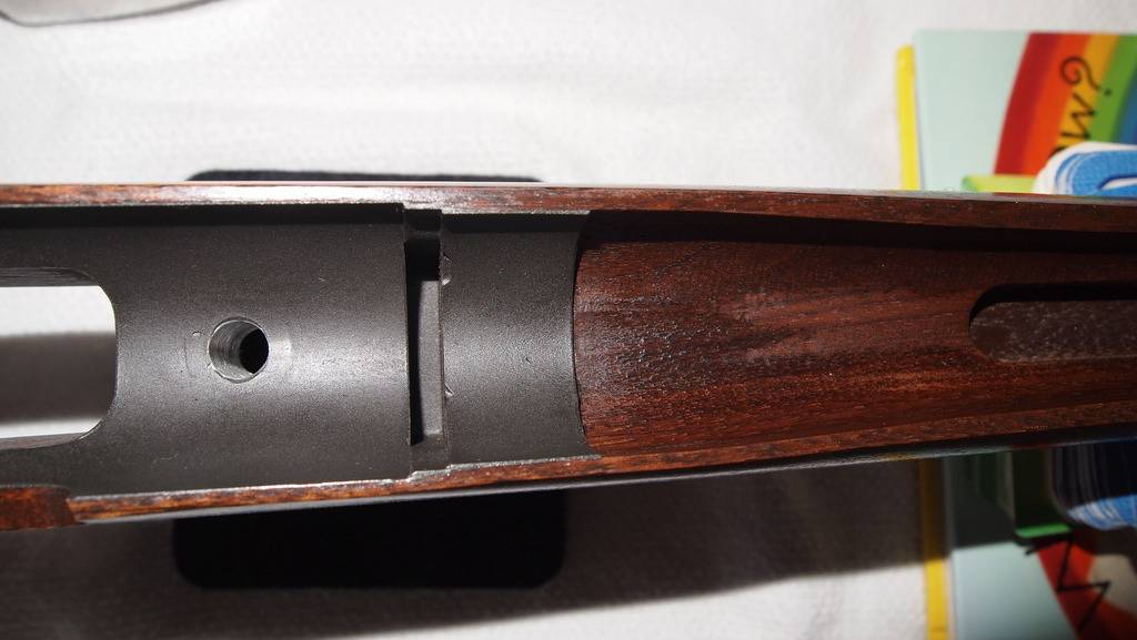

Bedding in a M40 (Remington 700) clone.....

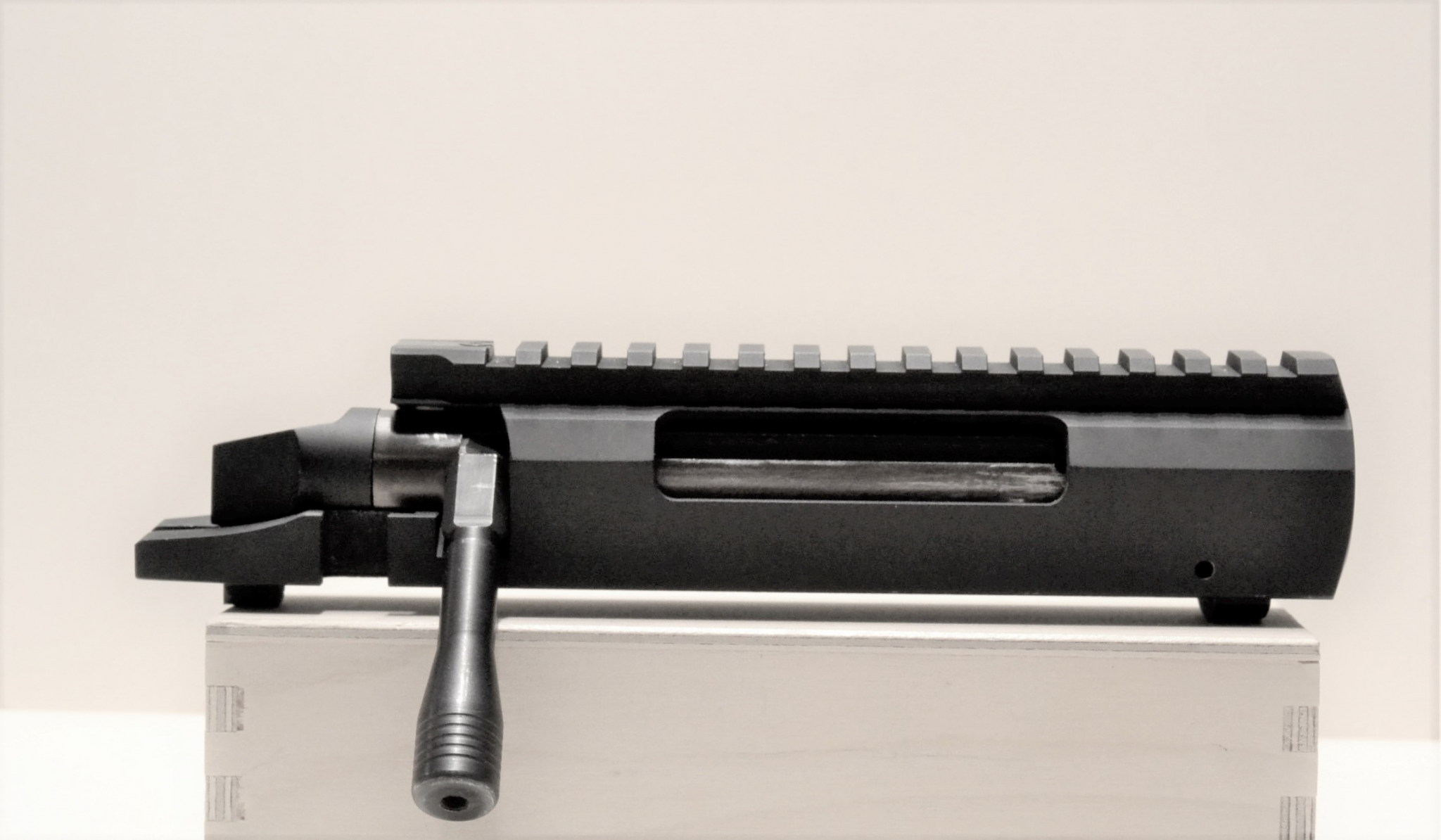

Hide member @THEIS is working on a flat action based rifle...
Reactions: Milf Dots
Hi,
This topic always brings out not only debates but peoples personal feelings and black magic thoughts.
Quick thought (I will have to reply later with full opinion lol)...
Structural building beams are not round for a reason :)
They have flat top and flat bottom on I-Beams.
It is easier to flex/bend a 1" round rod than it is to flex/bend a 1" square rod of same alloy.
Sincerely,
Theis
