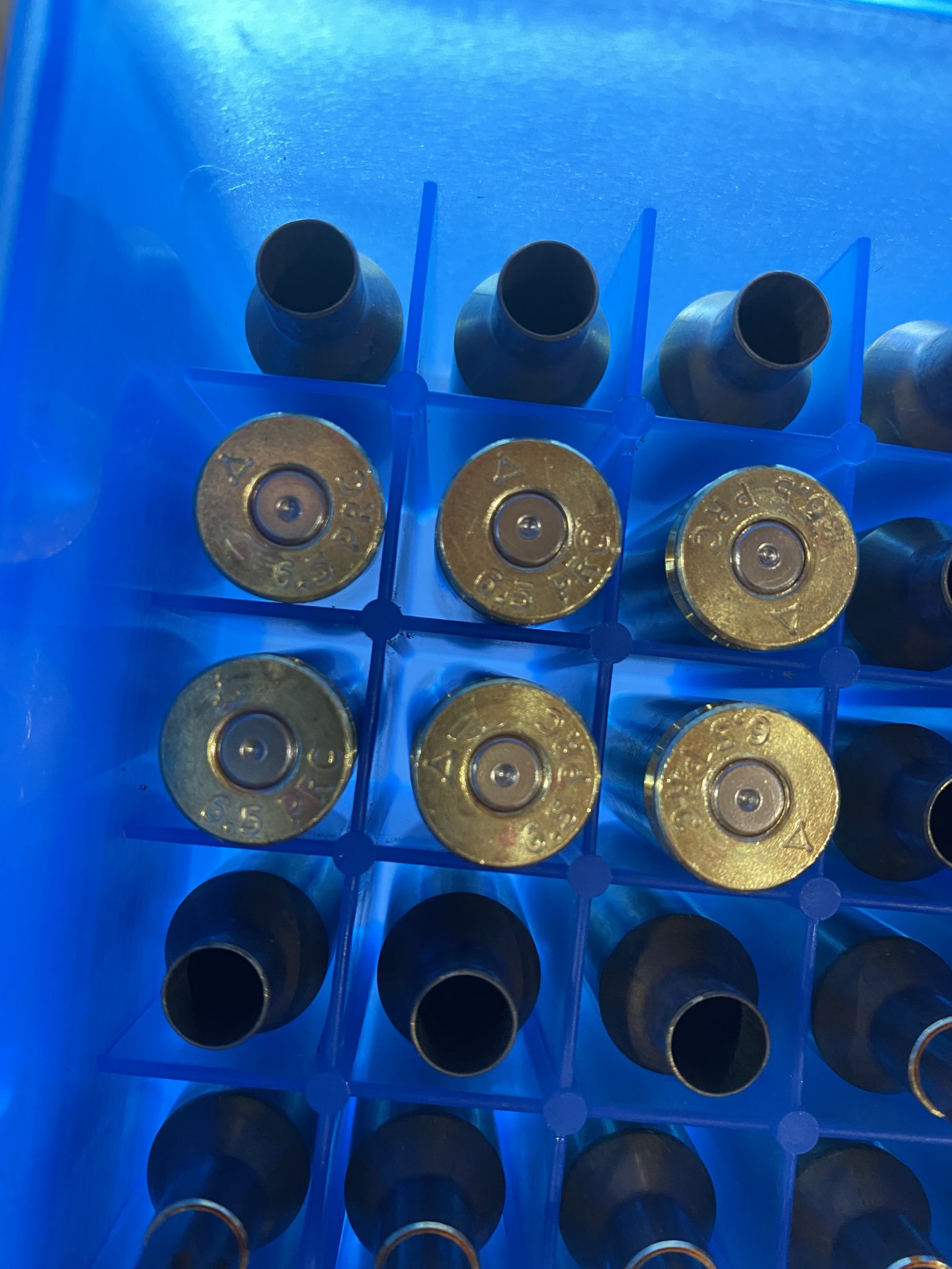

Any concern with these ejector marks?
Lucreau
Oct 30, 2017
1,095
298
CO
6.5prc. Brand new adg brass. Wasn’t getting any sticky bolt, and from what I can tell the primers still have a nice rounded edge to them. Very faint mark on the brass. Any real concern?
How much did headspace grow from virgin to fire formed?
If it was within 4k or so, I'd probably back down a touch. If it grew quite a bit, reshoot a few with the FF brass and see if you still get ejector marks.
New adg brass
156gr Berger eol
Federal 215m primer
58.2gr N565
2.955” OAL
Curtis valor action
Based on the information I'm aware of, that load is definitely on the hot side, and is over the pressure limit according to my QuickLoad App. The main reason for being over the limit is that ADG lists the case volume at 66.9 gr of H2O where other brass tends to be a couple of grains higher (like at ~68.8). The ADG brass is heftier (thicker walls), so it should handle higher pressures . . . to some extent. The ejector imprints are a sure sign of high pressure and I'd certainly back off, even if there are no hard bolt lift (which might be due to the heftier ADG brass). Having that much pressure could be a serious problem if you find yourself shooting in higher ambient temperatures. Anyway, take a look at what I'm looking at in QuickLoad:
In the world of ejector marks those are only moderate IMO.
I consider 1/2 crescent circle mark a mild pressure sign and a deeper, sometimes even ripping brass along the edges of the mark, very high pressure sign.
Often blown primers follow.

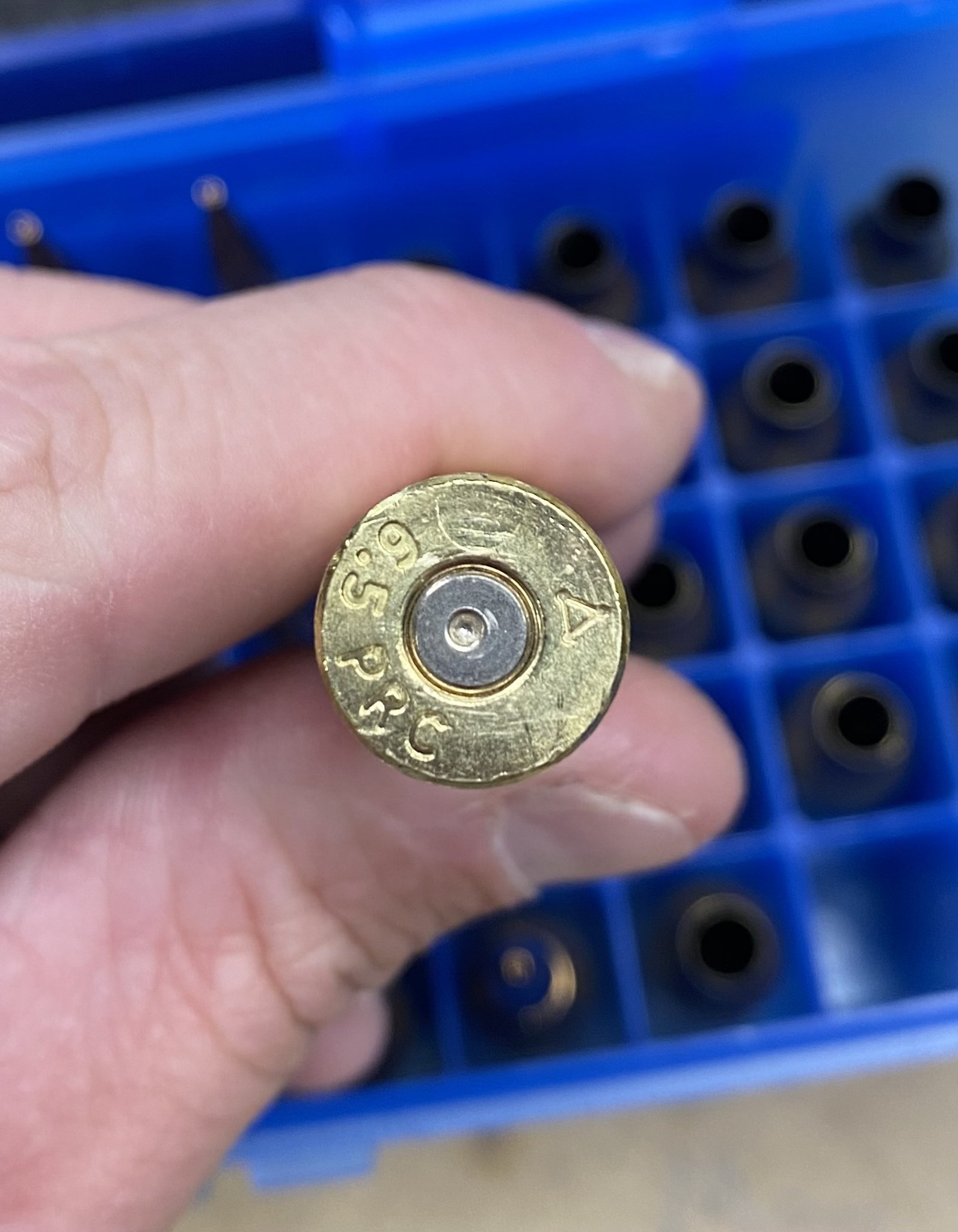

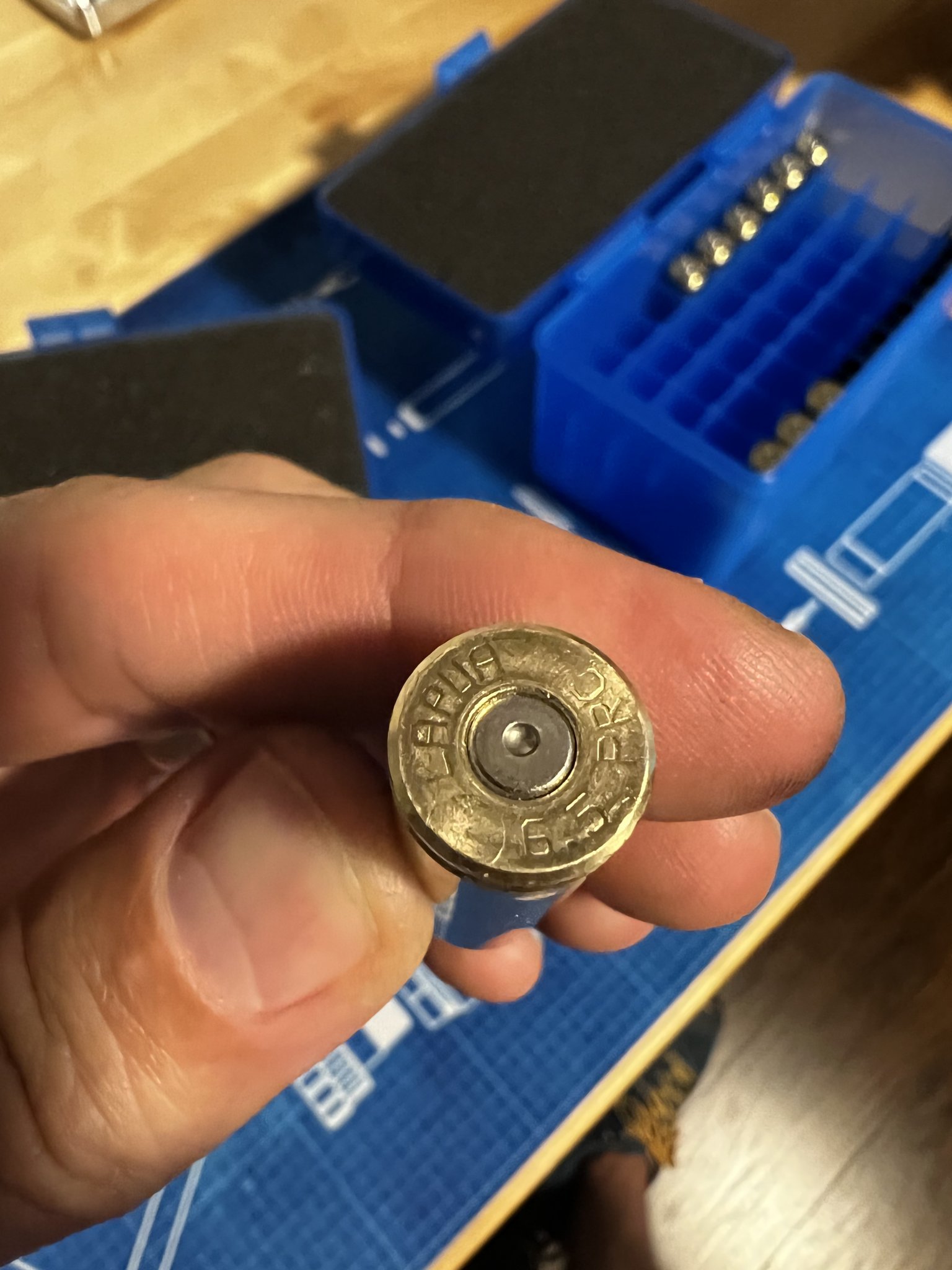

How many rounds since you cleaned? 6.5 PRC and other overbore cartridges that use slow(er) magnum speed powders tend to carbon up faster and that carbon build up will increase pressure and velocity in short order. I suggest cleaning 6.5 PRC's every 100 rounds at a minimum.
Brass flow into ejector slots is almost always either a headspace or excessive pressure issue. If your headspace is good.....
Have we measured the h20 capacity yet or just gone off QL and what ADG says?
I’m not the OP but I did h20 capacity (68.7gn) of mine and ran it in Gordon’s. They don’t have a 156 eol in Gordon’s so modified a bullet profile, adjusted it with my velocities and it says I was over pressured. Surprising because I’m still much lower than what Berger sent me data wise. Berger is definitely is aggressive compared to Gordon’s and VV data.
I’m going to test with BR2 primers this weekend and we’ll see if I get similar pressure signs.
I’m getting a very slight imprint of ejector. Case shoulder grew .003.
If someone wants to run it through QL for me and see if data is similar to GRT: n568, 24”, 7.5, 68.7gn h20, COAL 3.0355, saying over pressure at 59.4
