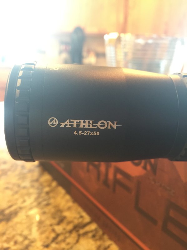

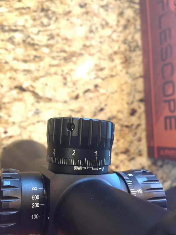

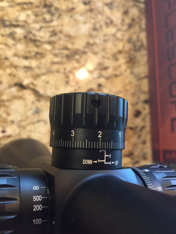

Noticed enlarged picture on Athlon's website for the Ares BTR 4.5-27x50 MIL scope shows the ocular end labeled as 2.5-15x50. Sure hope they are not all like that! :confused:
Also curious to see pictures of the turret markings on the production models. It would be a missed opportunity if they didn't extend the tic marks at the half MIL markings on the turret.
Thanks!
I see 3 of the updates that I requested (I'm sure others did as well), so it's becoming clear that they do listen to their customers. Now I'm really curious to see if they adjusted the tactile feel of the turrets.
Thanks poke_53, was just getting out the camera to shoot a couple of pics when I checked the newer replies on the thread. Mine says "Athlon 4.5-27x50" on both sides of the ocular bell, with "ARES BTR" at the 12:00. And, as you can see from poke_53's photos, there is an extended hash mark at the half-mil on the turrets.
Honestly, as far as I can see, there's not much that Athlon didn't do on the Ares line to address the requests that I've seen posted online. The reticle is basically the same as the original mil ret on the Cronus, the zero stop is simple to set, the glass stays bright out to 27x, the click detents on the knobs are distinct enough to count w/o having to look at the knobs....I like this one a lot so far. I showed mine to two shooters at our last PR match last Saturday and sold the two extra Ares scopes I had coming right there. One of these guys has a Kahles K624i AMR, the other a Gen II Razor, and they both liked what they saw. Also, the parallax knob is marked 25yds at the low end, so the scope would be excellent on a 22RF trainer as well. Looks like I need to place an order for at least a couple more Ares scopes with Athlon...
poke_53, thanks for posting the pictures of the actual production product.

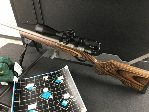

Wouldn't we all want a TT, S&B or the like on every rifle we have!! Or if one could afford it even the $1500 scopes on every rifle, that's the kicker though isn't it, at least for the standard class of worker. Last 1.5 years I've been discovering I can do nearly as well with those little cheap Talos BTR 4-14's as the higher scopes, which then became my default inexpensive scope as confidence was earned over time, with the Argos 6-24 just behind it. Basically it's really neat having those nifty features in cheap scopes that work well which is "the hype", not that they aren't what they are, nor should they be anything else considering their price point.
Man, great price and very cool rifle!!! I had one of the 64MS silhouette rifles back when they first came out. I always regretted selling it when I left the game.
