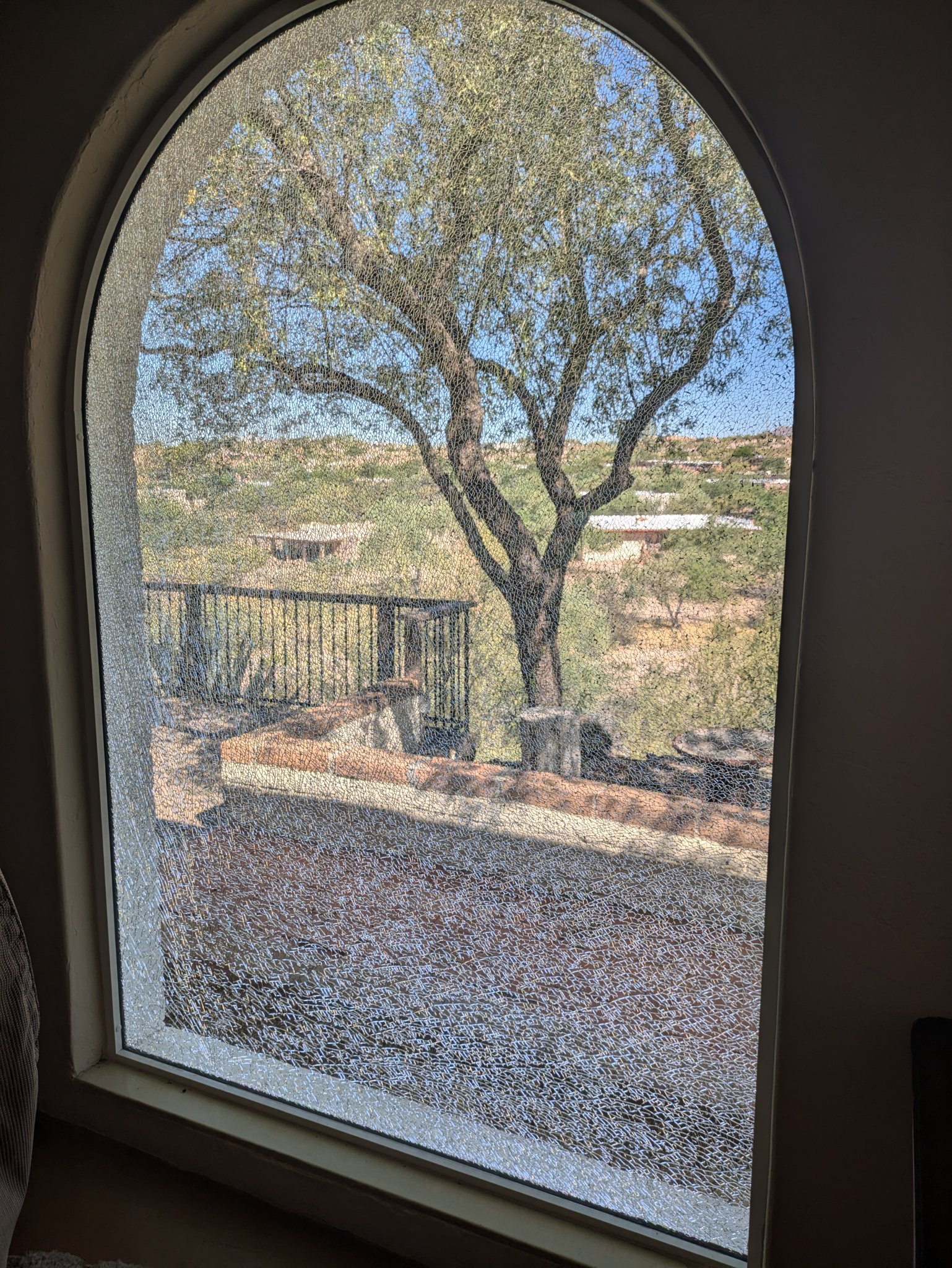

I purchased a dual pane tempered glass window last year, and the outside pane shattered while we were out of town.
This is what it currently looks like:
Unfortunately the company I bought it from won't return my calls and emails, so looking at other companies for a window replacement. One company came by for a quote, and I asked them what they think caused the damage. In our discussion animals came up, and I told them about a small house finch that frequently taps on the window. They said that could be it.
Seriously? A 2 oz house finch can destroy a $6000 tempered glass window? Is there any truth to that, or am I getting bullshitted here?

Look carefully for a stamp on the lower left or right corners for manufacturer.
The most common cause of this in Tempered glass is a Nickel Sulfide inclusion. Just like your wife's diamond ring there are small flaws in glass. The problem with tempered glass is that the whole damn thing is in tension. Tempered is most vulnerable at the edges. Those inclusions basically are jagged edges within the tensioned glass.
The phenomenon is called spontaneous breakage. When we use Tempered glass on commercial buildings it all gets heat soak tested. If there are any NS inclusions present, the glass explodes in the oven during testing.

I had a full height thermopane panel do exactly the same thing. We had a glass guy come out and I told him I had no idea of what could have caused it. He pointed right at the origin of the breakage, which was about waist high.
He said “I notice that your dresser is right next to the door. Do you get dressed right there ? Is it possible that you were putting on you pants and maybe your belt buckle lightly hit the glass ?”
I said “shit, you’re right, that was about two years ago. I had forgotten all about that”.
He said “it isn’t as uncommon as you would think”.

Definitely originated bottom left. but highly doubt the bird was involved. Is there a hole at the spot the crack started? If not, it mostly likely started at the edge. Tempered glass is most vulnerable on the edge. If they didn’t shim it correctly or bumped it during install it could lead to this.

No hole at the "origin" spot.
Having worked for the big red bird when I was really young I can tell you that tempered glass does some weird stuff. They will just let loose and shatter. Stacks of patio doors would have one that would shatter in the stack. There was a flaw somewhere in the pane. You could hear it as they sat in the warehouse.
Sometimes there will be a seed along the ground edge and over time it will shatter. The ground edge of the pane may have been sharp and pointed and after install some shifting occurred and put stress on the edge causing it to shatter. It doesn’t take much to make them shatter some days and others you can beat the edge with a hammer and it will take a couple of strikes to do it.

It is amazing how hard you can hit tempered glass and not break it away from the edge sometimes with a hammer. A spring loaded window punch like fireman use, and we used to test glass samples going out for certification or our daily logs testing, will break it easily. A slight tap on the edge will do the same.
As others have said, tempered glass is under a lot of pressure. You would come in the next day and find lites that exploded in the rack over night from some small flaw.
Probably a flaw in the glass or it might have been resting against metal in the frame if not properly shimmed with setting blocks and the expansion and contraction from heating up and cooling popped it, the edges are the weak link with tempered glass.

honestly bud, when I installed tempered glass, sometimes just the hot sun would do it and it would shatter into a million pieces.
one time carrying a 50 pound ish piece of glass, I had a wedding ring on my hand made of gold. well that gold ring touched the edge as I was carrying it so a little bit of weight on it, shattered right in my hands.
tempered glass is funny shit.
you beat on the front of it though? tough as nails. we would try and bust old pieces sitting around with a hammer...
anyways, I have no idea the policy on replacements where it was so new but I'd assume if it didn't break the day they installed it, they won't cover it.
best of luck man, hope it doesn't happen again.
if that fuckin finch or whatever was pecking on the edge or corner... maybe...
anywhere not directly on an edge, like say just the middle of the front, no fucking way, bet a thousand dollars on it.
if a glazier left exposed edges on tempered glass after installing it he should be shot.

I'm starting to learn how fickle tempered glass is. It's pretty interesting.
The day it likely shattered was a day it was well into the 100's for temp. I checked the records on my weather machine, and the temperature was around 109° F when the glass broke. I think that had something to do with it.
Maybe a defect in the glass, some induced stress due to incorrect installation, or something else that was exacerbated by the high heat.

It does because it sits about 4" off the ground.
The window is approximately 60" wide, and 87.5" from bottom to the top of the arch. The vertical "legs" (as one company called it) is approximately 60".

2 other options for you.
1. Laminated meets code for safety glazing. Might be cheaper.
2. Likely the cheapest route would be to replace the pane with annealed and then have them install a safety film (think window tint). you could have them film your other 2 windows with the same film so they all match. Lots of tint options available.

I didn’t look real closely, but is it possible/desireable to remove the existing windows, reframe and replace with rectangular windows?
It seems to me that the excessive expense comes from the present windows being irregularly shaped and not so much the tempering of the glass.

Cheap Chinese tempered glass is prone to going boom in the middle of the night with nothing happening at all.
A small flaw in the glass and repeated heating and cooling and one day in the middle of the night boom all by itself.

I’ve been out of the glass business for 15 years but this is all USA made, even the plate glass. Template would be sketched and sent to the tempering company. They would custom cut two pieces of glass, typically by robot, then temper them before installing them on the frame and making the unit. Turn around used to be 6-10 weeks in the Midwest.
The company you order from could also cut these and send them off to be tempered and made into the unit.
I agree with @Threadcutter308 that reframing that window into a rectangle might be cost effective even with a new aluminum frame.
I kinda like it like that. It has sorta art feel to it. Consider keeping it?
