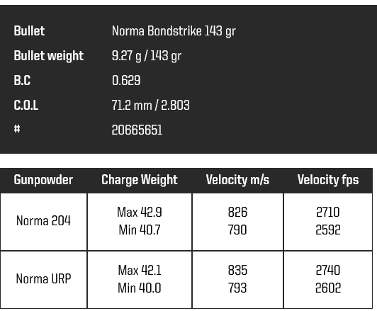

For posterity - here's Norma's data. Note that 204 and URP are "Pretty Close" to H4350 per the burn rate chart and a few posters online.

I just picked up some of this for my factory 24" tikka t3x lite and plan on truing this up this weekend. don't have a chrono though. as a starting point should I start with the norma website recommendations? (2740 mv g1 .629 g7.313) Or go off eldx factory numbers? what do you think? ty
