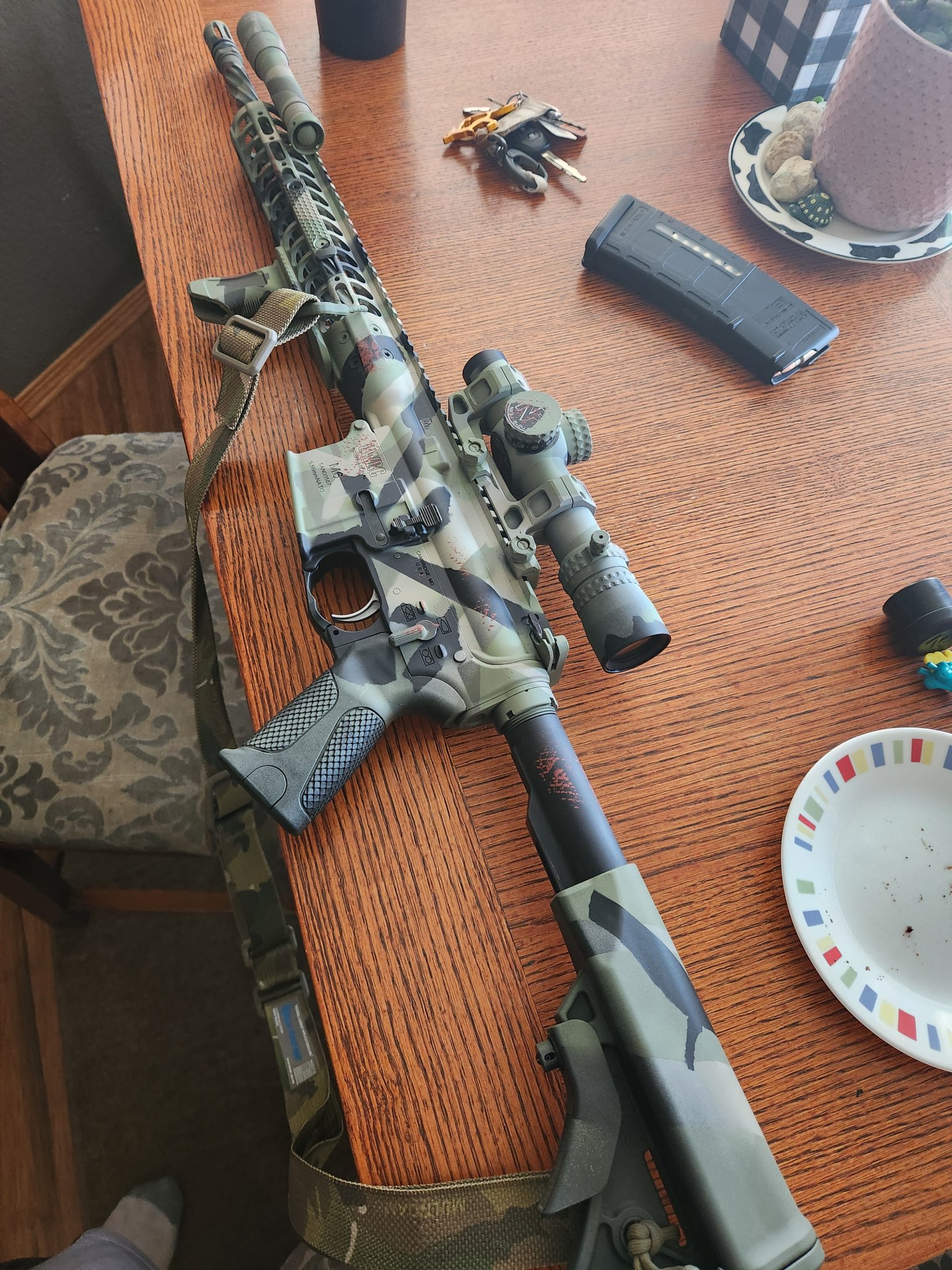

question about the ARCA rail. I have an LWRC repr mkii. i think they use the same screws. I cant get the supplied screws to go fully into the hole in the 4" arca plate, in the single hole. I can force them in the slot, but not the hole. What screws have you found that fits....did you buy online and if so can you send a link? Thanks in advance
The accessory attachment holes for the LWRC rail a smaller diameter than what Area 419 supplies and smaller than MLOK spec hardware. I was able to fine a couple machine screws in my junk drawer from previous projects that were the right length and thread pitch to accomplish what I needed.
I know MLOK hardware can be used in the slotted parts of the rail but you've got to finesse it. I wasn't happy or confident in the fit that MLOK has in the proprietary LWRC slots so I don't use that. My buddy uses MLOK hardware on his without any issues but he isn't run n gunnin with that setup either.

Wanted to follow up here for anyone in the future. so sboone was correct II needed 8-32x1/2" screws. HOWEVER, you need to make sure you get ones that have a head size that will fit in the ARCA rail. From this diagram AREA 419 size hole diagram the heads of the screws must be .32 or less and the post .20 or less. these were the only ones I found on Amazon screws. the heads are .3 and I just tried and they fit! Anyway, I have 60 and need 3 so if anyone needs feel free to hit me up!
Thanks for your help
