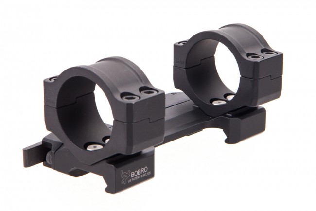

I got an email from Ranier Arms and clicking around I saw this interesting product:
https://www.rainierarms.com/bobro-compact-dual-lever-precision-optic-mount-30mm-low-pre-order/
bobro-compact-dual-lever-precision-optic-mount-30mm-low-pre-order-b77-950-300-by-bobro-284.jpg
It looks like it's only a hair higher than low rings but it has a return to zero QD feature.
It seems ideal for a bolt action with a one piece sloped rail.

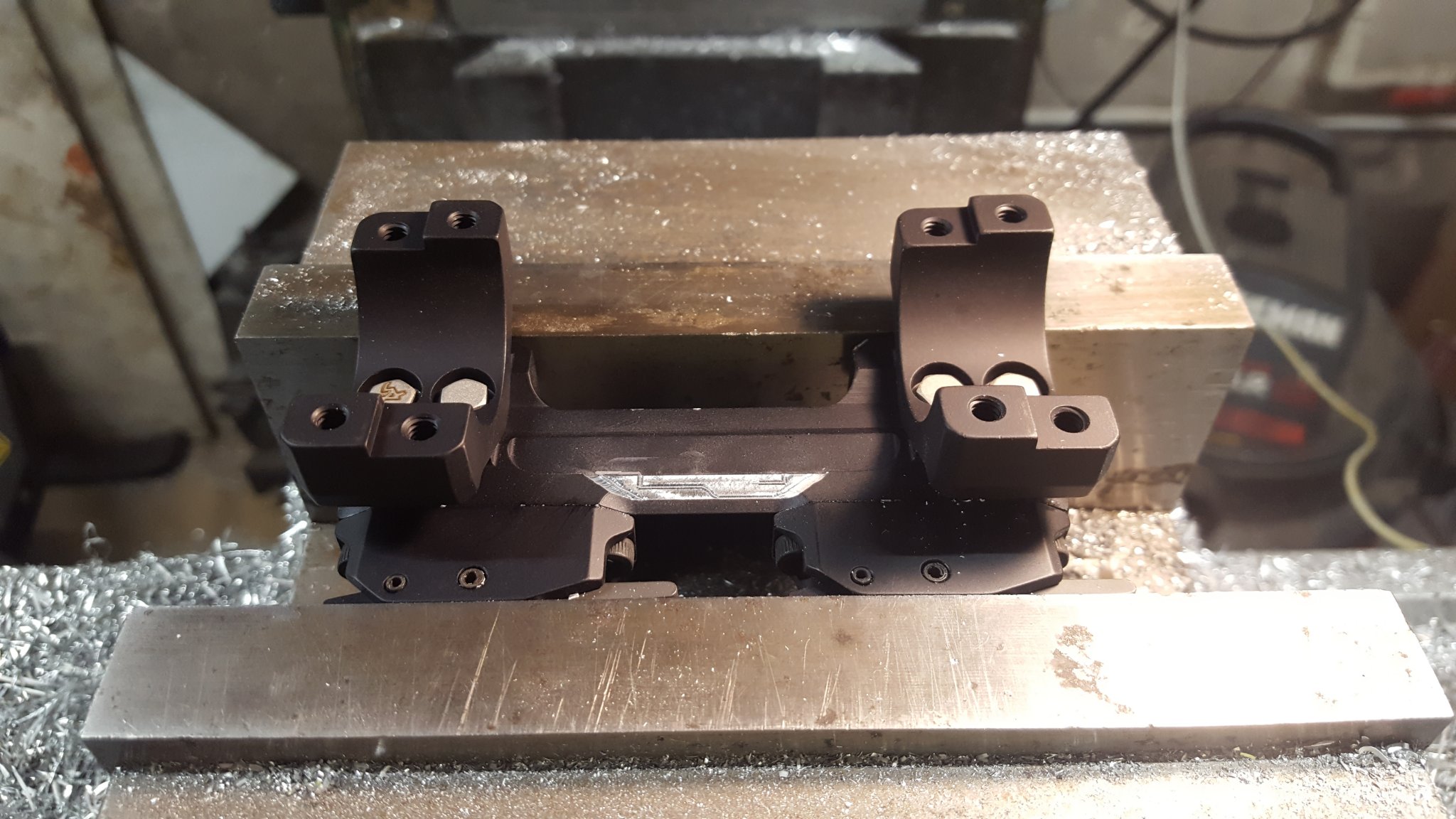

According to an email from Bobro, the height over the rail is 0.947".

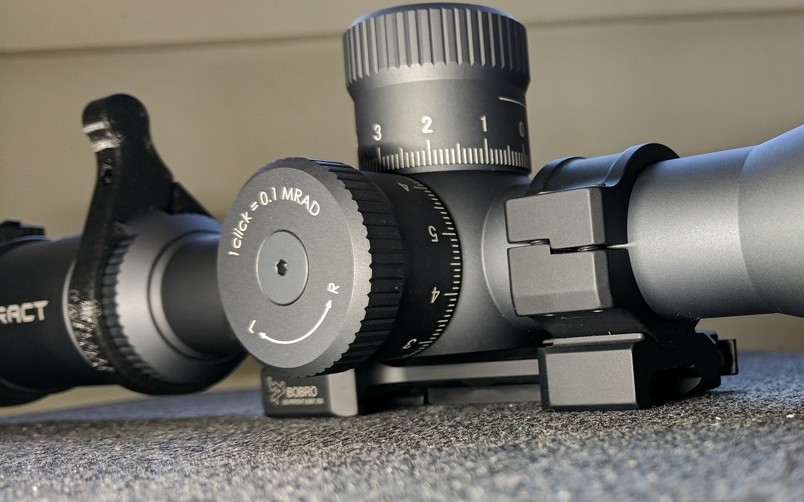

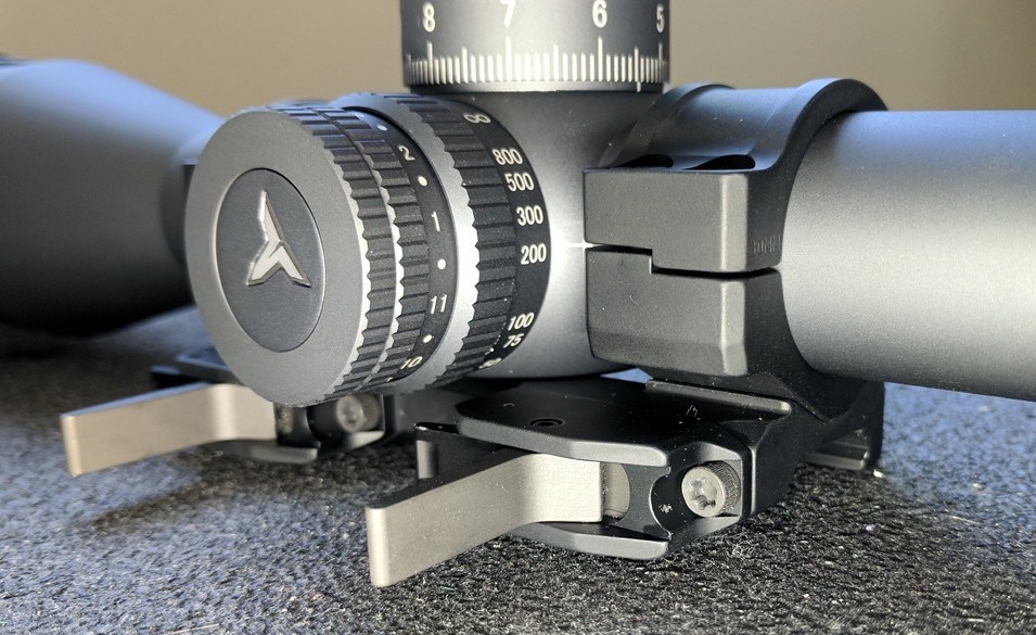

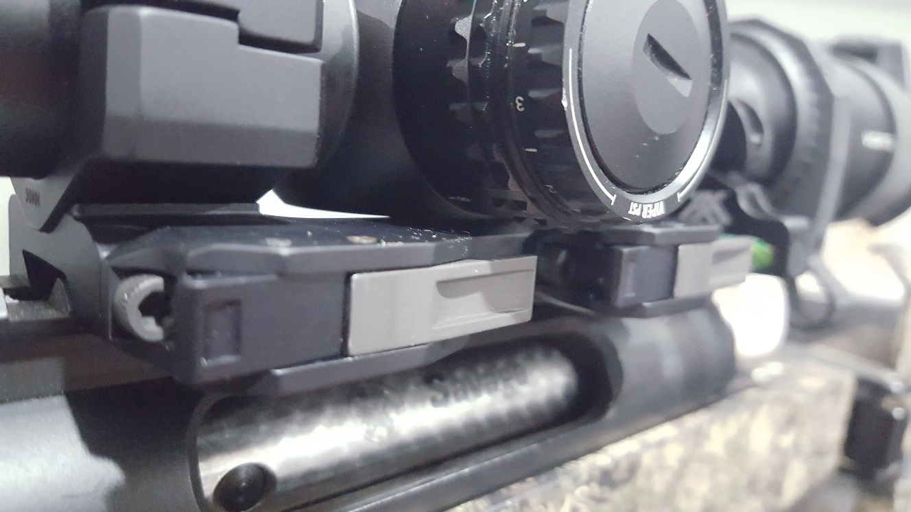

I installed my Tract Toric 30mm scope last night and it seems to fit but I think the bottom of the turret bell is touching the middle of the mount or keeping the scope from rotating to vertical in the mount.
It's close enough to vertical that I can't tell if it's a problem yet.
If it was 0.974" instead of 0.947" height, there would be no problem. On the other hand, the Toric 30mm turret bell doesn't hang too far under the tube so I think this might be a common issue.
For my scope it would have been nicer if the whole mount was 2-3 rail slots wider, the levers kind of crowd my side focus knob.
Best case: my scope will level and it will work fine.

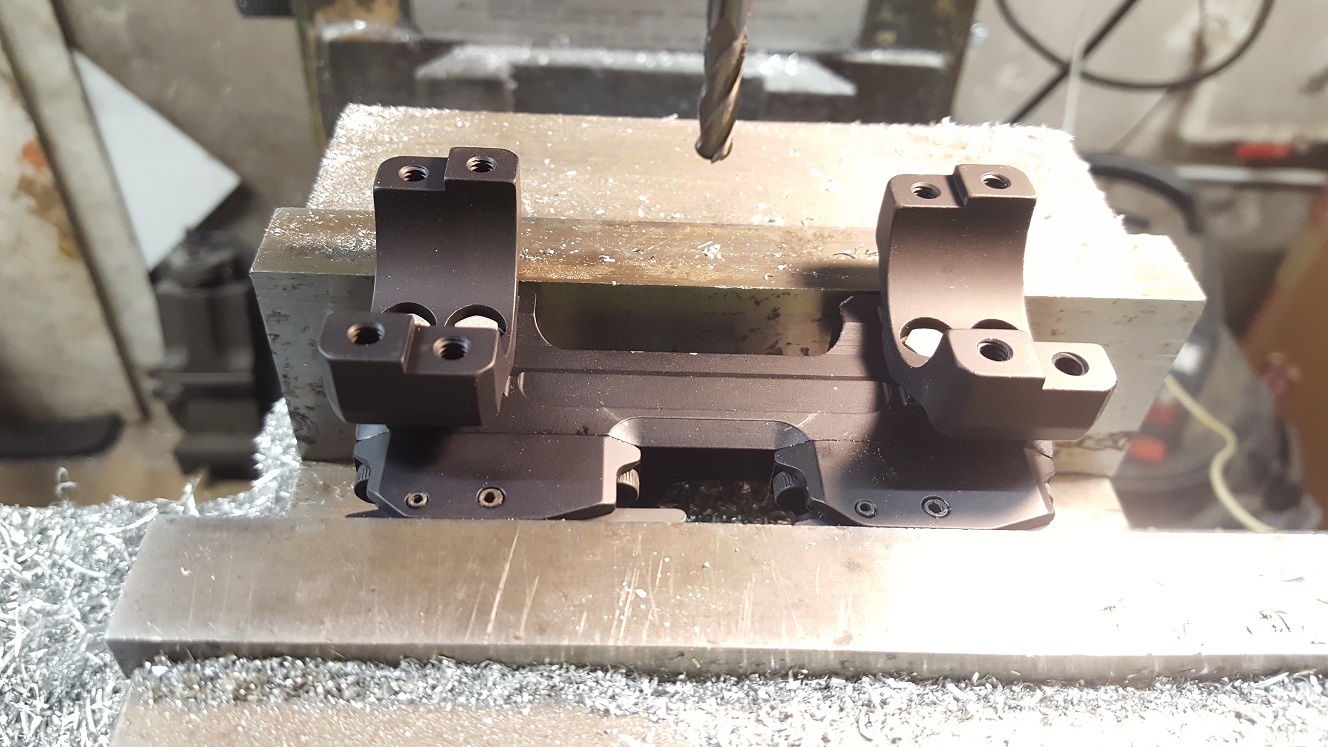

Worst case: I'll have to clamp it in a milling machine and take a shallow cut between the rings to get clearance.
That would almost be a sin on a mount machined this nice.
I think I'm going to ask Bobro about the turret bell clearance and measure my scope.

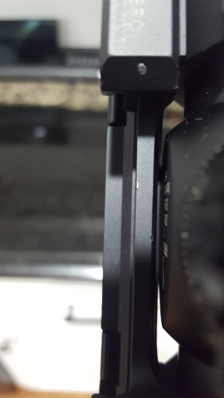

I measured my scope, the turret bell flat is about 0.125" below the bottom of the scope tube.
Here are a couple pictures of the clearance issues:
That is why MPA makes several mounts with different heights. All of them will work with a 56 mm objective, but the small difference in heights will let you clear the bottom of the mount, while at the same time, you keep your scope as low as possible.
Reactions: Glassaholic
You definitely need the scope to sit flush/flat in the rings. If the bottom of the turret housing is touching the middle/base of the one-piece mount, it's a no-go. You won't be able to tighten the rings down properly and it will place undo stress on the scope tube.

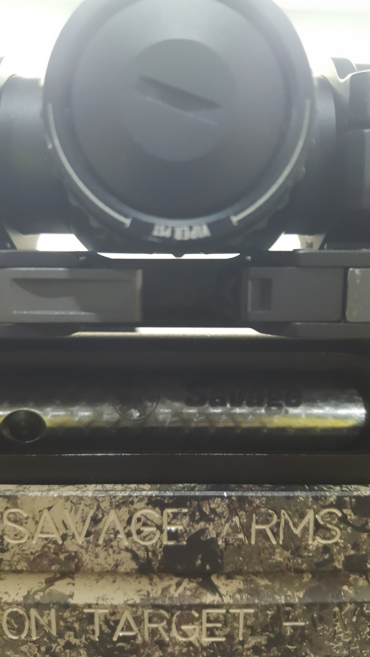

I have the 30mm version and can say a 5-25 pst will not fit because of the turret body. I made mine fit with very little work so it can be done.
