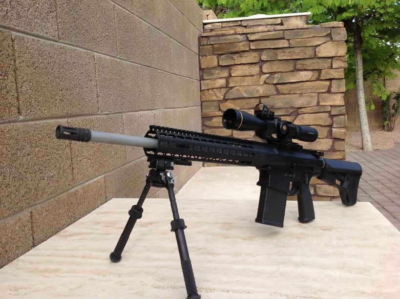

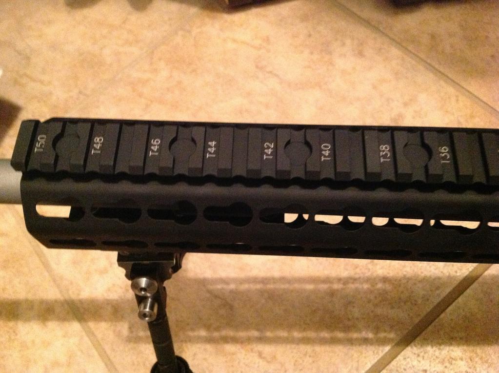

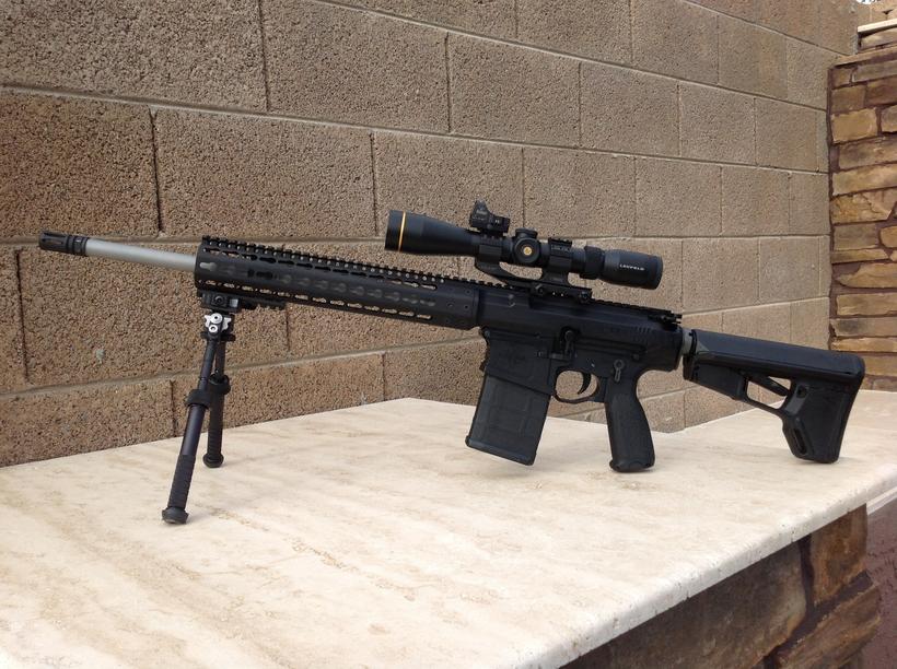

Here is mine
Coonhound and GSD approved
Blue Gascogne approved
i want to know when some one will make a decent bcg available that isn't armalite or dpms.
BTW, what break is that up there on the 16"? and how is it?
WHOA...........................that is a 16" in the 14" extended riffle length mkm?
it is even more beautiful than i had imagined.
Yep that is a 16" barrel with the 14" MKM.
Nukes - Yeah all the keymod accessories are supposed to work.
Kenndapp - The brake is a Precision Armament M11.
6.81star - I'll measure in a few days but I'm guessing right around 1-7/8" or so. It's a little think but feels good as the whole rifle is a bit on the heavy side. It's stupid solid though and feels good.
The rifle will makes it's maiden voyage tomorrow to a hog hunt so hopefully it works haha.

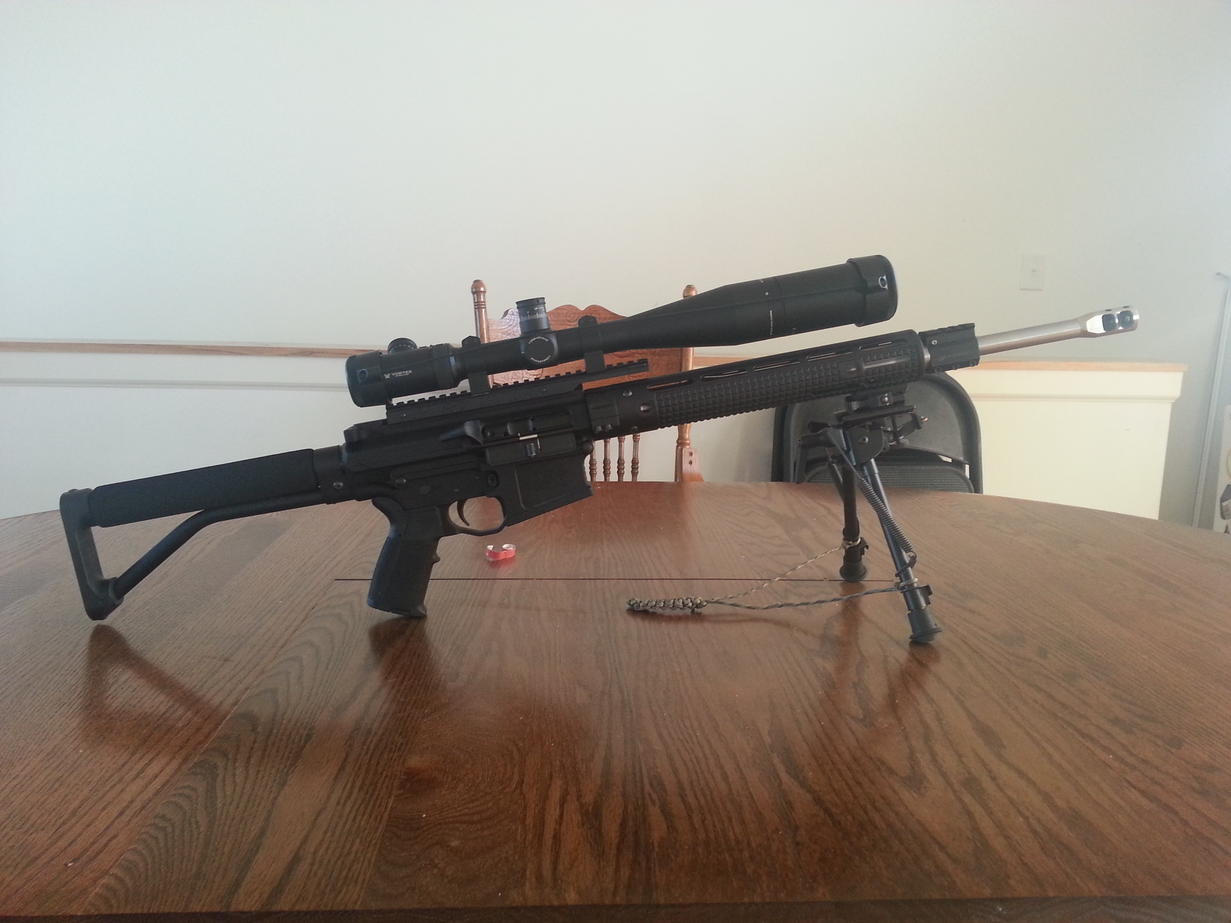

First post but have been a lurker for a few years. I just finished my build and thought I would share my experiences.
Receivers: Mega Arms MA Ten mkm with rifle length rail.
Barrel: DPMS Rainier Arms UM 18" with an A2 comp.
Gas block: SLR DA7 adjustable
.308 BCG: Red X Arms for DPMS
Trigger: Geissele hi-speed match
Grip: Bravo gunfighter
Selector: Bad ambi
Magazine: Seekins billet button on Norton ambi release with Magpul mag
Stock: Acs-l on a spikes buffer tube with dpms .308 carbine buffer & spring
Accessories: Atlas bipod, Burris P.E.P.R. With Fast Fire red dot & Leupold VX-R (illumination)
Pros: mkm ambi receivers has most of the parts installed that I returned my DPMS LPK and went with the ambi aftermarket parts and a little bling (Seekins mag button). Everything was so easy to install. The Geissele hi- speed match trigger works great with the bad ambi selector and did not require any filing of the selector as was mentioned in the instructions. Ordering the trigger from RA also comes with the other springs at the same time.
Observations: Information you should consider if going with the Mega Arms MKM version is the non-mil spec picatinney rail on top and the keymod one mounted at the bottom. Some Mil-spec tight tolerance precision mounts will fit loose on this platform. The side of the rail has small flutes (?) in between the rail lugs and there are holes ( haven't figured out what for) that are spread out in between every 4th lug. For those who have other AR's or picatinney rail adapters then it will not be a big deal as you can use those mounts on your other rifles. For me I couldn't use my very expensive Talley tactical crossbones scope mounts. Those scope mounts have been moved to my bolt rifles. My Atlas bipod QD fits loose but since the bottom rail is a keymod then I will be looking for aftermarket picatinnny rail from another manufacturer to replace it.
I also bought a Blackhawk! Picatinney rail adaptor for sling studs and though I am not a fan of Blackhawk! Products they really knocked this one out of the park and they are cheap. I have these mounted on all my hunting rifles. It installs in seconds, has a sling stud so I can still use my sling, and I can reuse my Atlas Bipod QD on all of them at the range.
Edit: I must say that lonewolfusmc video's were awesome when it came time to start the build. It made the setting very enjoyable and I didn't feel like I was watching your standard mono tone instruction video. Big thanks to that dude and his time spent on putting some quality videos (MCM).
Cheers
