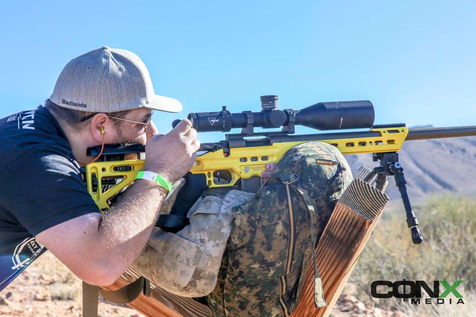

Been using mine for a few months of PRS on a JP 6.5 Creed. Rifle usually has a couple shooters running it on match day. Last month for example we had 147 ELD-M handloads, 140 ELD-M factory and 147 factory loads. All the different ammo was spot on dialing all day back and forth, practicing during the weeks etc. Even Prime 130 still hits just fine, same as the last time I shot it. Obviously there's slight differences in zero between ammo but that's just a small correction in a ballistics app.
I'm not going to torture test a personal scope but for everything I have asked the Trijicon to do it has done. Obviously going in and out of barricades it gets bumped but it has never lost zero. I've run out to 1100 and back in and the scope always tracks fine for me.

Nice setup!

Just mounted and shot mine. Great scope and clarity all the way to 30x. Replacing a PST Gen 2 and it is way brighter and more clear. Turrets seemed to not have as deep clicks, but were clean.
