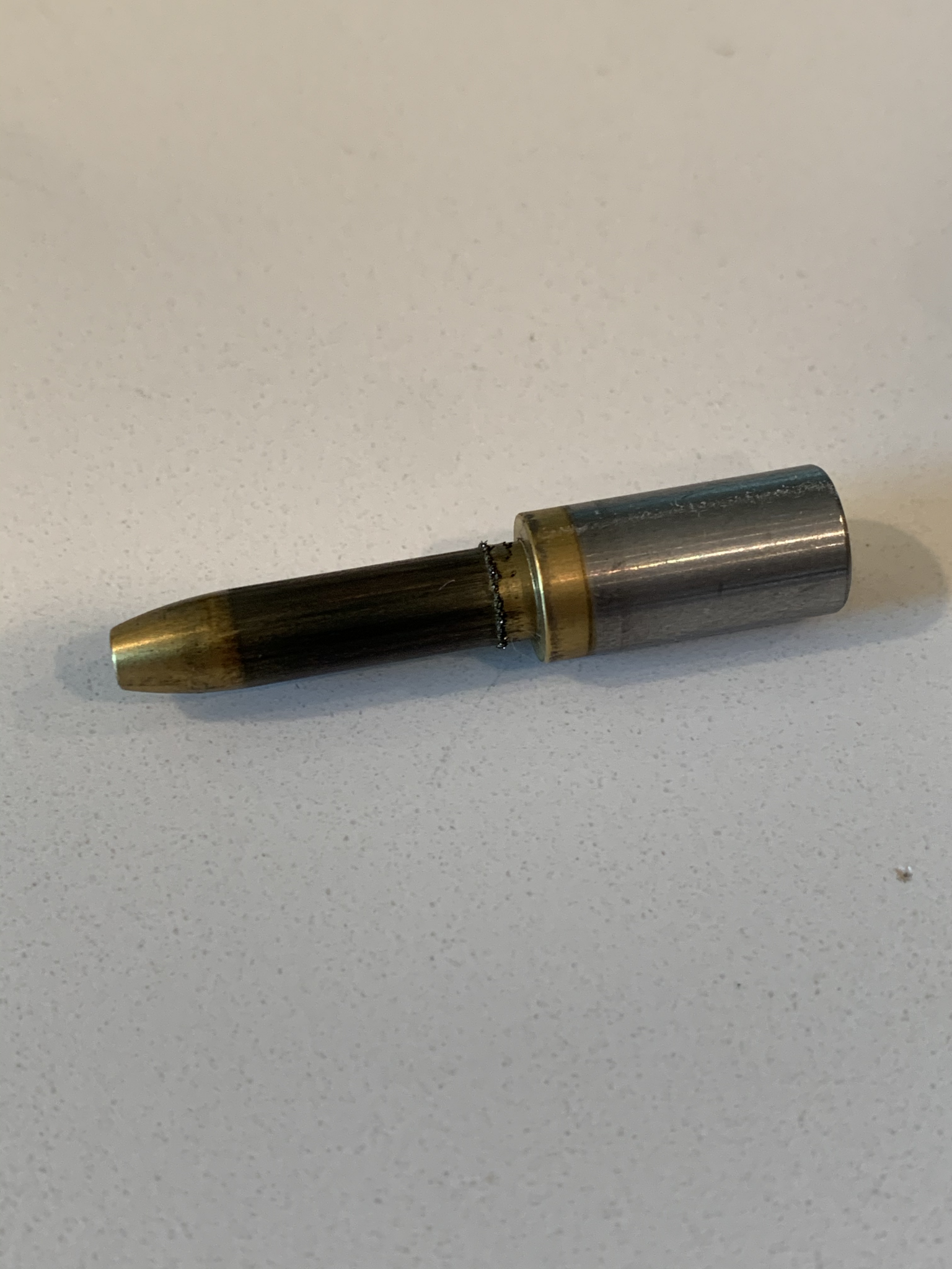

I've been using the TiN version of their turning mandrel (.002" under) for a while... this topic prompted me to take mine out and look at it for the first time and a long time.
The first pic is straight from being disassembled: more gunk than I expected, but it hasn't been cleaned or looked at in at least 1200rds.

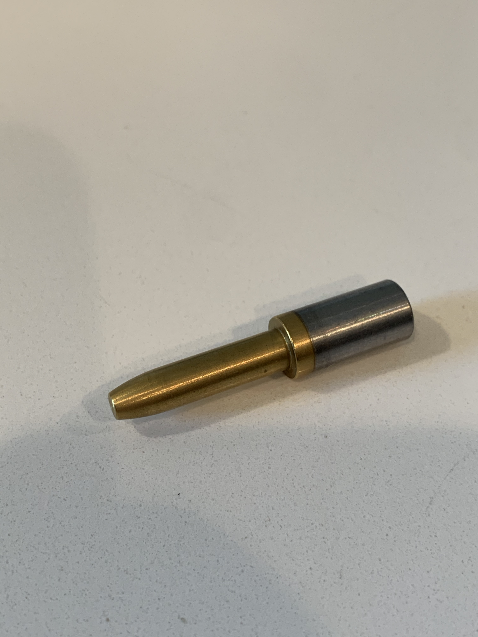

The second pic is after a quick squirt of One Shot gun cleaner/dry lube: don't see anything too alarming and it's got somewhere near 2000rds on it.
I think I'll check on it more often than every ~1200rds from now on, and if it starts to show anything concerning wear-wise, I'll get one of the carbide versions. (Think I probably ought to give the rest of my dies a quick cleaning too soon.) ;-)

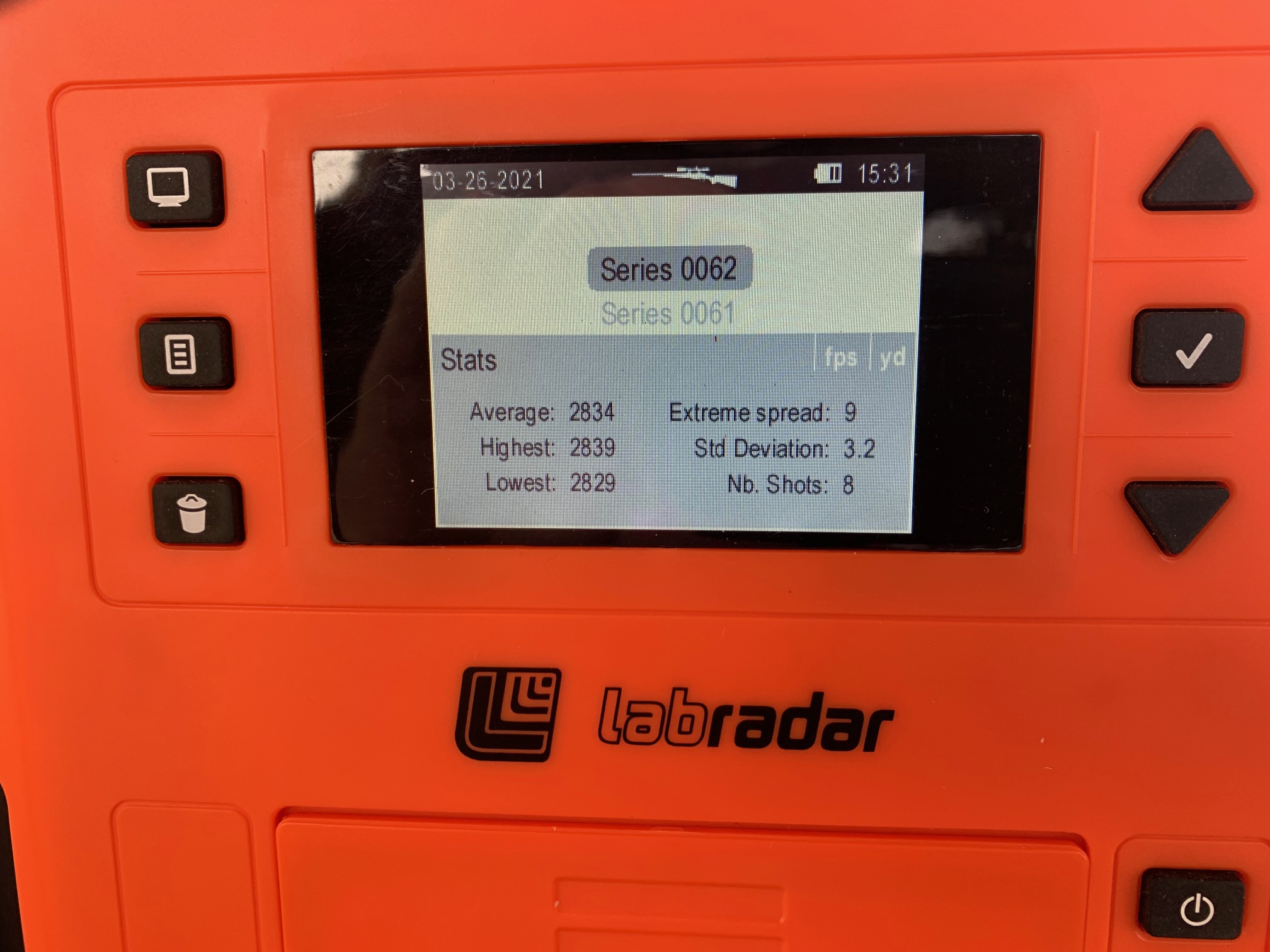

FWIW/FYI I use lanolin/alcohol spray-lube (Dillon/Frankford/Midsouth all seem about the same), I toss the clean brass in a plastic container and give 'em ~5 squirts and then swirl and tumble them around for a minute or so, then I let the alcohol evaporate for 5-10mins and get to it. Enough lube makes it in to enough of the necks and gets on the mandrel to where I never feel like I'm dragging the mandrel dry through the necks.
Since adding the mandrel to my routine, I don't think I've seen an SD number in the double digits.
