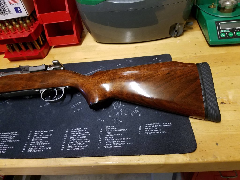

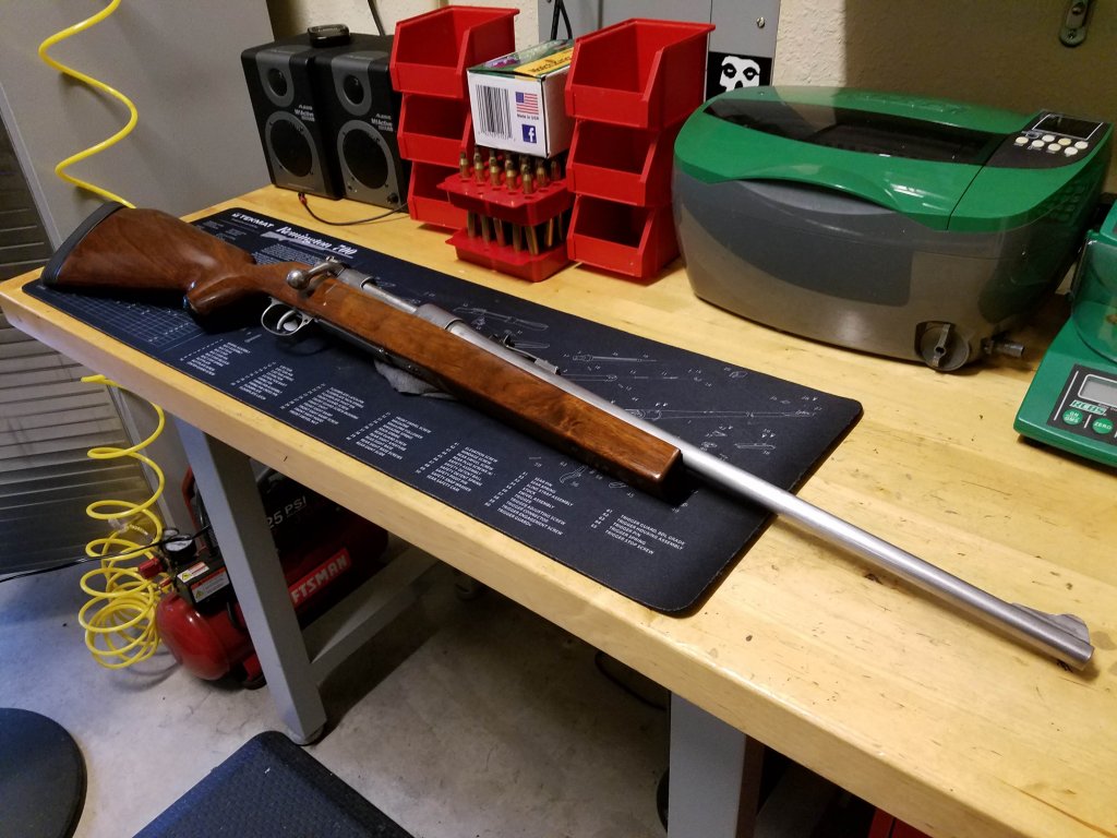

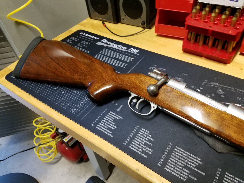

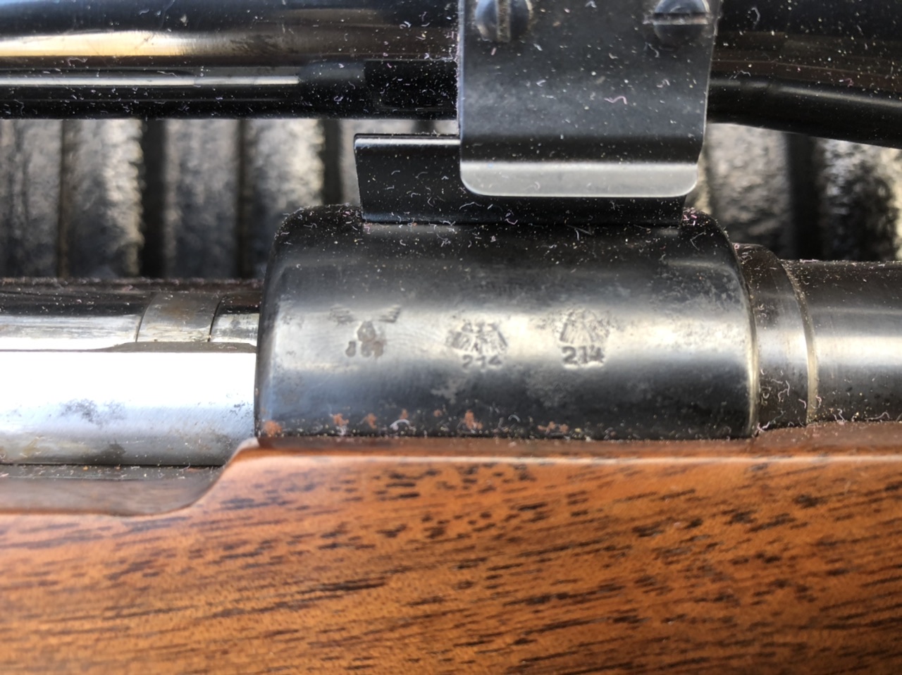

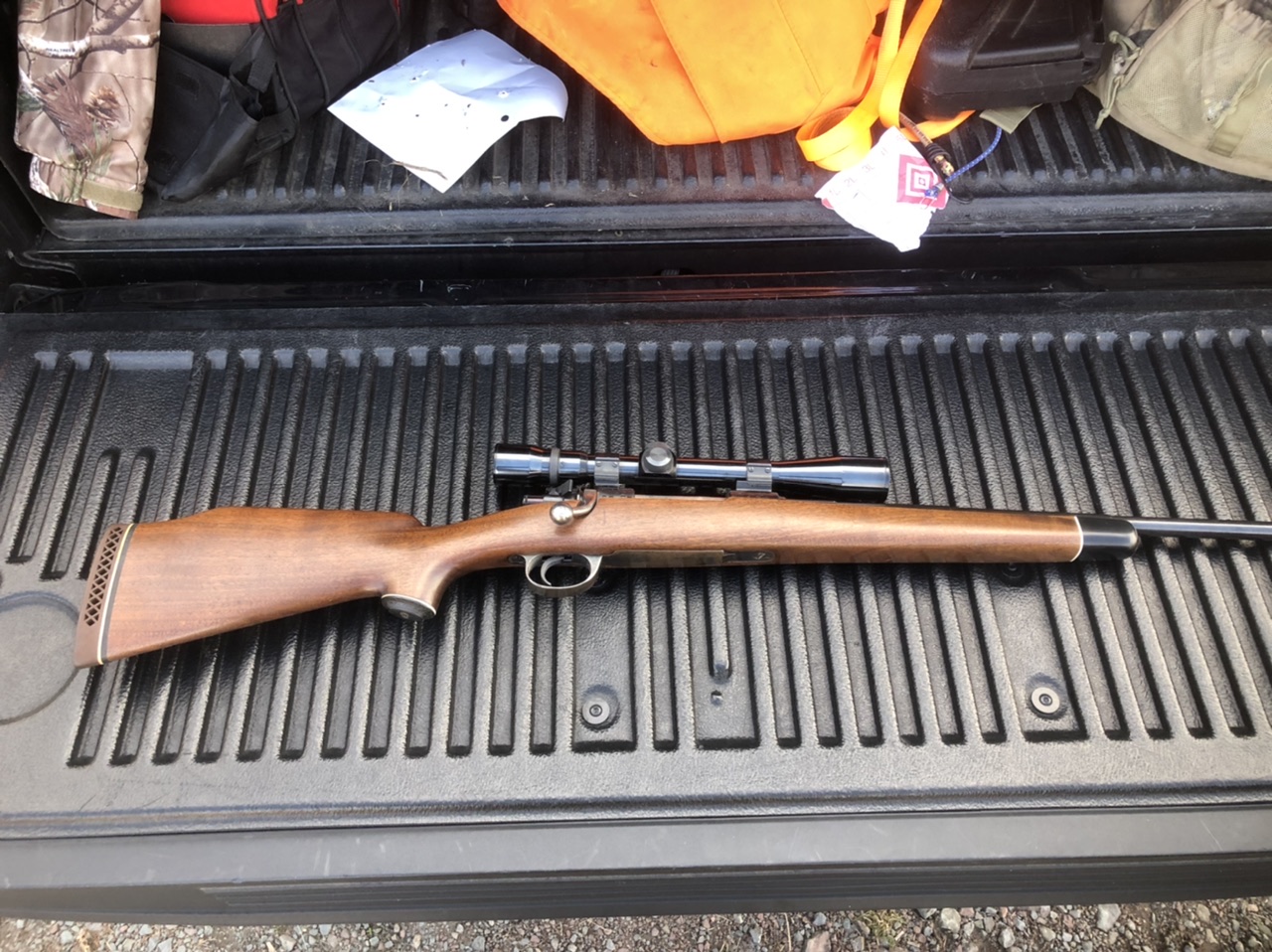

I was just given an older Mauser M98 (civilian model) in 8mm-06. It’s got a beautiful walnut stock and a thin barrel. I’d like to put a heavy sporter barrel on it. I’ve owned savages up until now and I don’t know the procedure for a Mauser barrel swap. Of anyone is experienced with older Mauser, I’d appreciate some help.
Updated: I’ve attached some photos of the rifle. There’s is a Swastica engraved on the action. I’m guessing this is a “sporterized” captured Mauser?

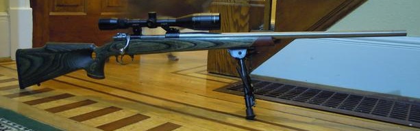

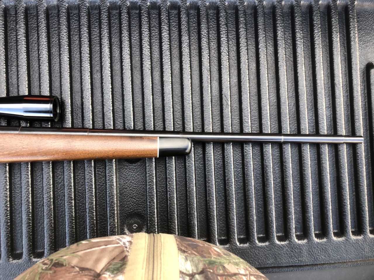

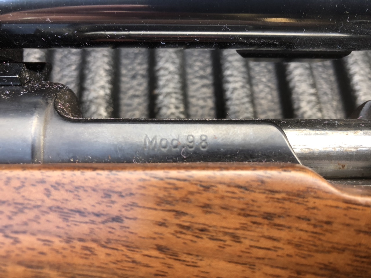

I had the same thought as the OP when I inherited my dad's M98 deer rifle. It was a sporterized version as mentioned above that included a rechambering to 30-06. After some research I reconsidered and decided it would honor my dad better to also use it as my deer rifle. I removed the scratched blueing, fixed stock cracks and dents, sanded/sealed/oiled the stock and bedded it from tang to tip. I use wax on the steel to keep rust away. I added flush cups last week as getting up/in/down from ladder tree stands one-handed is dicey for someone as clumsy as myself.
One additional note to the OP: if your bolt handle is like mine, it will not clear most (at least the few I tried) scopes. Options include, cutting/adding a different handle and heating/repositioning the current. I prefer to keep mine original.
Before the cups:

I just posted the photos.
I am pretty sure that is a converted 98 military action. In which case, barrel swap, etc is not going to hurt anything.
Neat rifle, but not a collector or something you can’t play with. Was hoping to see prewar commercial sporter. Even if that is a commercial from the get-go, post war is not extremely valuable.
However great basis for a project!
Sirhr
Reactions: Zeroit
Reciever is from an early Nazi era K98k built by Berlin-Lubecker (waffenampt WaA 214).
Date of mfg. and manufacturer code (S/237)will be stamped on reciever ring under scope base, since it still has the Weimar eagle proofs i'll hazzard a guess and say that its 1936-1937.

You could rebarrel yourself, if you're so inclined (you need a minimum of the barrel vise and action wrench)
Brownell's carries a line of short-chambered, pre-fit barrels from Shilen in quite a few popular chamberings (8mm/.06 not one of them...)
You could rent some or all of the required tooling (reamer, T-handle, gages) from 4D.
Just an option if you're the DIY type.

T-handle and gauges aren't expensive. Unless you want the reamer for later, rent it.
There was an article in American Rifleman (I think by Bryce Towsley) that talked through barreling a Mauser with a short-chambered, pre-threaded barrel. I can't locate it online (I think it's part of his gunsmithing book). But you might be able to find it in old issues. If not, folks here can help you. As previous posters have indicated, not too hard, and a pretty neat project. I wouldn't let it scare you off, but the 8mm-06 is great.
