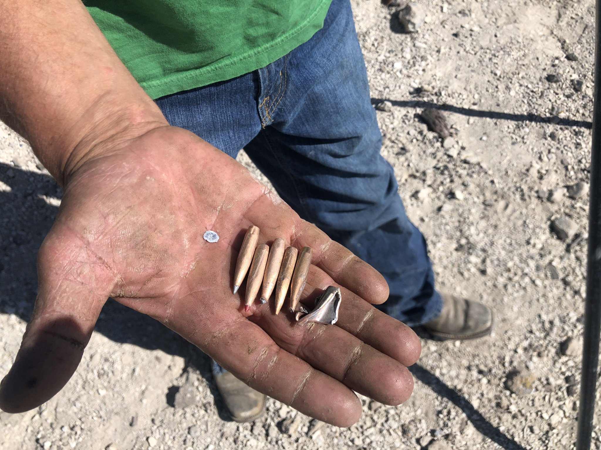

Interesting thread over on another accurate shooting site "Things one sees in a match". Several are reporting bullet disintegration at normal speeds (2,800 fps) with standard 1/8 twist barrels.
Video: http://img.gg/m9TAt9y
The rifle here is reportedly a standard 1/8 twist gun, shooting 6.5CM Hornady factory ammo.

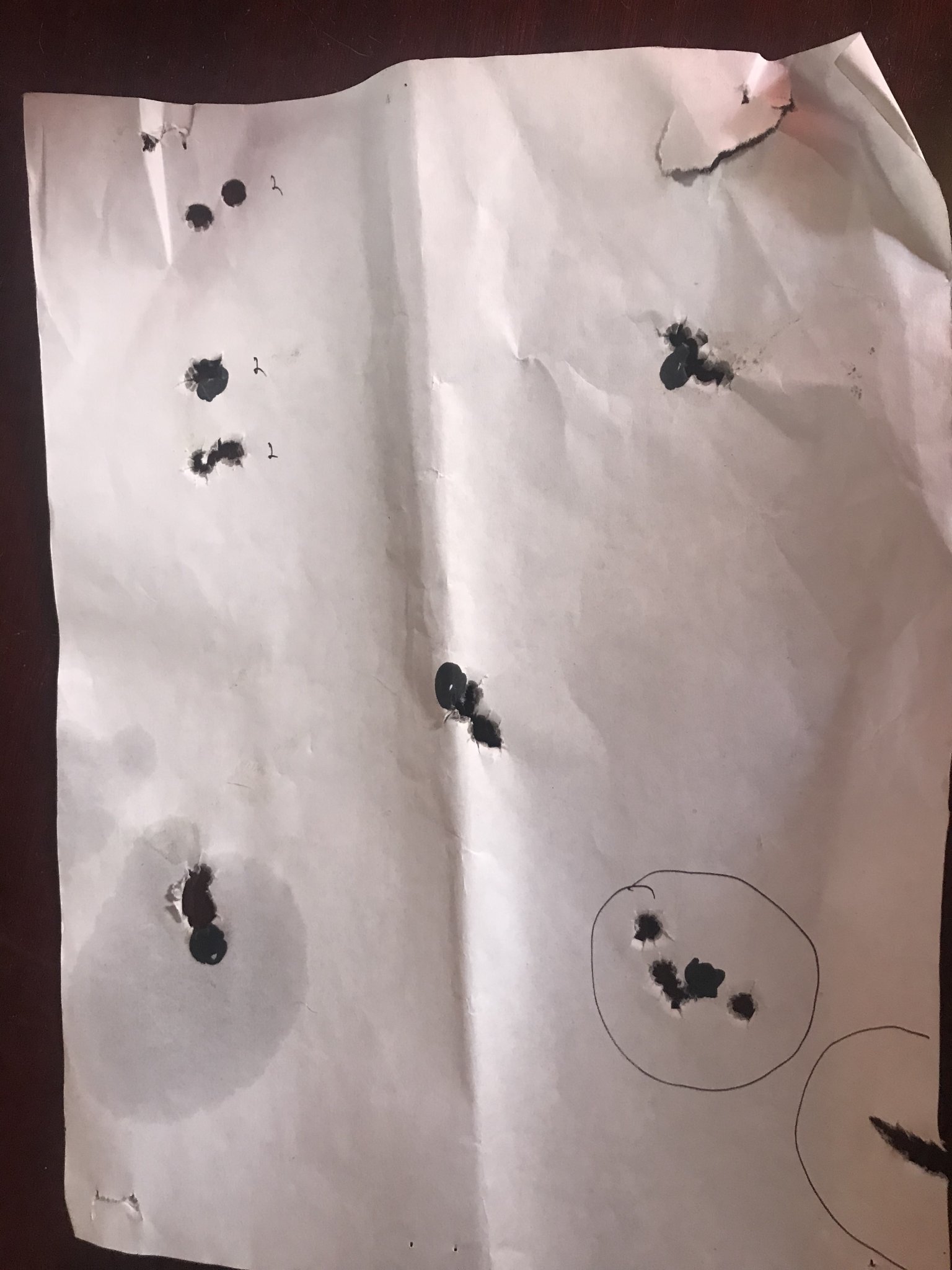

I tried several boxes of these from 1/8 twists and never could get them to shoot well. Recently tried finding a load for my buddies rifle, and out of nowhere had two of the shots impact the target sideways. Gave up on them after that

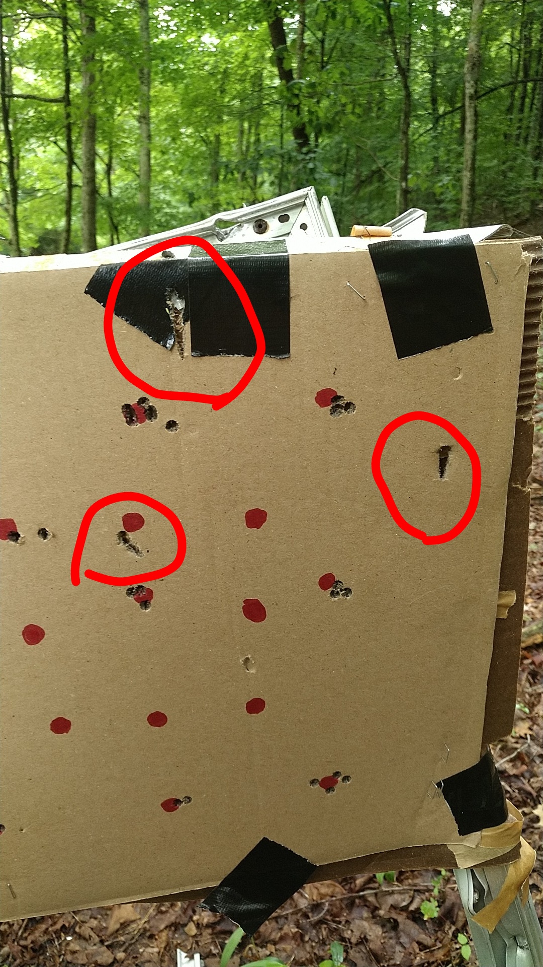

This started happening at around 200rds and I know several other people that have had the same problem. This was at 100yds and some of them blew up. Hornady said they changed jackets this year at some point.
I’ll try take a pic tonight.

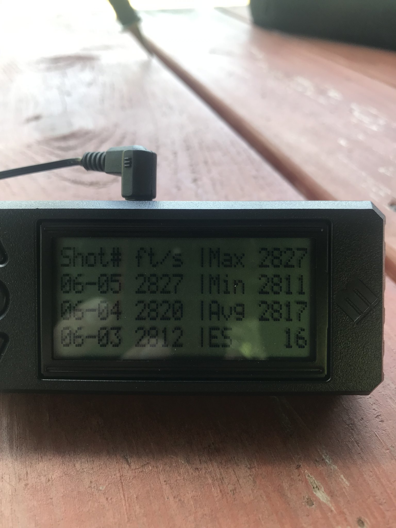

I had issues w a current box of 250 over the weekend in a Bartlein 5R barrel. I had 50 from last years lot w no issues. New lot lost at least 30 out of 100. I had my son shooting while i watched the trace. The ones w no trace also had no dirt signature. At one point i had 4 sets of eyes watching and we all agreed that they weren't making it downrange. Even tested it back at 100. One shot POA next was 1 foot off target. Also the 19 lot shot about 2 feet higher at 800 yards.
