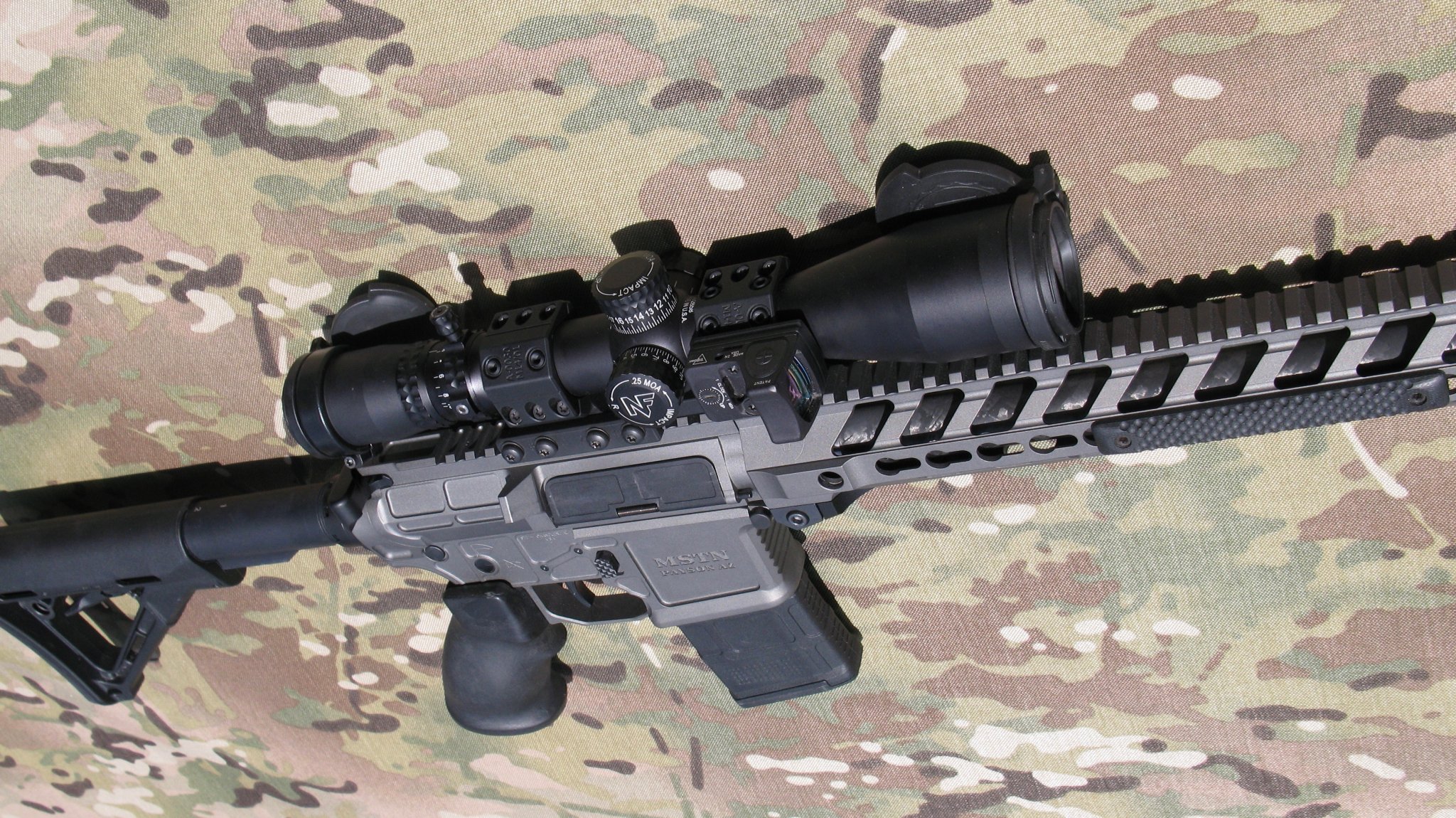

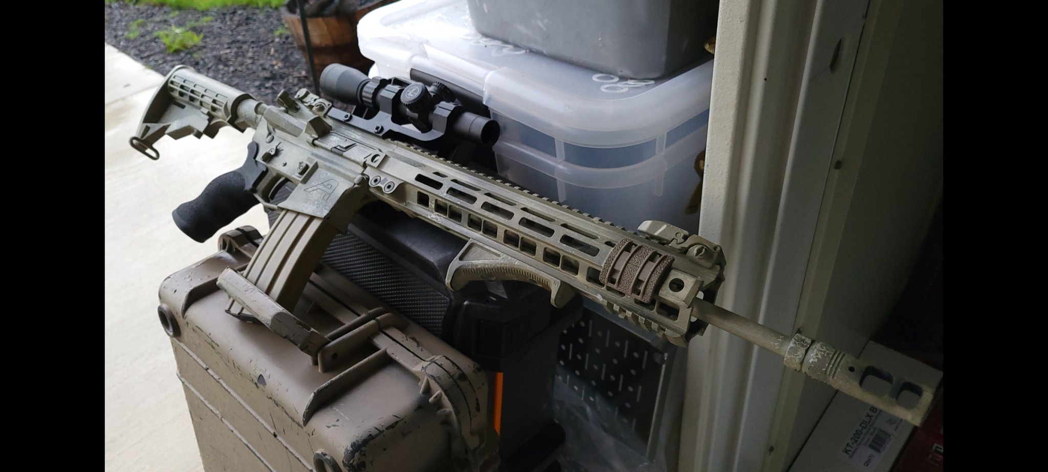

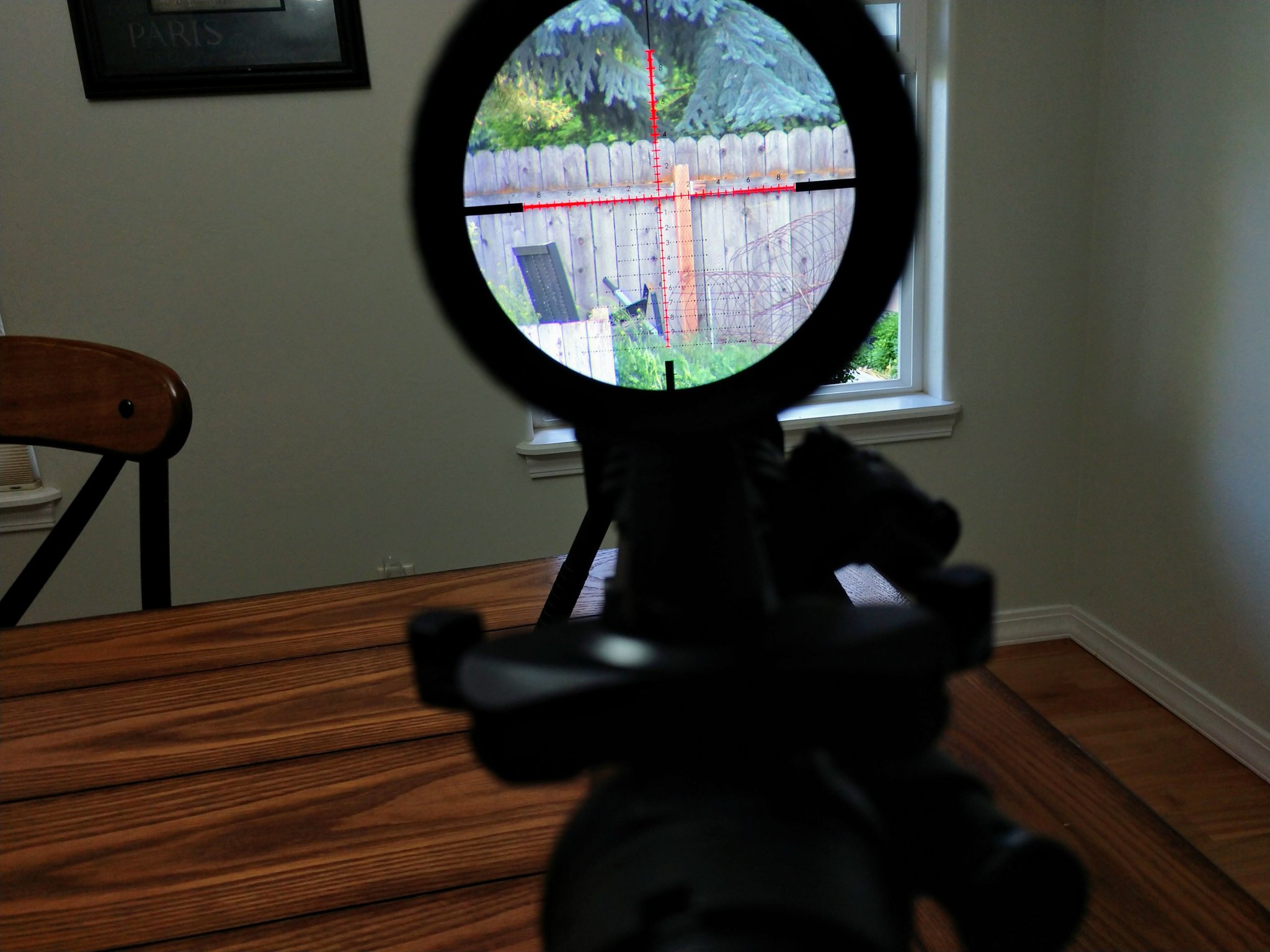

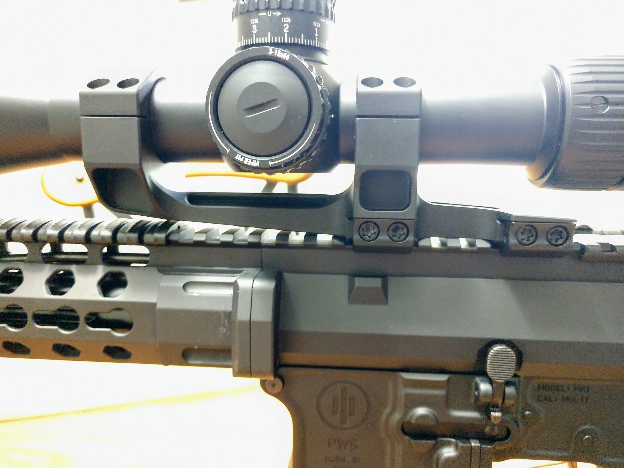

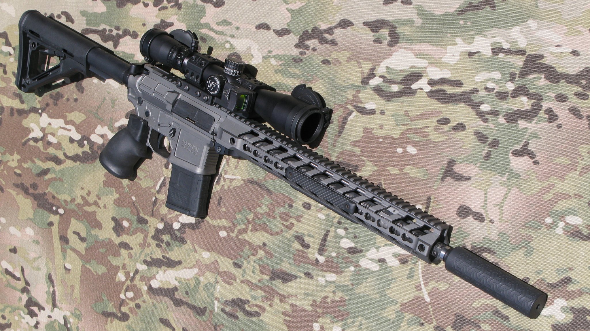

Here is an update on my recce rifle I got the Vortex PST Gen 2 3-15x44 FFP in today. it's a little longer and a little bit heavier than I would have liked but it's actually a very nice piece of glass I was pleasantly surprised for the price range. my neighbors fence is exactly 109 yards away and I can see the nails in his fence clearly at that distance at 15X, so it'll be more than adequate for shooting groups and taking it out to extended ranges. I'm going to have to send the vortex precision mount back, it's just too far extended to run my 45° BUIS, and make up for my 14.5" length of pull. My Luth MBA-3 stock will be in tomorrow.
The cell phone pics don't do it any justice it looks like it's has bad CA but it doesn't.
The extended cantilever mount has a good 3" extension which is a bit too much. Even with the scope set all the way back in the rings I'm still rubbernecking it to get proper eye relief, on top of that it makes reading my parallax adjustments impossible.
But I can't say enough about how pleased I am with the clarity and the quality of the Gen 2 PS2 3-15x44.
Thank you Vortex, Thank you for supporting your First responders, Active Duty Military and Veterans.

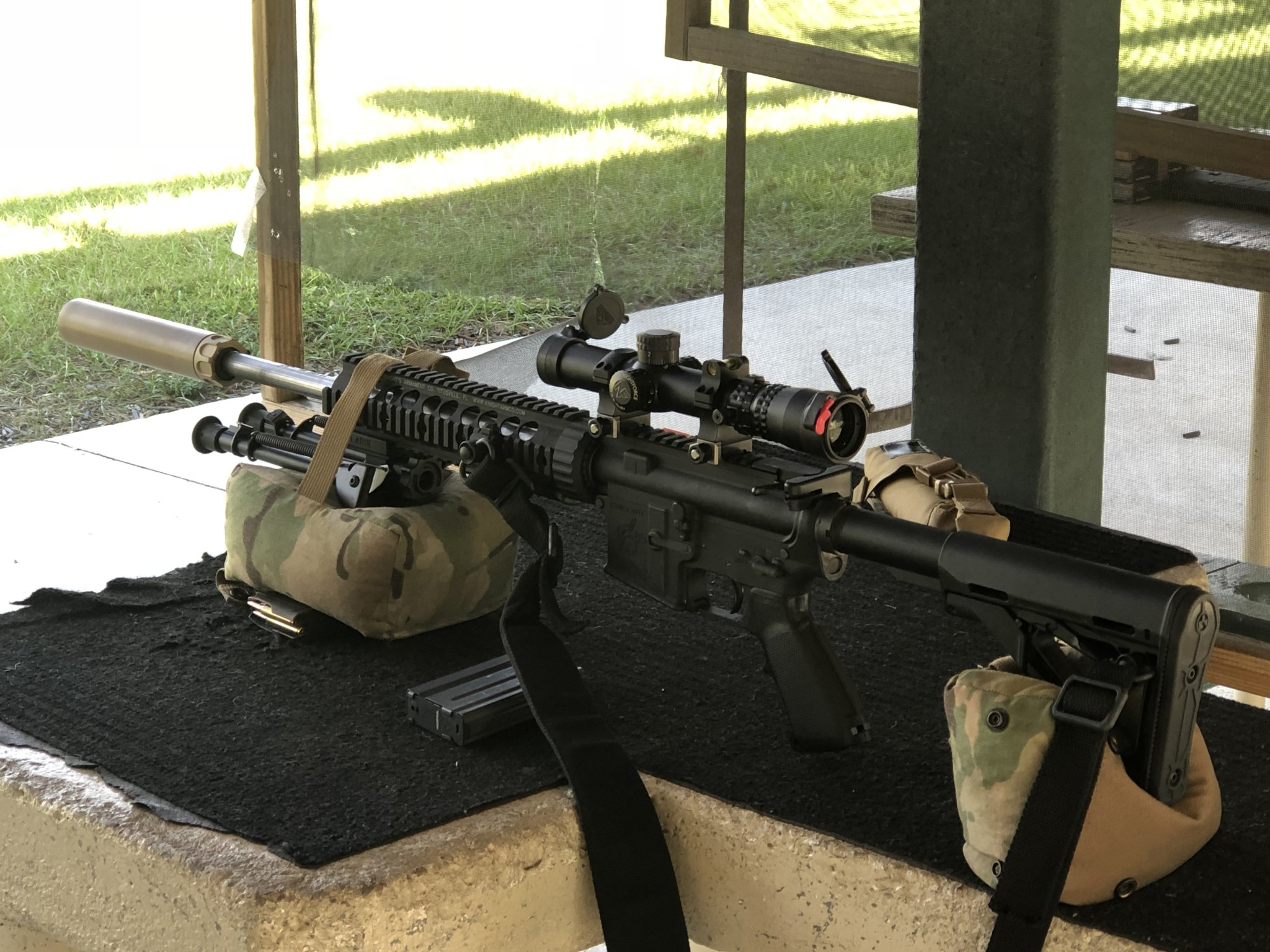

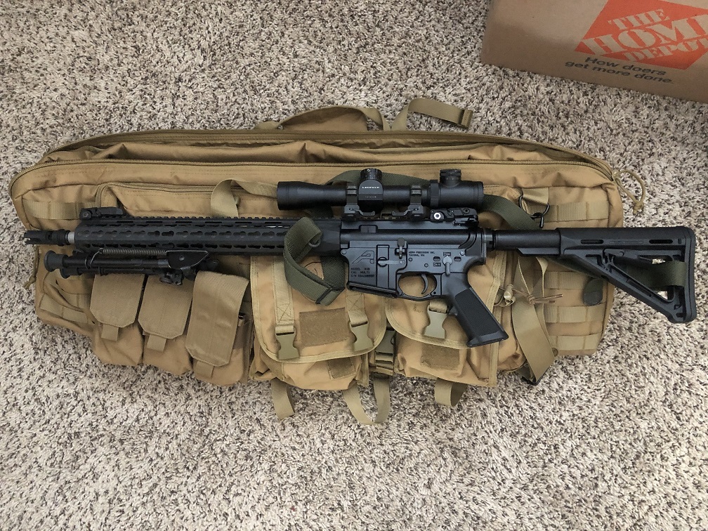

I have an 11.5” SR-15 with an Elcan 1/4x. Only AR I have.
Same. I run a Spectre 1,4x on my 10.5 Noveske. IMO, and as a general rule, running a true LPVO on anything less than 14.5 inches is a bit of a waste. Can you hit targets at 500m+ with a short barrled AR? Sure can if you are good enough. Is it the right tool for that job? Nope.

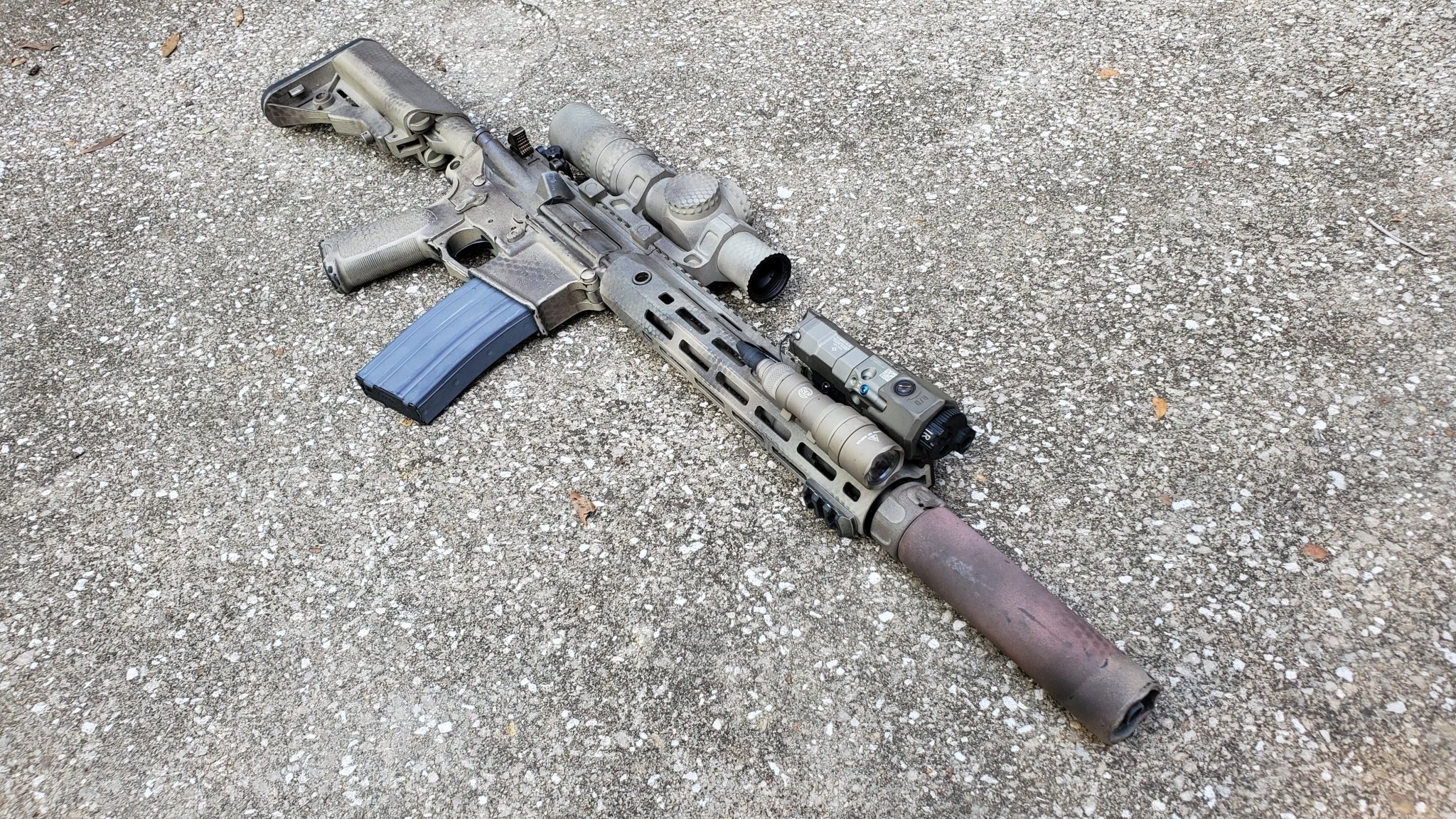

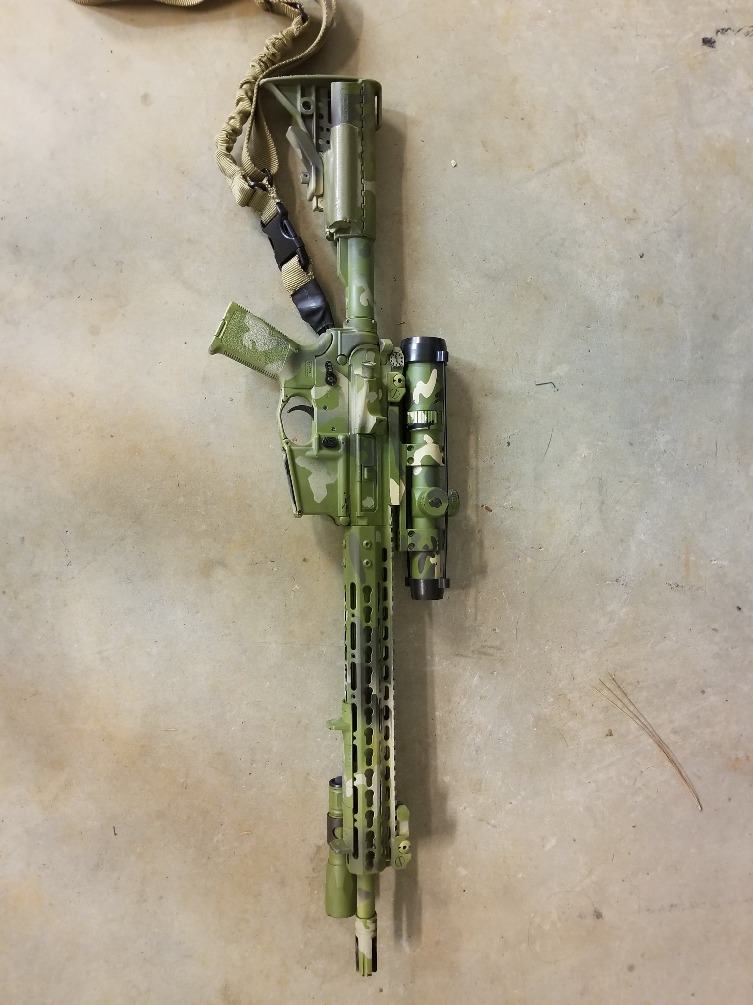

Um, I guess I accidentally kind of made one of my AR's into a "lightweight" "Recce" even before I ever heard of a "Recce" rifle.
Aero Precision M4E1 Upper/Lower, Geissele MK4 13" MLOK handguard, Faxon 16" 1:8 5.56Nato pencil profile barrel, Surefire brake, Velocity 3# match trigger. Leupold Mark AR Mod 1 1.5-4x with SPR FireDot reticle.
Don't mind the stupid grip fin thing. Here in California, that makes the rifle not scary anymore. I'm a lefty anyway, so it doesn't effect my handling of the rifle anyway.

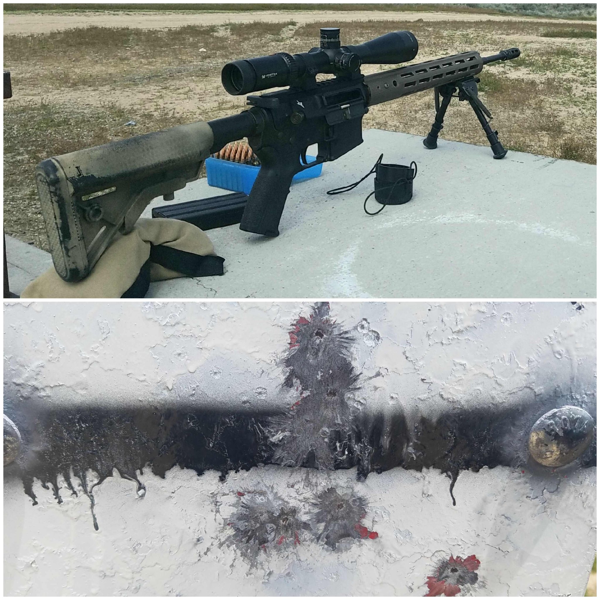

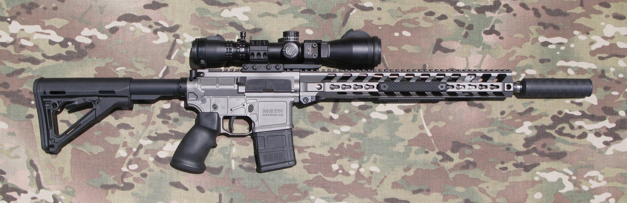

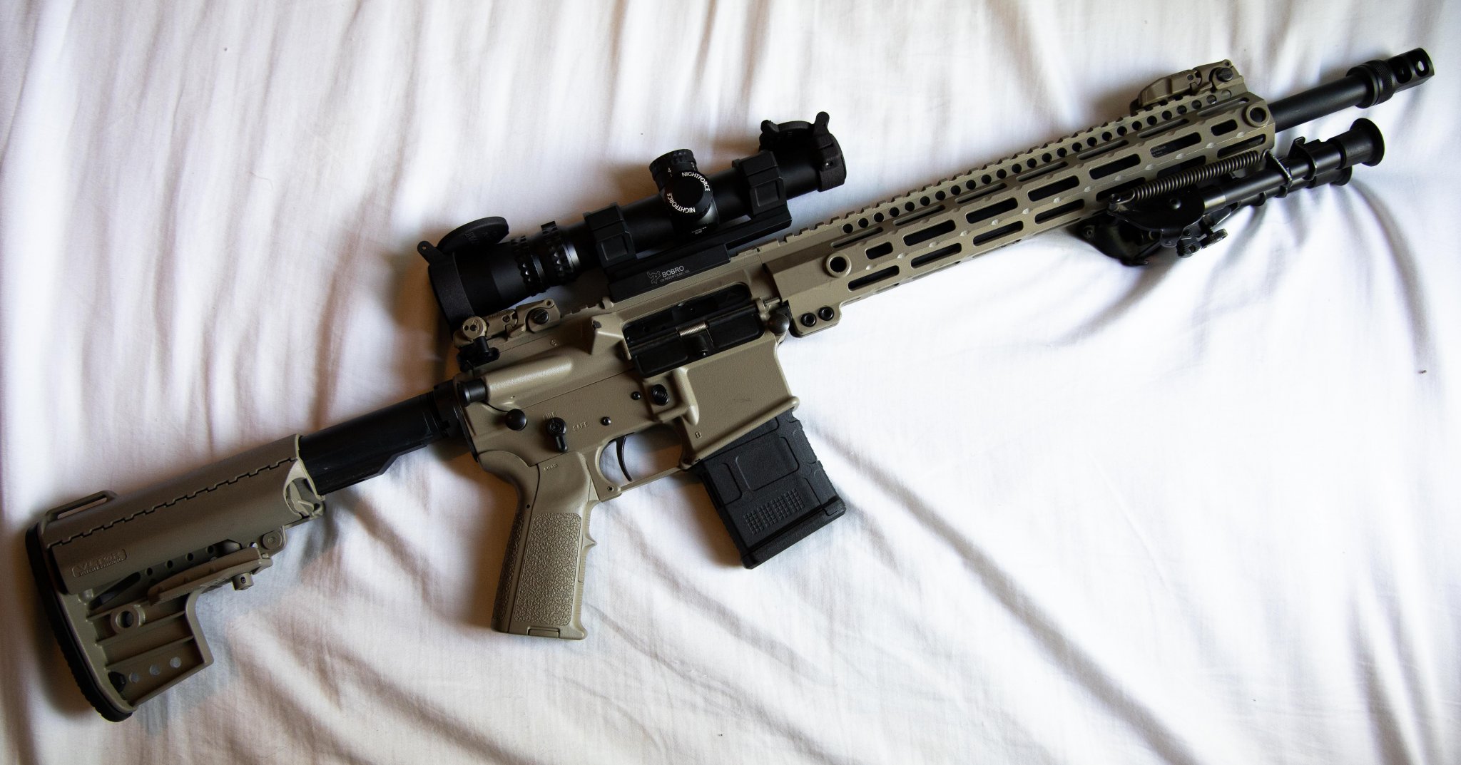

This is my 16" Recce. It was my attempt at a precision AR because I think every American should own one even if I don't personally like the CQ red dot ninja stuff. I have done drills at 2.5x anyways because always be prepared... I really need a sling and then I plan on switching the Timney trigger to a Geissele unit if I ever have spending cash again. It really needs a diet overall.
The Rainer Ultramatch barrel is unfluted and honestly too heavy. Very consistent, but I could of went lighter knowing what I know now. Weighs in at 10.2 lbs with 20 rounds loaded. It will take any flicker tail (way smaller than a prairie dog) with in 200 yards easily. I have run it out to 400 yards on a 6" target with some consistency.
i know traditional recce guns have match grade stainless barrels but my knights armament barrel shoots 1" groups, sometimes sub 1" groups using handloads. 2" groups or less using factory 77gr stuff.
atlas bipod not pictured, was doing some night shooting and took it off because it kept getting caught on one of my ripped gloves.

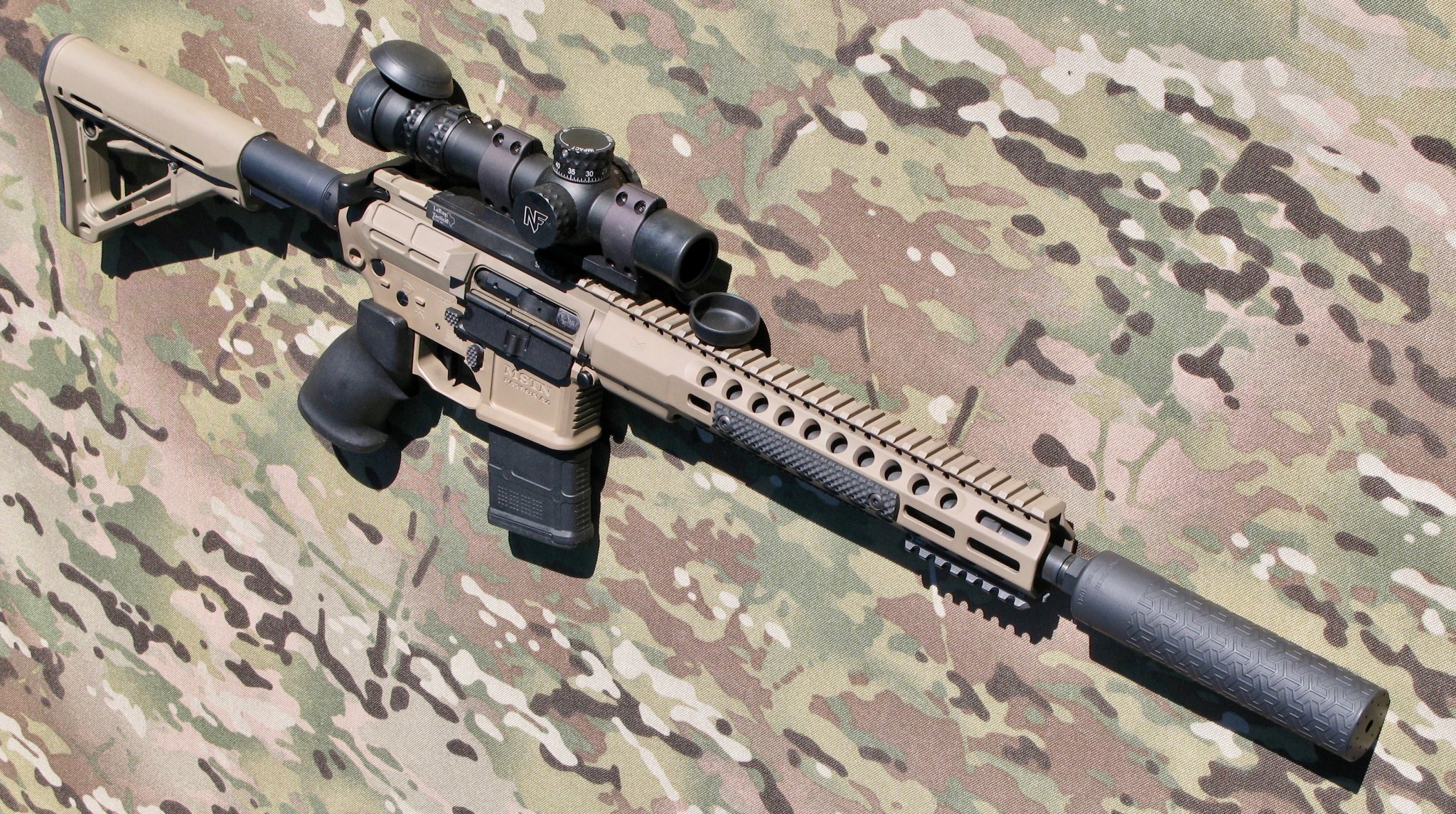

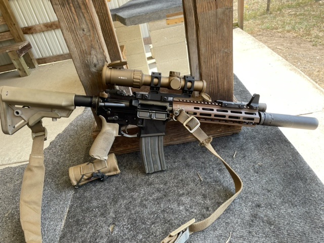

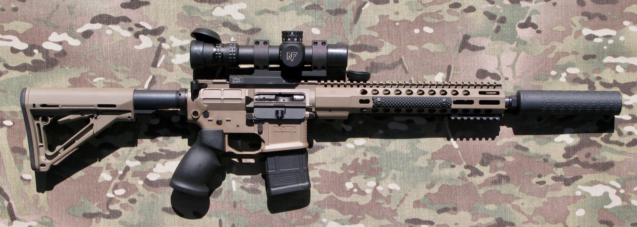

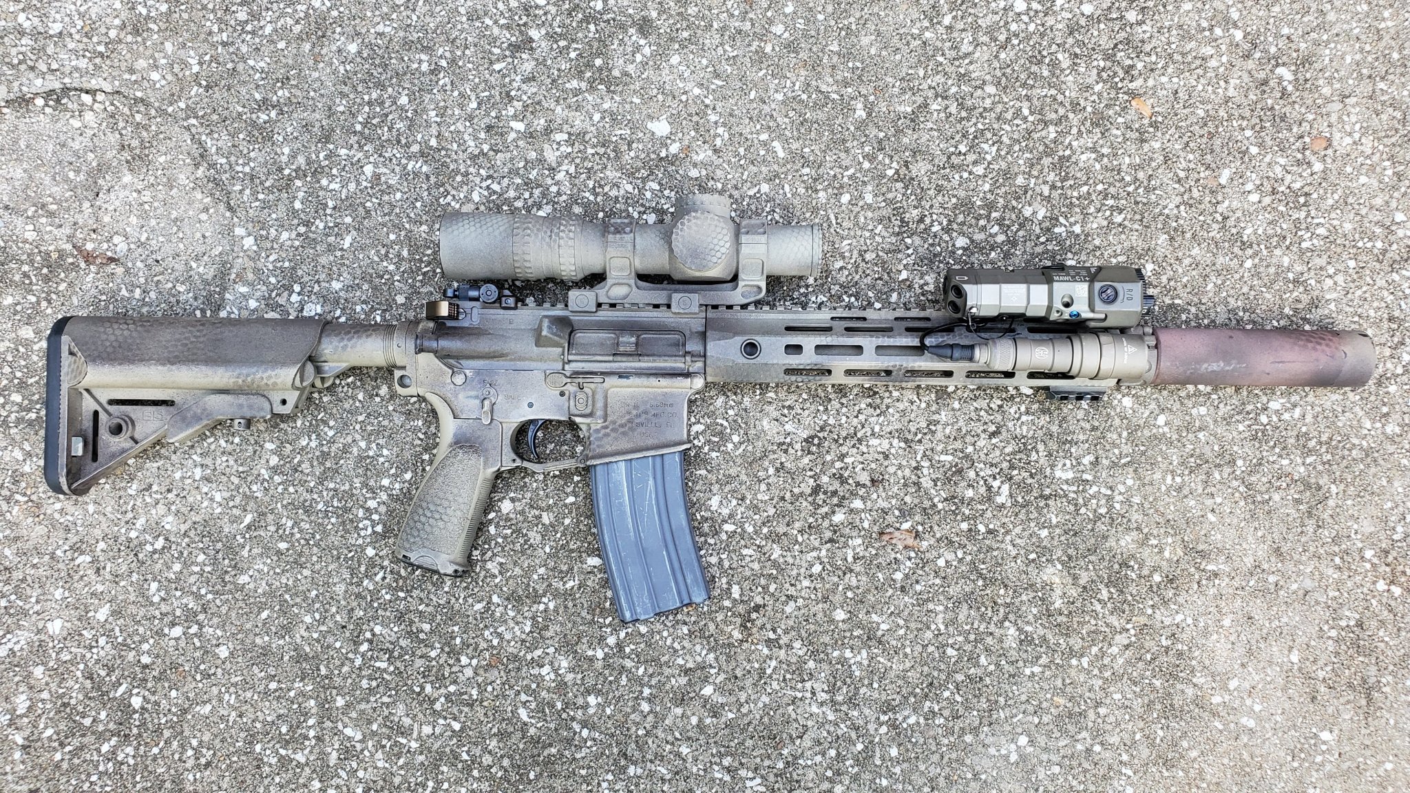

My idea of a "Mini-Recce": Bartlein 12.5" 1x7 with mid-length gas by Craddock Precision; SLR adjustable gas block; San Tan STT-15 billet receiver set; Hodge 11" rail; MSTN NM Ionbond DLC coated BCG; PRI Gas Buster; lots of V Seven titanium parts; Geissele SD3G trigger; Vltor A5 recoil system; Magpul CTR; SPR grip; Nightforce NX8 in LaRue SPR mount; and the new Thermal Defense Solutions Badger II suppressor (12 ounces).

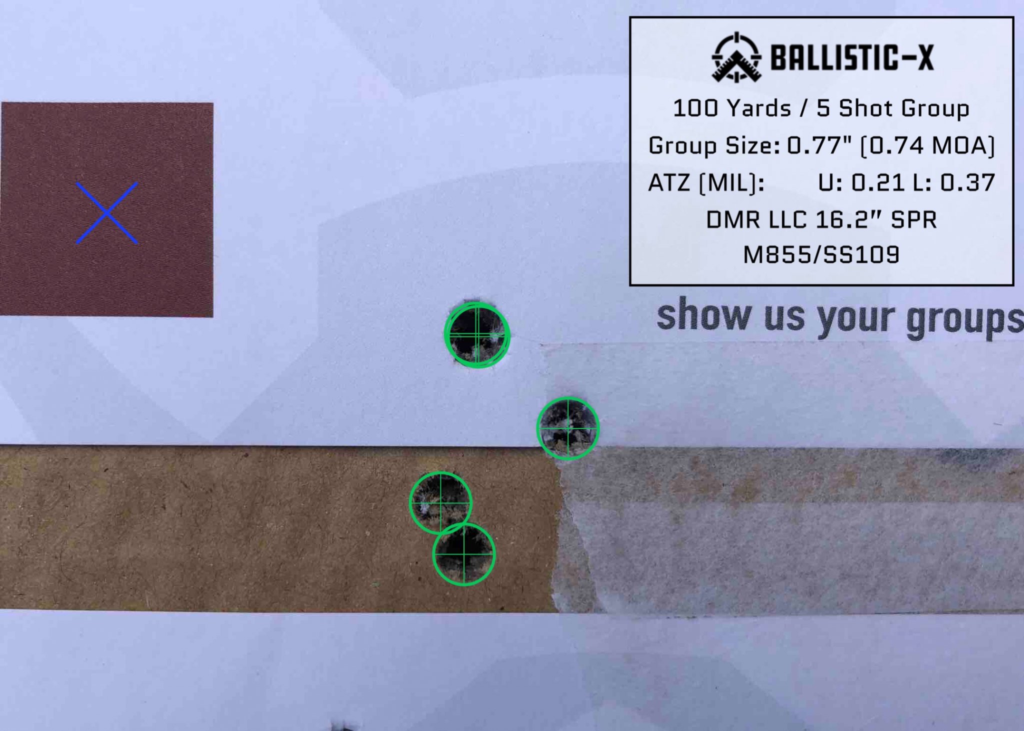

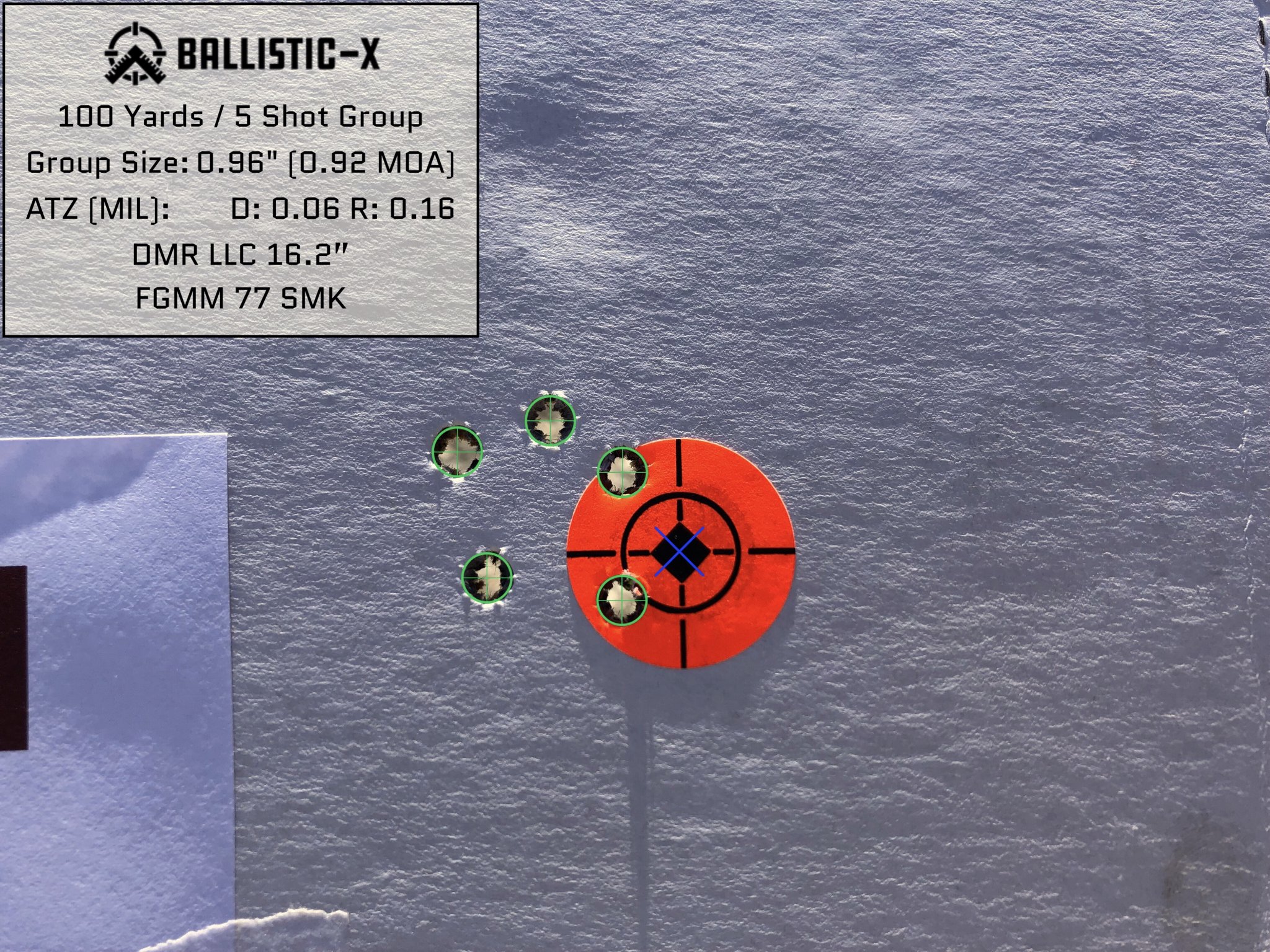

Do you ever shoot these things for groups? I don't think I've ever seen you post a 6x5. I'd like to see how those PR carbon fiber barrels perform
Yes, I shoot for groups. I don't shoot six five shot groups when I do. I don't believe I have the attention span to be an effective bench rest shooter.
Once sighted in at 100, with sufficient chronograph data, I move to steel at distance, more entertaining for me. Or the next project in line.
The Proof barrels are among the most accurate I've ever owned, right up there with Craddock's Bartlein barrels.

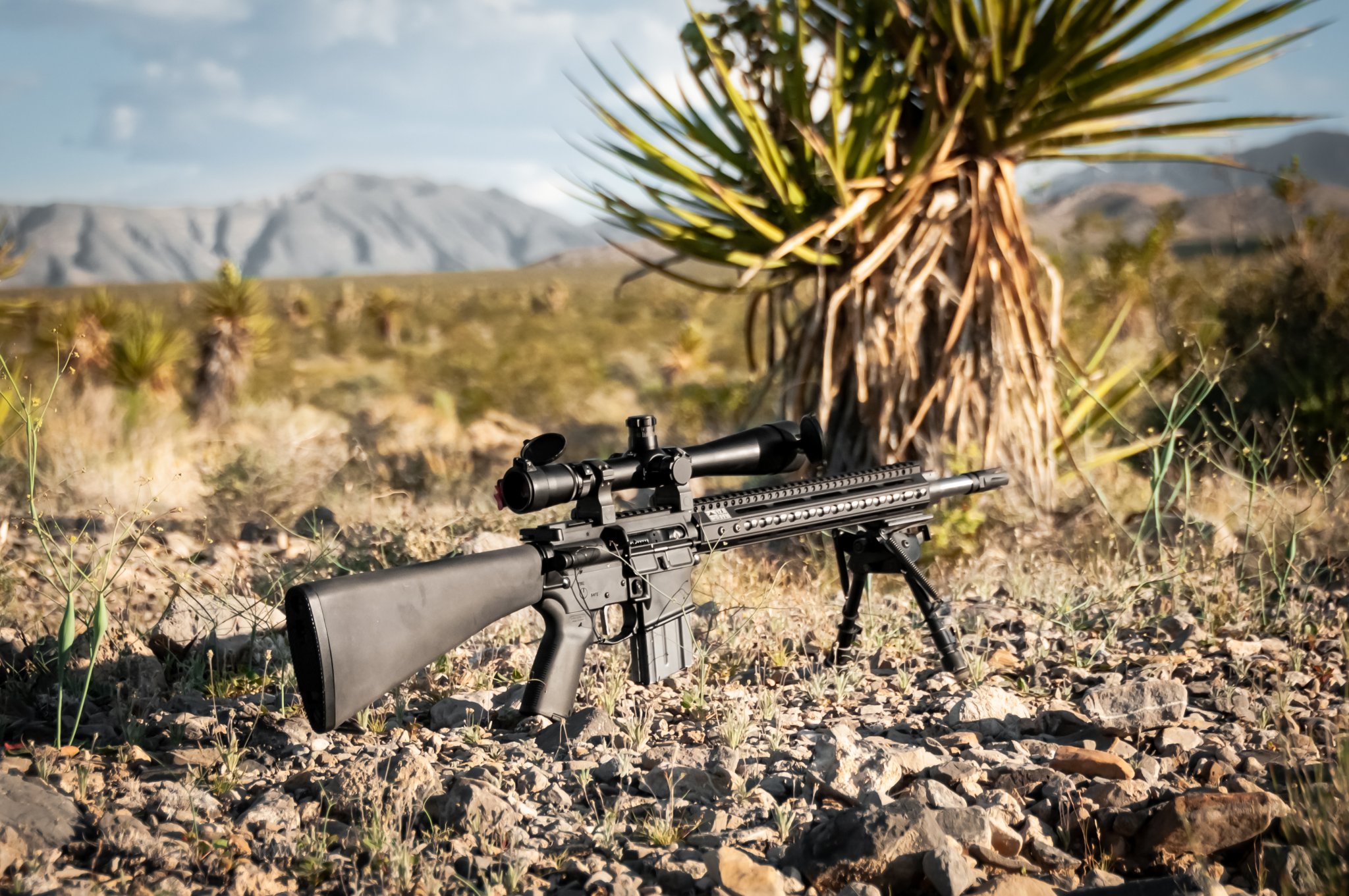

I'm in the process of finishing up another one just like this... But in 6.5 Grendel with the 20" Proof Research SS.

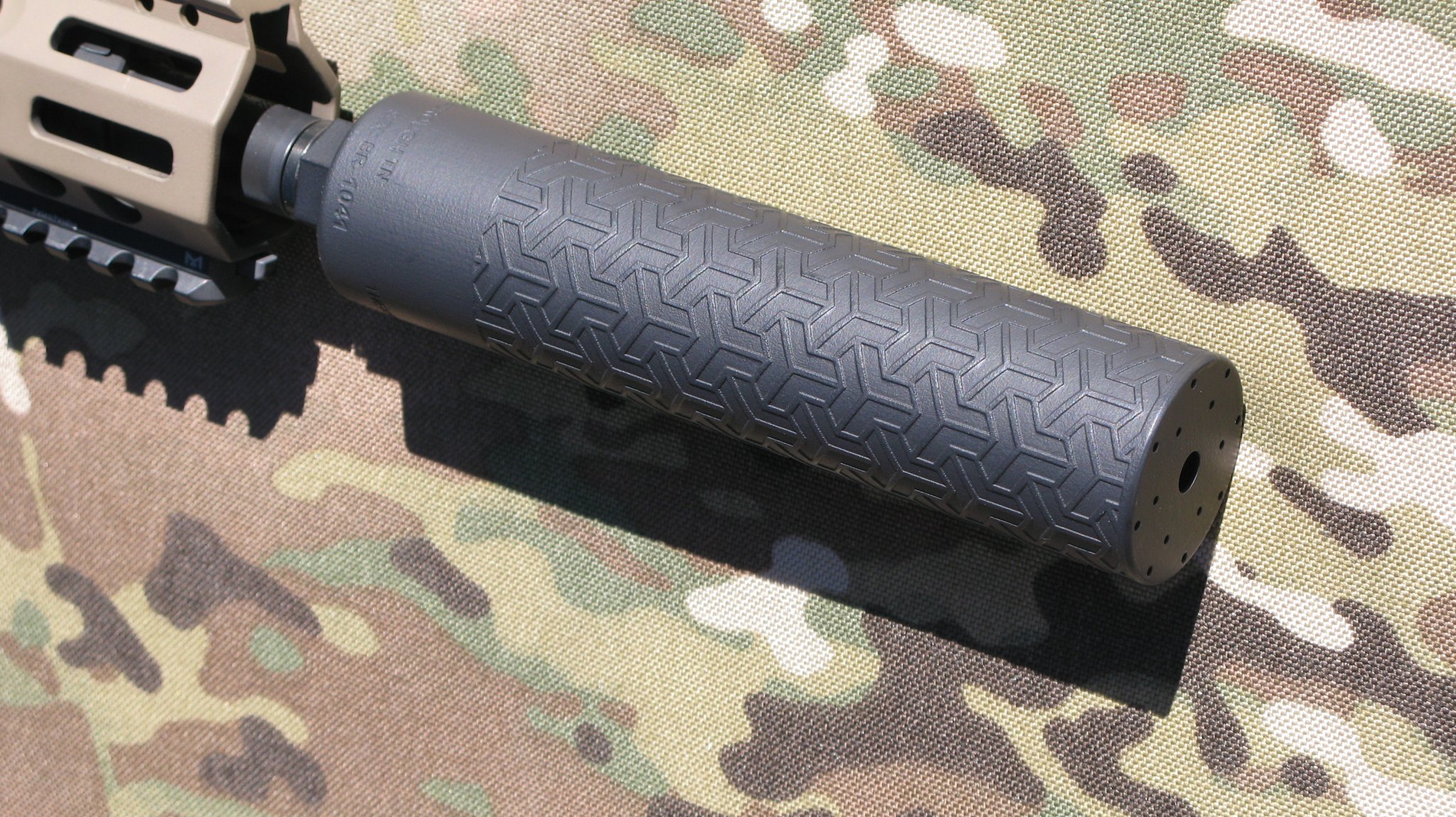

An old 14.5” noveske Afghan barrel
Ops inc 16th model Suppresor

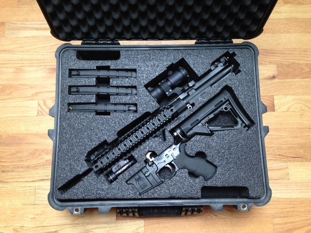

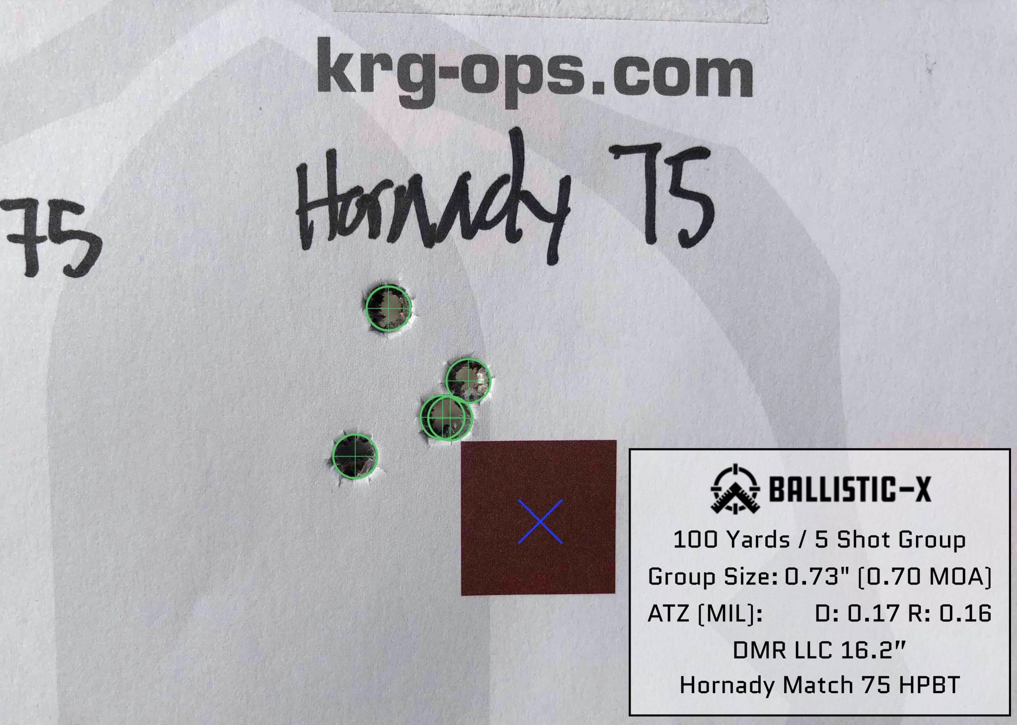

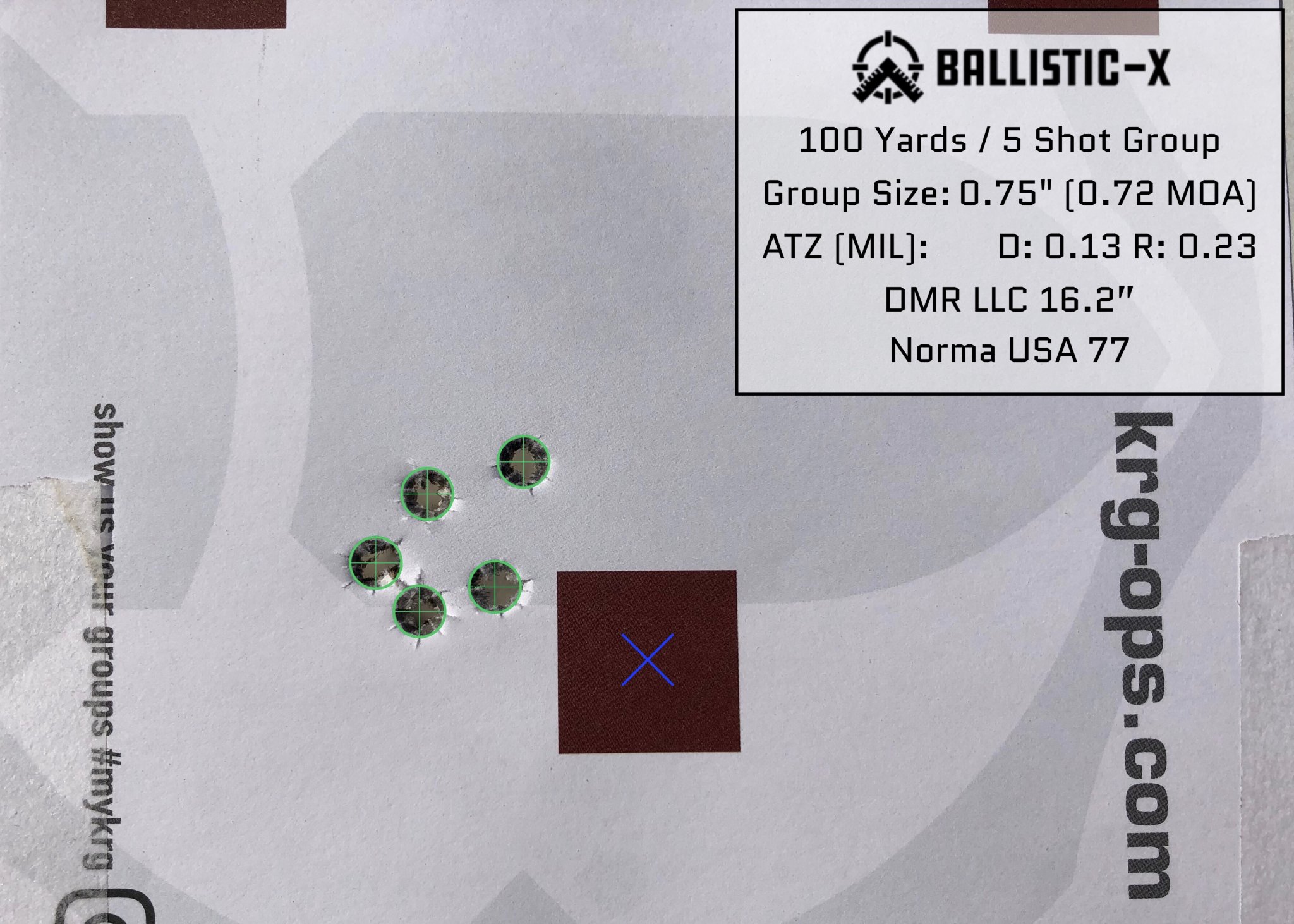

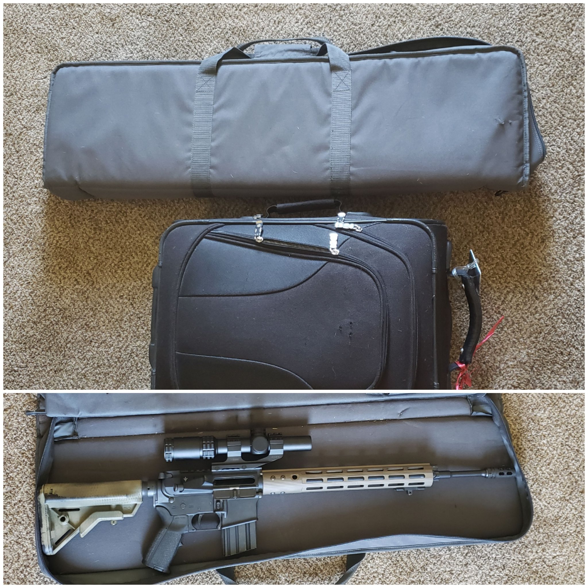

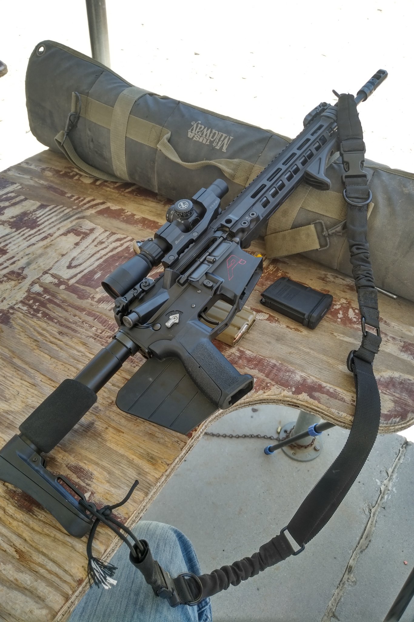

I built this one about five years ago based on an 18" Faxon Gunner barrel. It shoots really well with 77 Noslers. The target is at 400 yards if I remember correctly.
The goal was to get it to fit in a smaller soft case so I could take it on business trips when I could drive, and not get the evil eye when I go into a hotel.
Seems like that still screams “gun case” to anyone who cares to notice. I have a short grey case just like it but never felt like an 18” or 16” carbine like that was small enough to fool anybody.
That’s why I have a few different 9”-12” setups with folding stocks to carry in a backpack though.
Get a larger rolling suitcase, take the upper off, and stow it in this concept to save space.
Or like this
If you were really using your brain to definitely NOT look like you're carrying a weapon:
