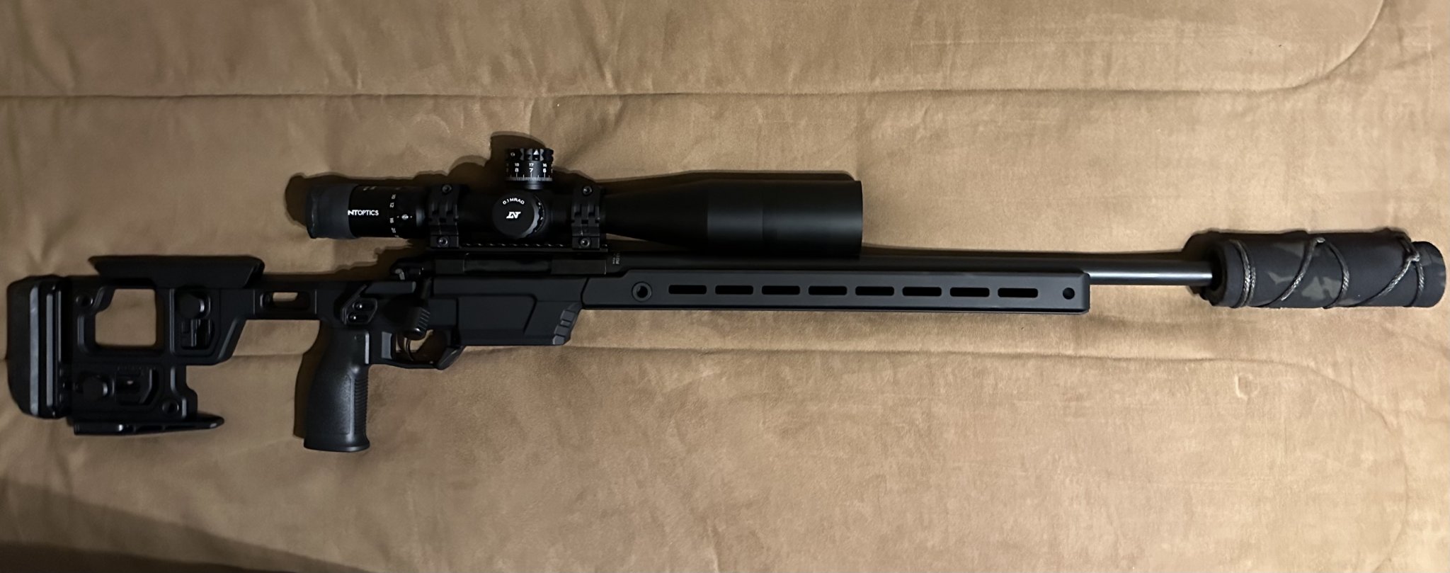

    Definitely avoid .308 Win barrels… Apparently none of those shoot worth a shit. Mine didn’t. The 6.5CM barrels seem to be MUCH better.

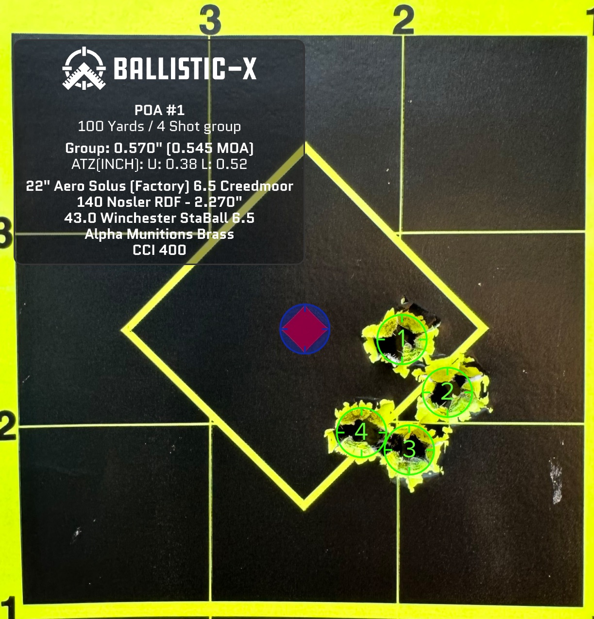

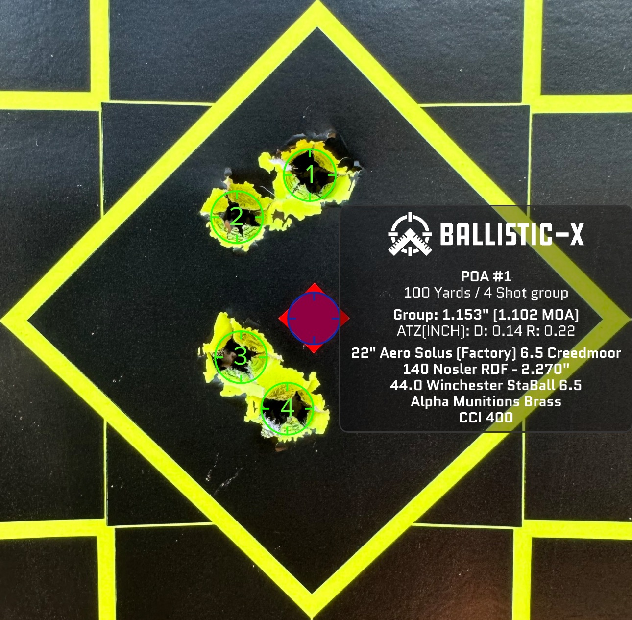

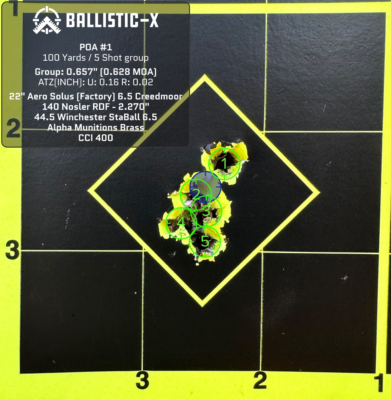

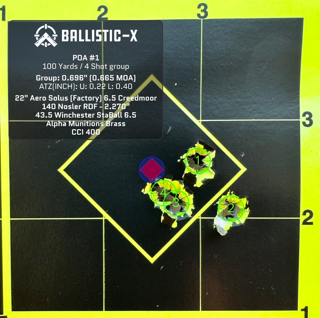

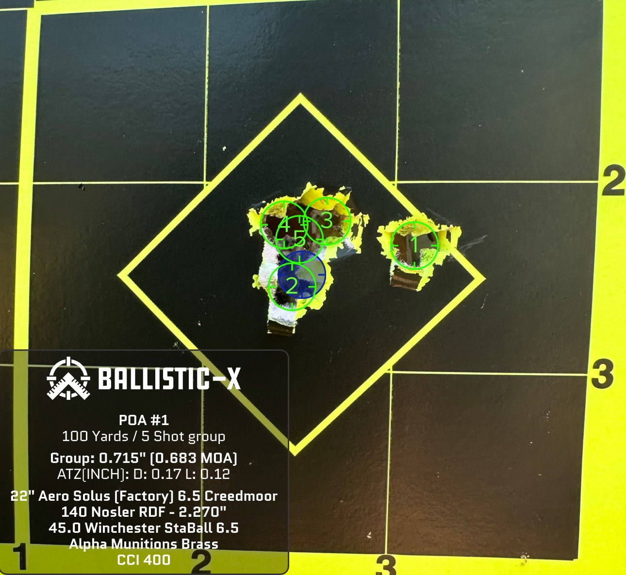

    Here’s my factory Solus 22” Sendero 6.5CM rifle with the very first 25 rounds of load development with random components (for me, I’ve never owned a 6.5CM until now), and it’s showing some promise.
    These were the very first 25 shots on a brand new rifle and barrel, with a freshly cleaned barrel.
    Not sure what the hell happened at 44.0 grains, but something weird did. The first 2 groups might have been tighter (by OA measurement), but other than the 1 random flier (that was me) on the last 2 groups, you can see how much tighter the shots were in conjunction with each other as the barrel settled in.
