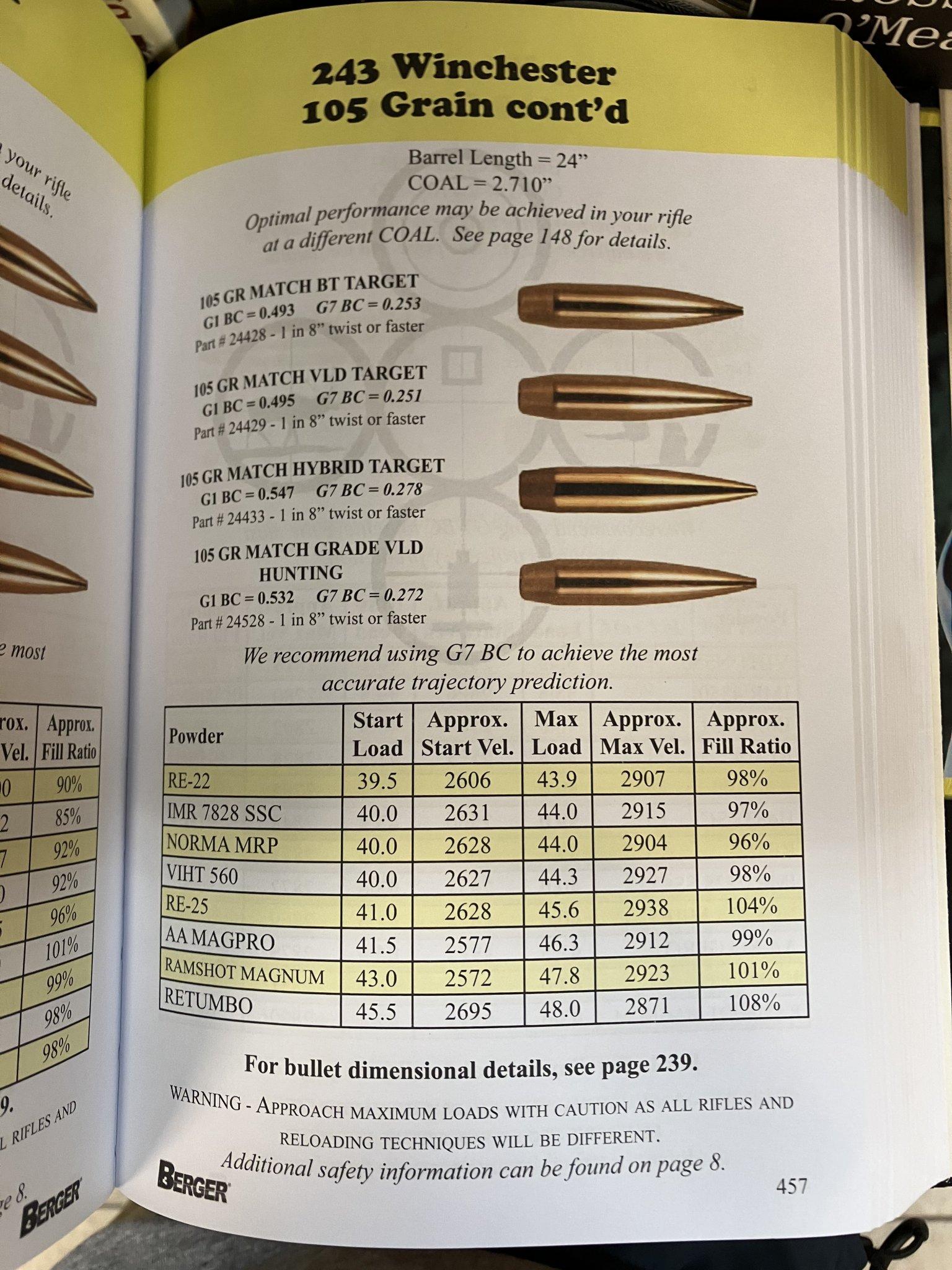

    This is a rabbit hole but I was able to bring up some technical data. Start here: https://www.6mmbr.com/243Win.html
    Read everything. At the bottom are links to guys who put these together in the past I just email my questions. They appreciated someone was ready to learn.
    Here’s one from the first page.

    Thanks. I have worn out the load data from 6mm br. I have a printed copy in my bench and it shows the signs of dirty fingers going through the pages.
    Seems like I will try some h4831sc. I also have some Imr 4831. I think I have some Retumbo and magnum in my stash
    I use 4831sc and it works great. I’m shooting a 105 Berger at 3190 out of a 26” barrel. Taken a couple deer and a lot of coyotes with that load.
    Shoots lights out so I’ve never even tried anything different in mine.
