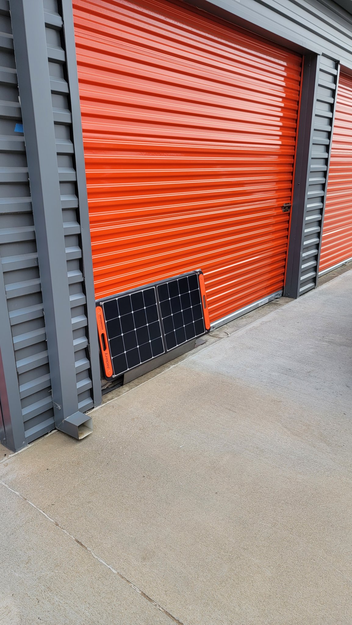

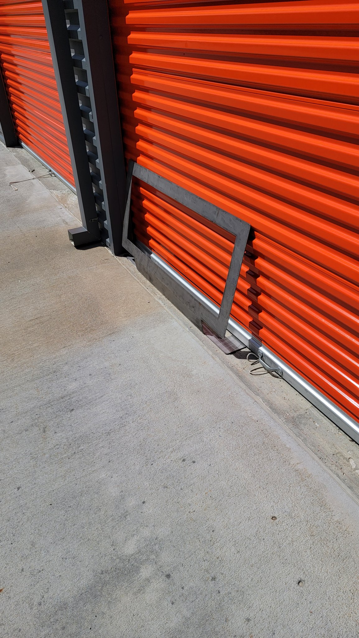

I have a jackery solar system I tried to use to keep the bass boat batteries charged in storage. Never quite worked the way I wanted.
The jackery pack was always off when I got there. Not sure if the panel charged it to full and then it turned off or if it topped the batteries off and than sat idle long enough it turned off. Built a slick bracket to mount the panel on that used the storage unit door to secure it.

@hukset402 : That's a pretty slick setup. Did the pack end up draining down or it just stopped operating/charging?? I'm not familiar with the brand or functions.
Not really sure. The pack was always full, but would turn off and not charge the boat. Tried plugging in a drop light on a timer to keep a draw on it all the time but it didn't seem to work.

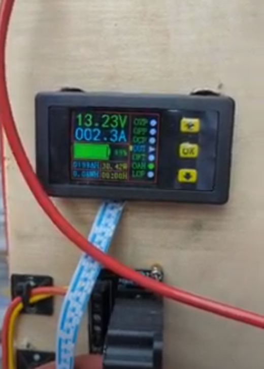

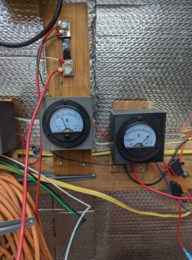

The thing with me doing it myself is I am learning as I go. Generally this has been event free. I did blow up one little part, but that was pure stupid on my part. Red is + black is -, the magic gets out if you mix them up, and I popped this guy.
Not really "important" just a fun little doo dad that shows me what is going in and out. Currently I am not even using this thing as I took a big step forward and upgraded to this:
Yes everything is a bit of a mess, I snapped this right after I got it working. Cool, little needles.....so much cooler then digital numbers.
As you might have guessed I am really playing with this thing. It is running the shop, but I am fiddling with it minimum weekly. Not because I have to to keep it going, I fiddle with it because it is just fun to tinker with. Wires are everywhere, but nothing stays put, I keep changing stuff. Adding more stuff this week, and added 4 more solar panels last weekend. I also have a 3 axis auto sun tracking gizmo that I need to get off my tail and pour concrete for and get mounted, that is not going to happen when it is 98f and 99% humidity outside.....nope.
