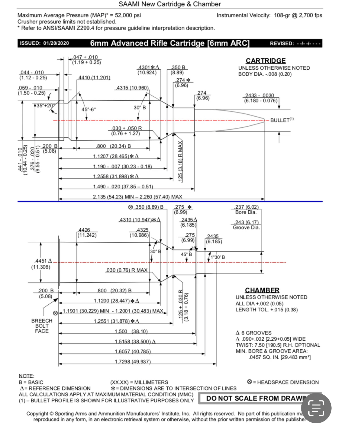

Your numbers look alright compared to the reamer print and your relative fired vs sized. They all get smaller and are all smaller than the reamer print.
