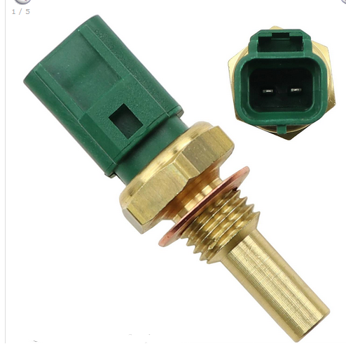

In old Toyotas it is not uncommon for the ECT to just wear out.
takes 10 minutes to replace and is like $10-$15
looks like this
I replace them when I do a thermostat like standard maintenance.
Normally when the ECT fails it is stuck in "the engine is cold position" which would not cause fans to turn on. The usual symptom is slow to start on hot restarts because the ecu is adding fuel like the engine is cold.
Food for thought to just replace the ECT as general maint, 100k to 150k
