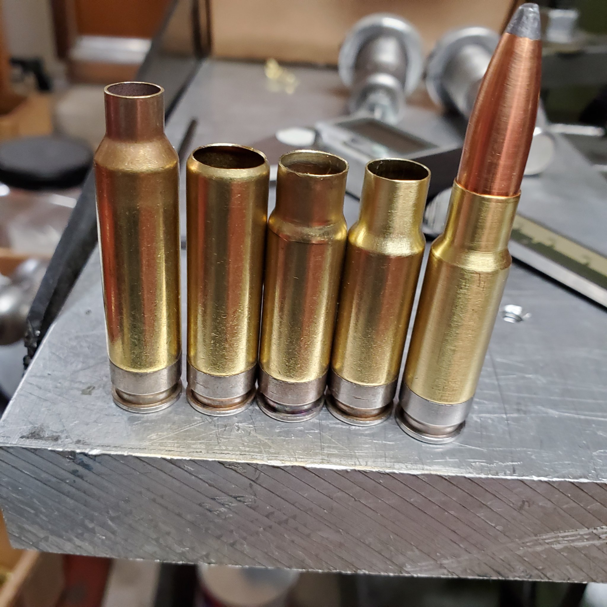

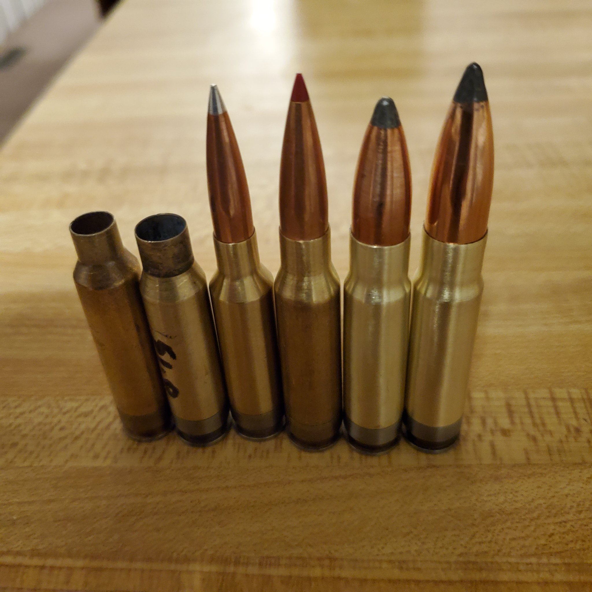

To my knowledge the case is reloadable. I just purchased 100 cases and waiting on them to arrive. I’mgoing to re-size 50 of them to 6.5 Creedmoor. The other 50 I’m going to attempt to neck down to 6mm and see what happens. The 6.8 doesn’t have much options for projectiles compared to others.
I've been shooting hybrid cases since they first came out in many calibers.
They can be altered to fit any 308 case head cartridge, like 6.5 CM, 7mm-08, 308, 338 Fed, 358 Win, 8.6 Blkout, 6 Dasher, etc.
But I haven't chambered a .277 barrel, because quality reamers were not available...the high pressure of the case has scared most off and some concerns are validated.

I’ve seen someone else on YouTube said to make 6.5CM they just trimmed it down to length and then ran it through a die.
I think I’m going to try cleaning and then annealing. Then trim to length of CM case and lube the he’ll out of it and run it through a 6.5 die. Think that would work?
Reactions: M21ART87
I’m not necessarily saying you have to run the pressure all the way to 80k but maybe give it a bit more and they suppose to give a little more case capacity. I think we’re gonna start seeing more HP cartridges in general over the years. About to release the 7mm back country. I’m sure the other manufacturers are gonna come out with some too.

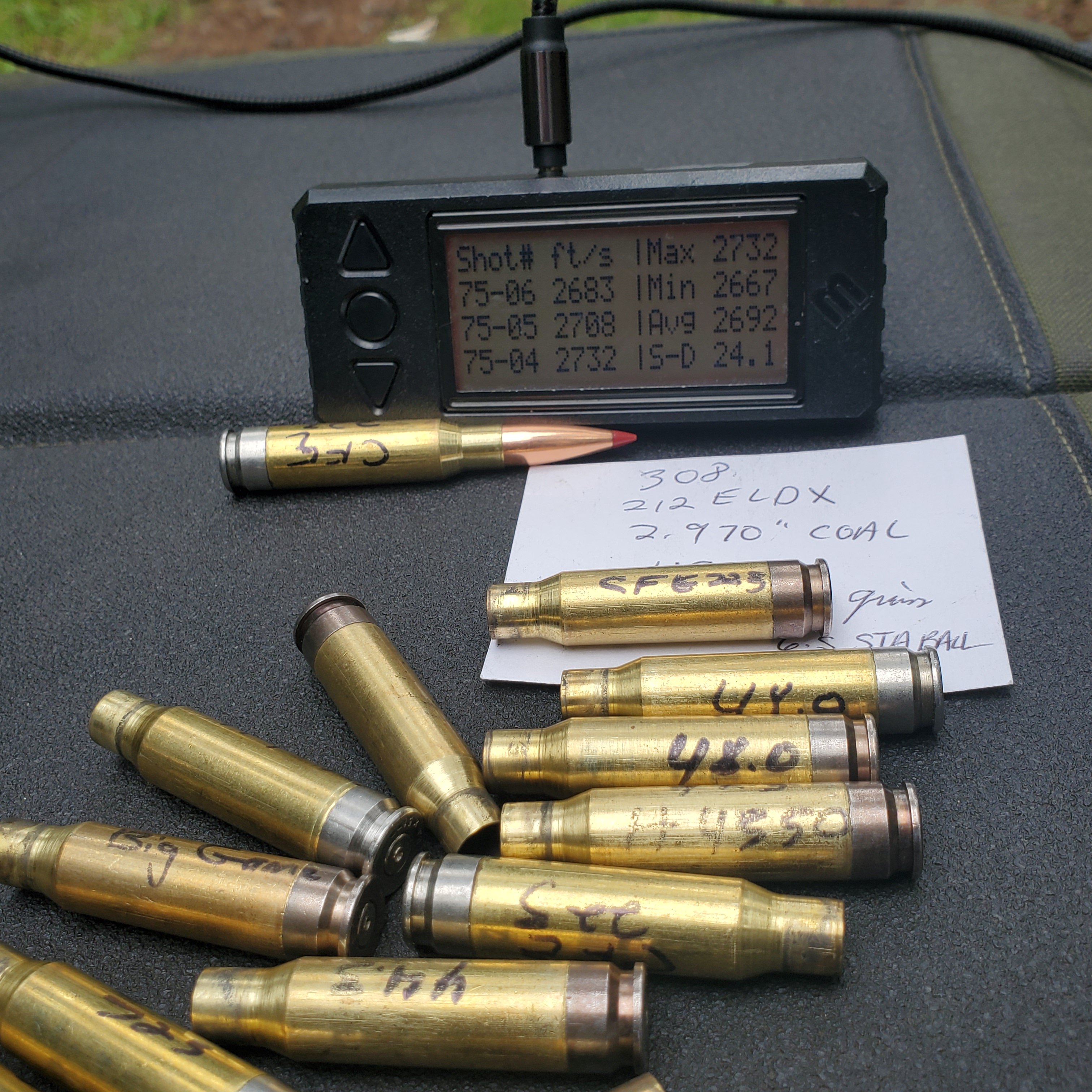

What powder would you recommend to his these MVs? I don't even know where to start
You start with normal manual loads and fireform the cases to see if there are any issues.
Trim to length if needed after fire forming.
Then set your dies to slightly bump the shoulder back as usual, now you are ready to begin your load work up.
I have heard the later hybrid cases may have a little less capacity a grain or so as Sig is not the only manufacturer it seems others like LC may be jumping in as dates are on the case heads now....mine are all early cases. So exact max charges will likely be different as capacity is a little different.
These velocities were obtained with RL 17.
Example: The 22" 9 twist liked the 208 Bergers at my detachable mag length at about 2670 fps.
I try most any powder as the variety shown here, with 2 different 308s with different barrel lengths.
The powders listed on the cases are the final MAXIMUM loads.
Only a moron would start there.
I have the data but too many of the people on the site have no common sense, they don't follow instructions, or neck turn, anneal, seating depth is very critical, as is bullet composition, length, & profile...ya can not do a half assed job and expect Safe or good results, as you are working in a more critical area, than with brass cases.
CFE 223, 2000MR, Leverevolution, or 6.5 Staball for heavier bullets, get good velocities, depending on bullet choice.
Not many powders will work as well, but all will have some improvement, depending on the shooters preferences for accuracy.
