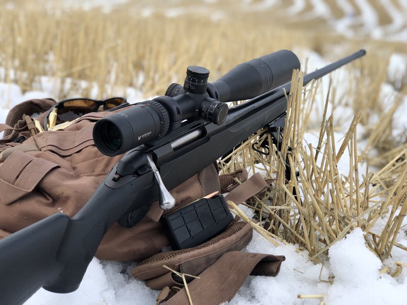

I walked into a good deal on a Tikka T3 light in .338Win the other day and threw my 16 power HST on it.
i haven’t shot it yet but decided to try some 250gr SMK’s in it for the first load and charged them with the book max of R-19
its mostly factory except it has been glass bed and a break put on it.
i have had 5 other 338LM’s and have loaded thousands of rounds for that cartridge and have killed well past 1K with it.
(Not bragging) but this is my very first .338WIn.
the Tikka has a 24 in factory barrel with a 10’ twist and the book said it can fetch 2700FPS so I hope to get that.
my question is this, do you use the .338WIN for LR hunting or just a short to medium ranger? , how do you like it? I guess I want to hear what your personal limits or recommendations might be with it.
thanks!
ps......it’s been quite a while since my last post so I don’t know if I am in the appropriate forum so I understand if admin pulls it.

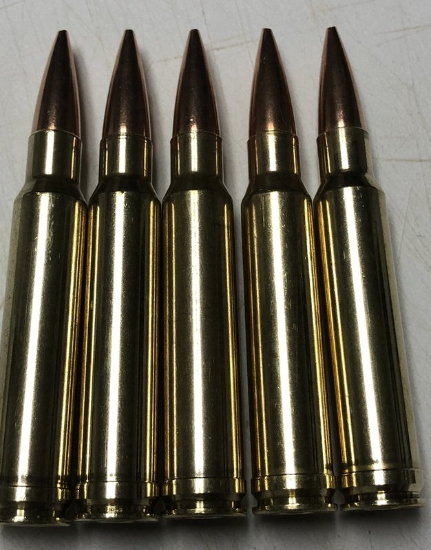

I went out today to get the rifle on paper and need to do some more tweaking on the hand loads. Best I was able to get was 1MOA @100 yards 3shot group and I know Tikkas usually do better than that.
If I can get something “heavy” to run 1/2MOA or better then
it might replace my .338LM for bear hunting off the TW200.
