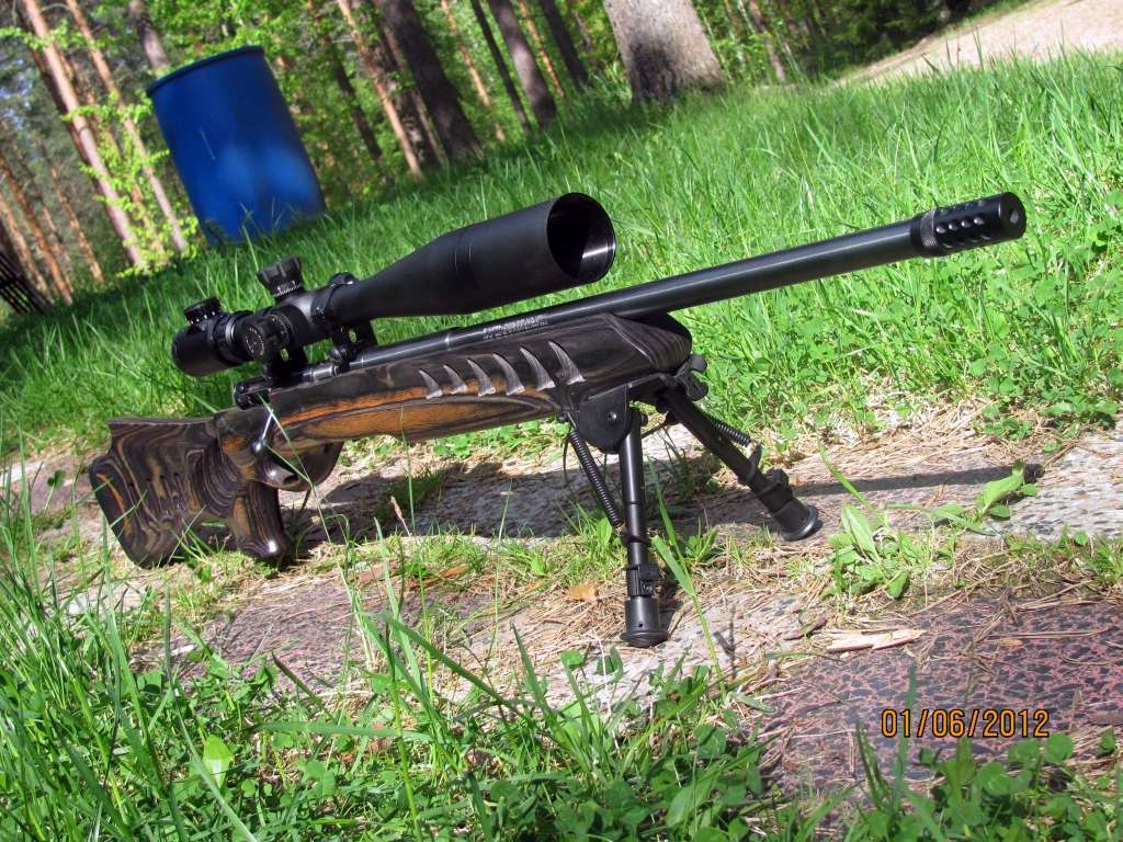

I have a Savage MAKO 93r17 that I would either love to mount a atlas rail to the bottom, or try and get a spigot in the front, I do not want to mount a harris. I cannot go back after having the Atlas. Preferably the spigot would be the best. I beielive because of the shark fins cut in the front of the stock, the spigot could be modified and threaded with a nut from the back side ( inside the shark fins ).... any ideas? or should I scrap that idea and just mount the rail?
ps. the rifle in the picture is not mine, I just don't have a picture of mine on the computer yet....but I thought that would give an idea of the shape of the stock...
