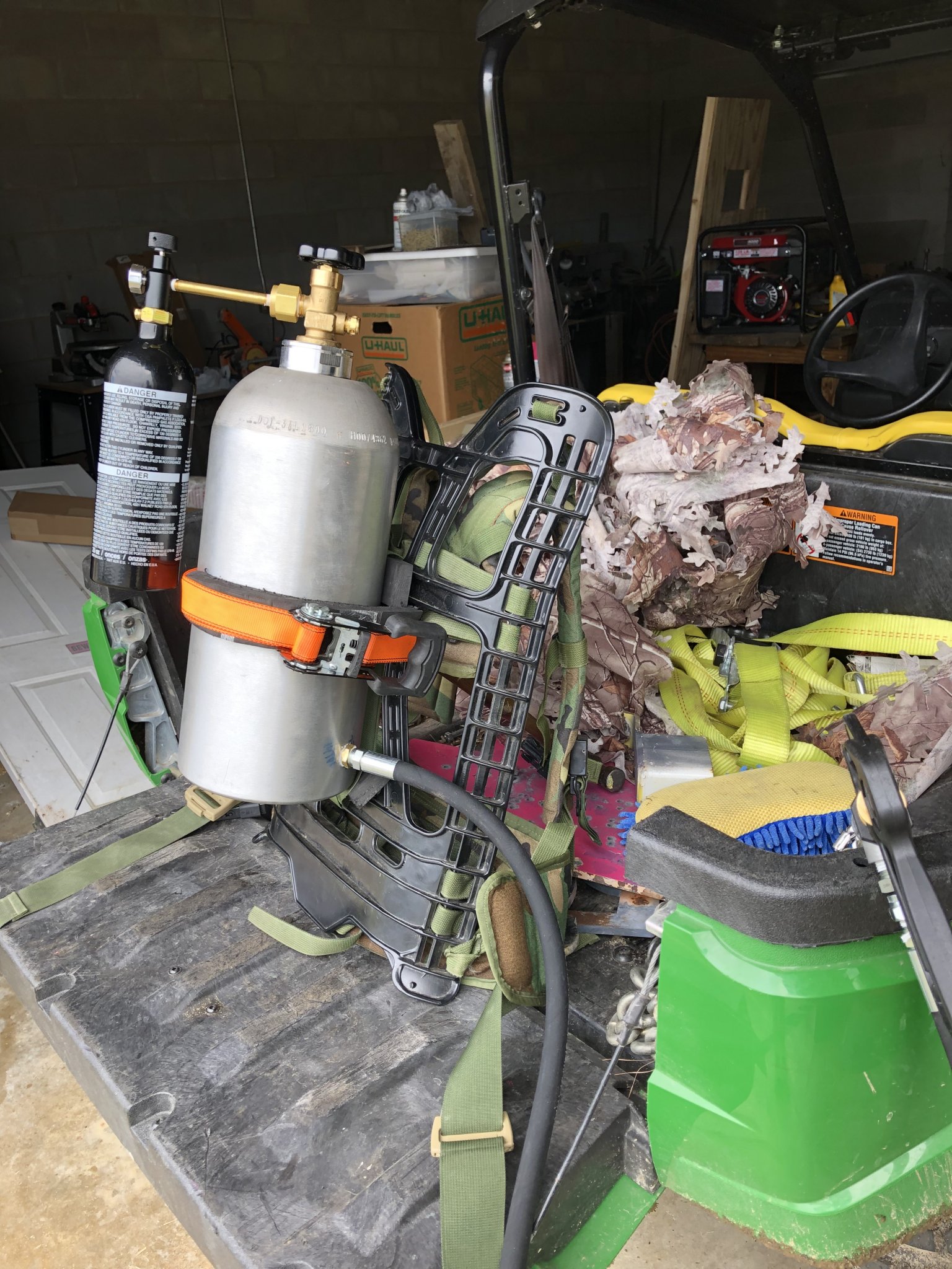

Great start! More details, please. Or if you prefer, hit me with a PM. (about this project)
10# CO2 tank with CGA 320 valve
1/2x14 NPT thead for 3/8 feedline. Will upgrade to 1/2 soon with camlock attachments to mimick true flamethrowers.
commercial grade pressure washer wand with needle valve(regular ones won’t work because the pressure iS on the valve and will leak. Needle valves allow the pressure to force it closed so it is not as prone to leaking.
one 20oz CO2 for pressure.CO2 also serves as fire retardant in tank and keeps any stray flame from burning in wand. Going to make the CO2 tank a remote mount soon as well so I can add a more reliable pressure gauge and another blowout in case of over pressure. It currently has an 800 PSI burst disk on tank and 3k psi burst disk on co2 bottle.

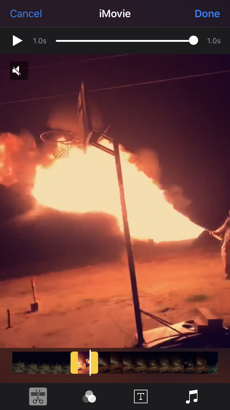

Another test run on the 4th of July. I haven’t had time to do much more testing since it has been so dry here. Once Fall or some kind of moisture shows up I’ll have more to post on progress

Working on video. Have a couple but no real social media to upload to and share links. This is my only connection to the “social” world with internet
