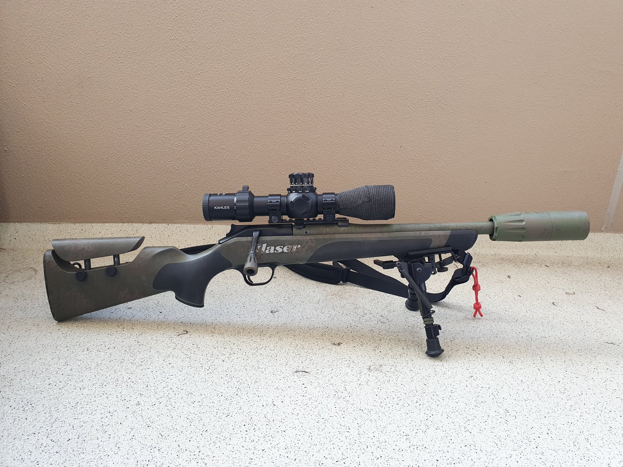

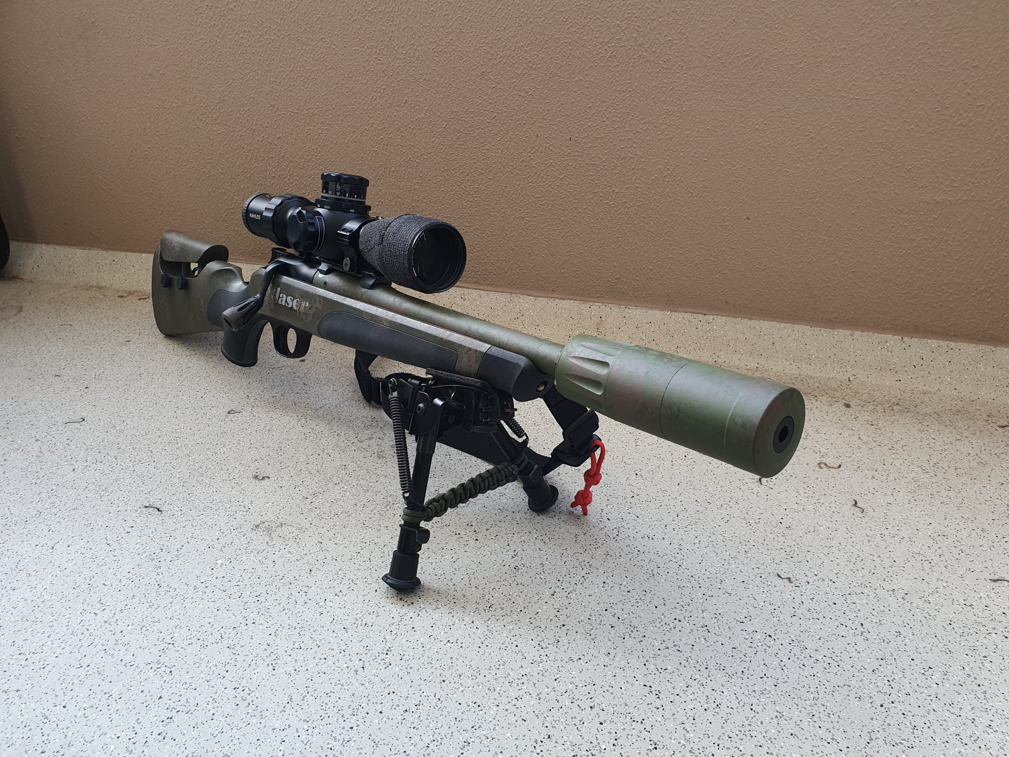

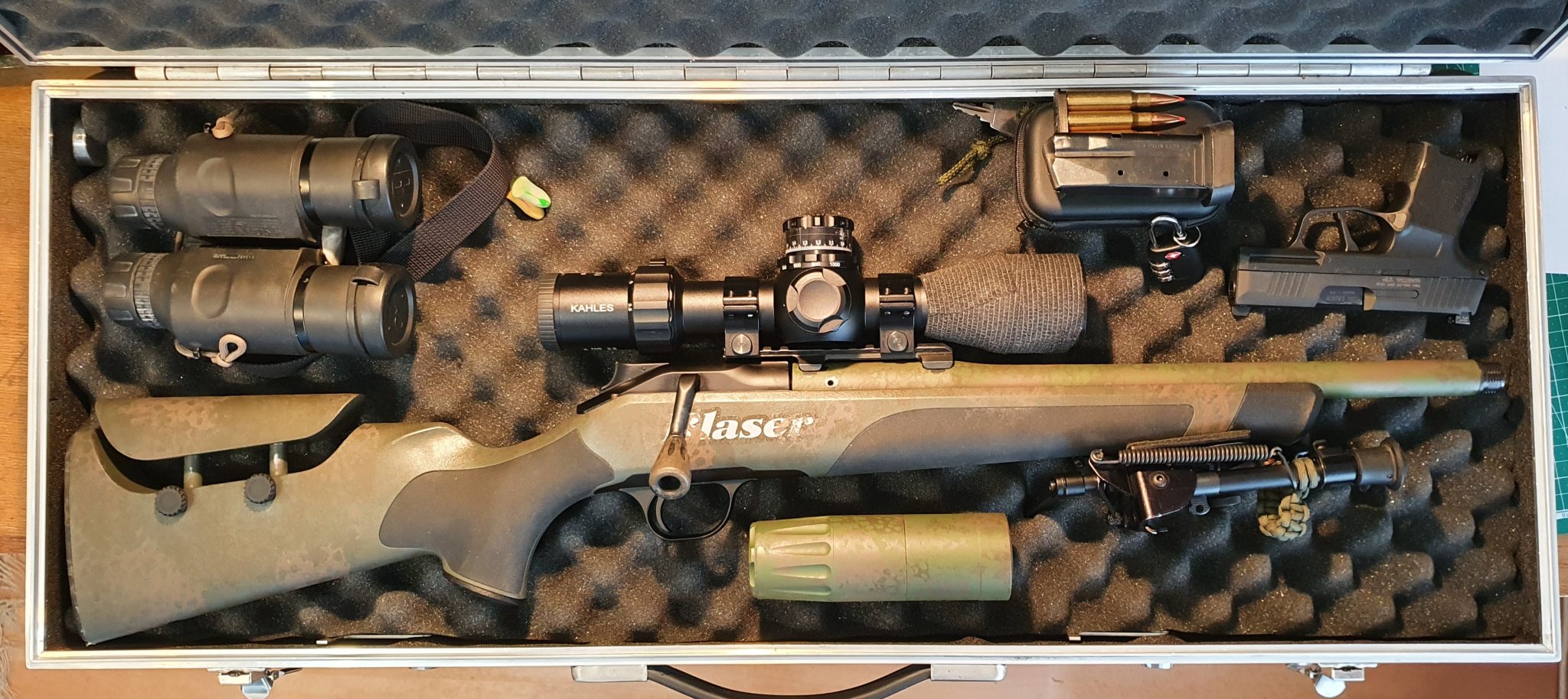

Hi All,
Here is the final “report” on my Blaser R8 SBR build.
The R8 with its exceptionally short system makes a great base for a suppressed SBR.
The goal was a very compact hunting rifle, good for 50-300 yards, small to medium game.
Blaser is only offering a 18" barrel in the thin 17mm contour and the 16.5” with the integral suppressor contour as seen in this thread above, which is thin for my taste.
So here is the project I finished:
Stock: Blaser professional with adjustable cheek piece, QD cups and green/olive/brown camo paint job. Cut by 1" and thin 1/10" "recoil pad" installed.
Barrel: .308Win, 15" length, 11" twist, 21mm medium contour, threaded 15x1mm, matching paint job.
Suppressor: A-Tec H2 modular over barrel with 60° quick detach mount and matching paint job. Can be used in 3 length configurations.
Optic: Kahles K318 3.5-18x50 MSR
Bipod: Harris with lever
Sling: Helikontex
Overall length of the rifle:
32" without suppressor
34" with short configuration suppressor
37" with full length suppressor
The rifle is no featherweight but a solid 11.5 lbs with everything on it…
