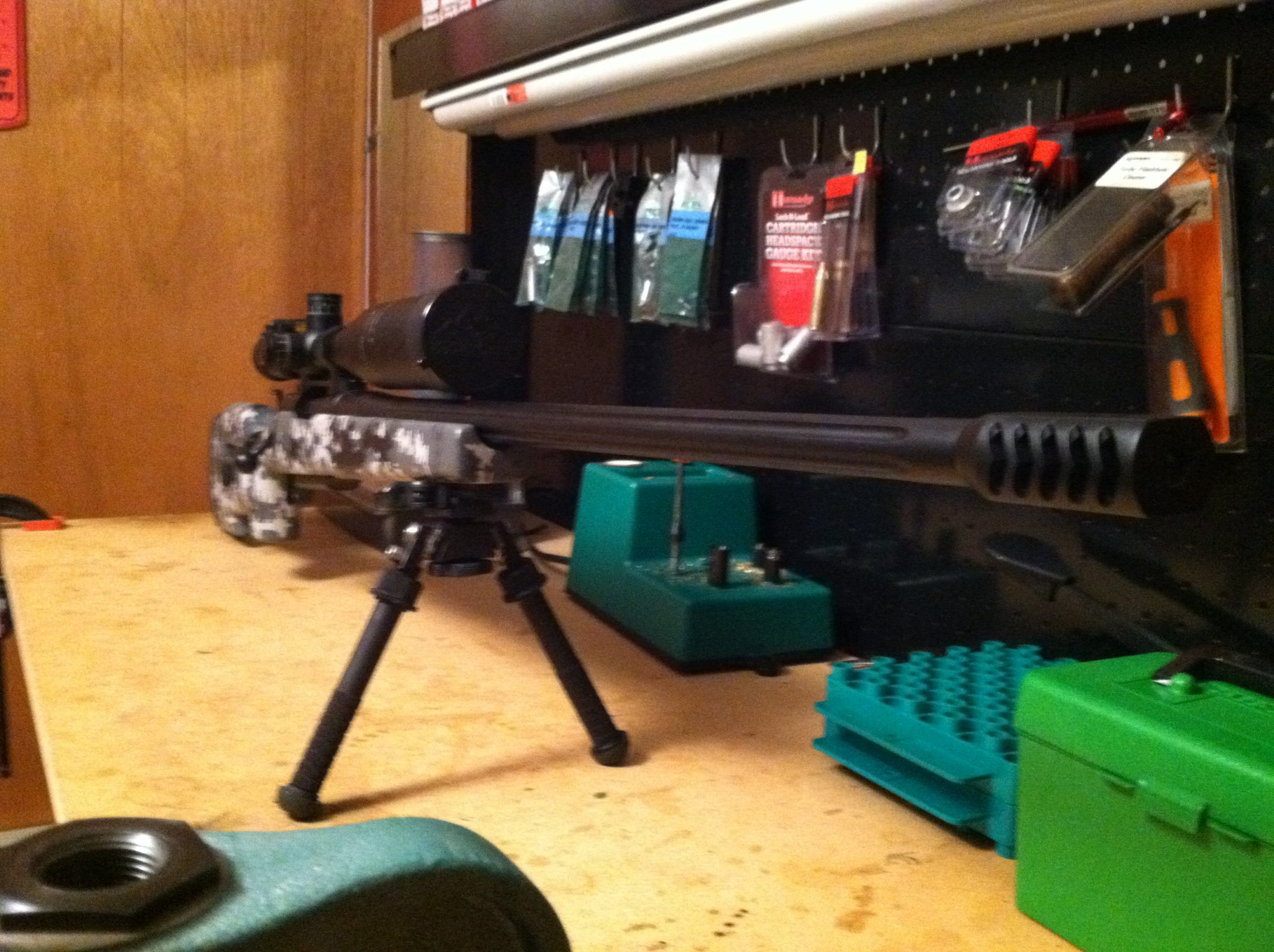

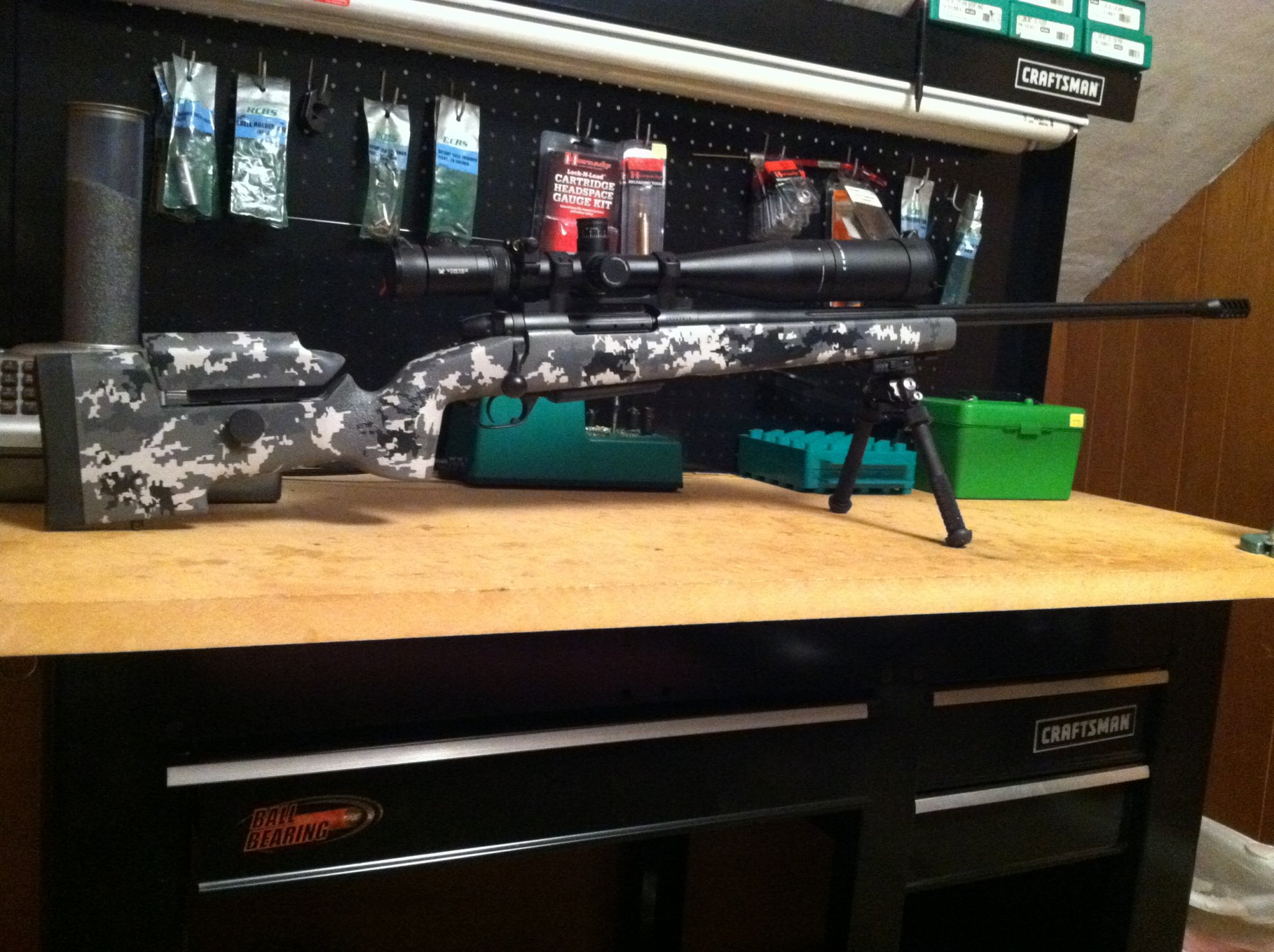

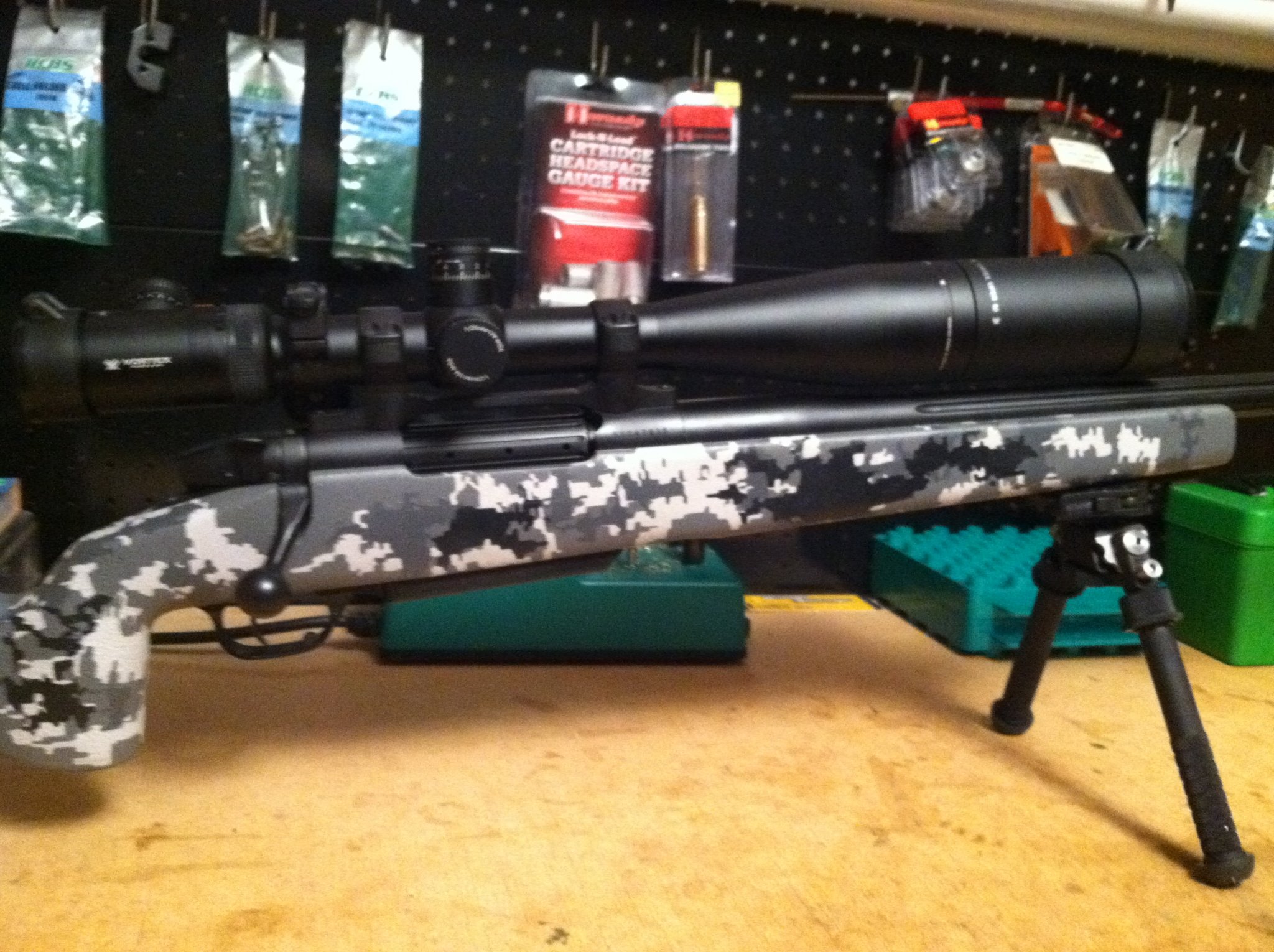

    I've built a .30-378 WBY and 6.5 RPM on the MK Vs, used a proof barrel both times. They both shot excellent, the 30-378 shot .2s and .3s The RPM is shooting about .5 last I heard. Both carbon fiber barrels.

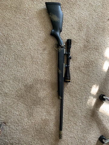

    Kevin Wyatt of Wyatt outdoors built my 340 Weatherby using 1&12 twist octagon shilen barrel no free bore with 250 grain nosler partition bullets groups 1/2” at 400 yards this is on a custom Kevlar thumbhole stock and custom break. This is my go to hunting rifle hear in Alaska
