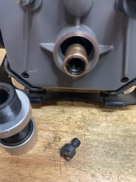

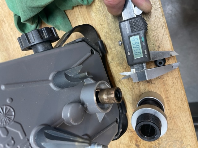

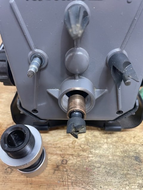

Not a fan of the trimmer this unit comes with as it never seems like it's precise enough. Starting fiddling with it and was hoping to mount a drill chuck to it so I can run a Giraud or Gunworks trimmer on it. Seems like it would be the perfect setup where I could trim, inside and outside chamfer all in the same step. Not sure of the thread size on the cutting head but figure there has to be a way to adapt it to mount a regular drill chuck on it. Anyone?

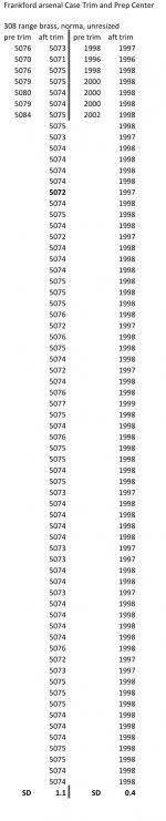

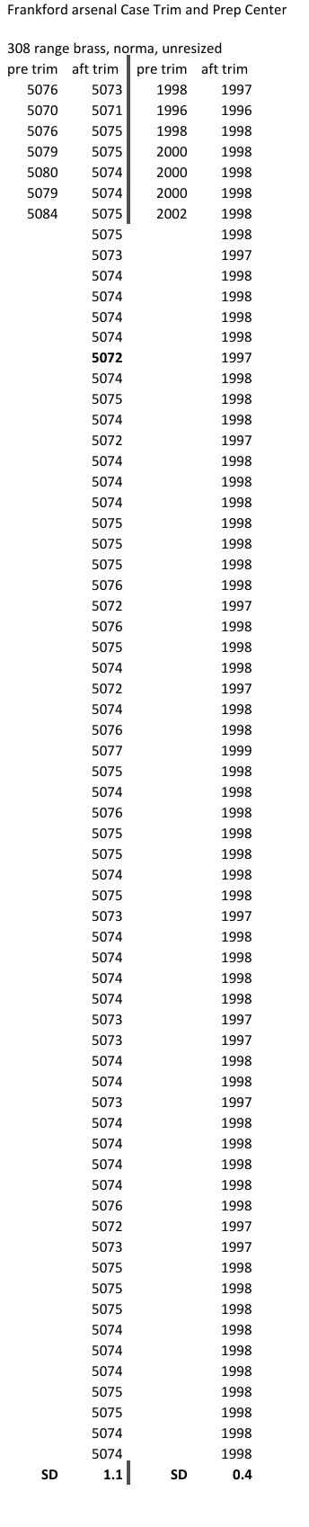

From what I have tested and used mine, the inconsistencies in trimming length are mostly due to poor case resizing. I fixed that by changing to another lube.
After that my trimmed cases see an SD of 1 thousandths or less and usually the remaining microburrs on the case neck from neck chamfer are enough to cause that. They vanish after firing and usually the brass is good for bullet seating the next few firings. This is semiauto brass.
I imagine someone could make an thread adapter or could it be possible to rethread the tools to fit the prep center?
Attached pic of non resized range brass that I used as test, usually I trim after resizing becase the brass is all bent up before that.
Left metric, right imperial.
