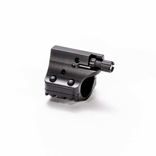

    JP just released a new gas block
    Saw that in the new product email the other day from JP... Finger and tool adjustable, external detent mechanism that hopefully won't carbon foul, low profile and should fit inside most hand guards.
    I'd like to try one but all 4 of my JPs have the older profile barrels with .936 gas blocks, and they don't make the new gas block in .936 yet.
    Guess I'll stick with the SLR gas blocks I have on there until I rebarrel the uppers... The SLRs work fine anyways. Just have to run them from full closed to full open every couple hundred rounds so the adjuster screw doesn't carbon lock and then break when you try to force it because you were too impatient to wait until you got home to soak it with penetrating oil or C4 carbon remover.

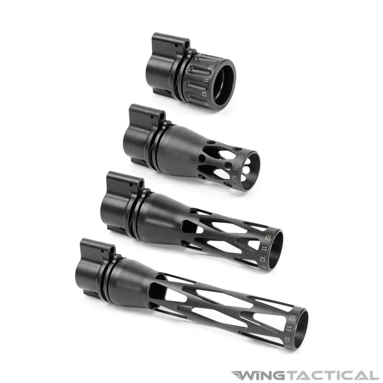

    I've used most of the ones listed except for the new JP. 52 clicks of adjustment is just stupid. I do like the detents are on the circumference. It's a functional improvement over the old version, the number of adjustment clicks notwithstanding. The POF dictator gas block is likely more reliable long-term due to the large adjustment "pin" being more resistant to erosion long-term. And 12 clicks is more than enough adjustment for ejection perfection.
    I hated the SA gas blocks due to the large number of adjustments, no real marker for going from normal to bleed mode and the tiny hex wrench needed for adjustment. Yes they worked but they will lock up if you don't use the adjustment periodically.
    I still like the Riflespeed for tool-less adjustment overall although it's not without one or two warts itself. I find when new, they tend to bind and lock up way too easy to the point adjustment isn't possible at all. Takes a bit to loosen up allowing adjustment when hot. It's happened to all three of mine and I use plenty of lube. Once broken in, they're very easy to use. The 12-click range, if using the right pin, is more than enough for something like 300 blackout, supers and subs, with the adjustment range falling within the same 12 clicks. My 8" 300 blackout uses 7 clicks between supers and subs. Each click is numbered clearly so there's no guessing. The adjustment pins are too expensive for what they are but that's capitalism.
    Choosing bleed off or restrictive on the superlative arms block is done when the gas block is first adjusted. It's in the instructions. You turn the adjustment out X number of clicks. Then when you adjust, you turn the screw in if you want restrictive and out if you want to adjust via bleed off.

    Anybody used the seekins selectable adjustable gas block?
    I’ll add another bad experience here.
    I used their other style adjustable gas block, was a complete POS. It blew out the adjustment screw on “open”
    They work well. The lever can be tough to reach with most handguards though.
    I like the rifle speed better.
    Reactions: AleksanderSuave
