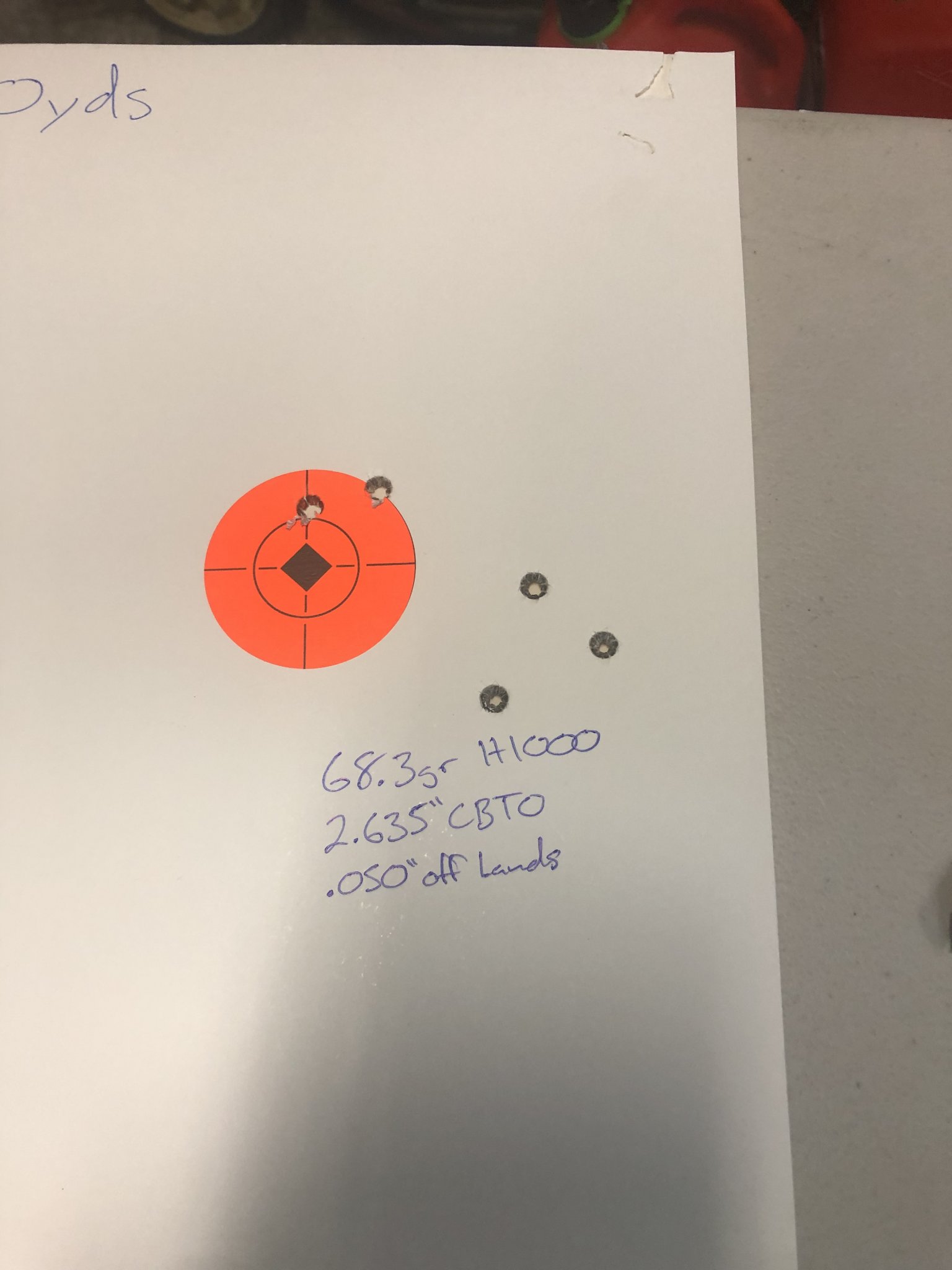

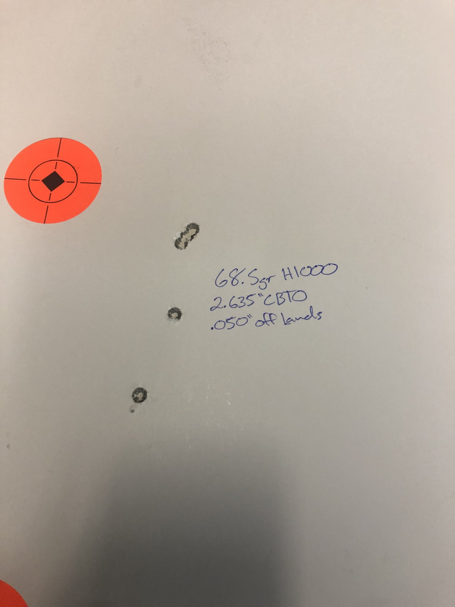

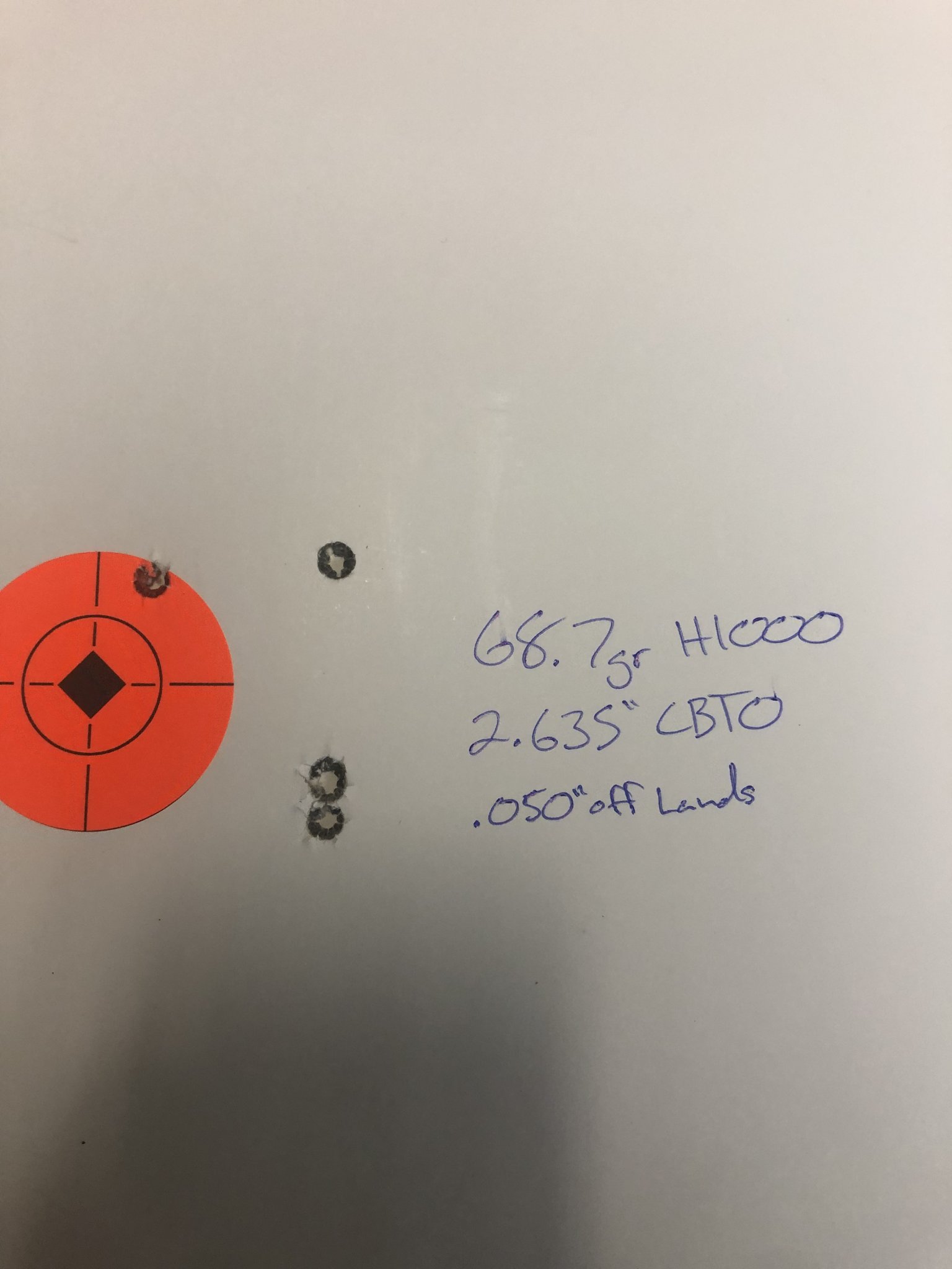

I tried to just kiss the lands using the Hornady tool. Using ADG brass and worked all the way up to 70gr of H1000 which yielded about 2950fps. But thought I found a node around 68.5gr which was 2850ish fps. These groups were shot at 300yds

I’m assuming that’s about a 2” target? You have 2 instances of bullets touching and then vertical. I’m curious if you’re not keeping your rear bag firm and fully supporting rear of rifle with your hand? You could be letting it dip shot to shot. A light magnum is going to expose things.

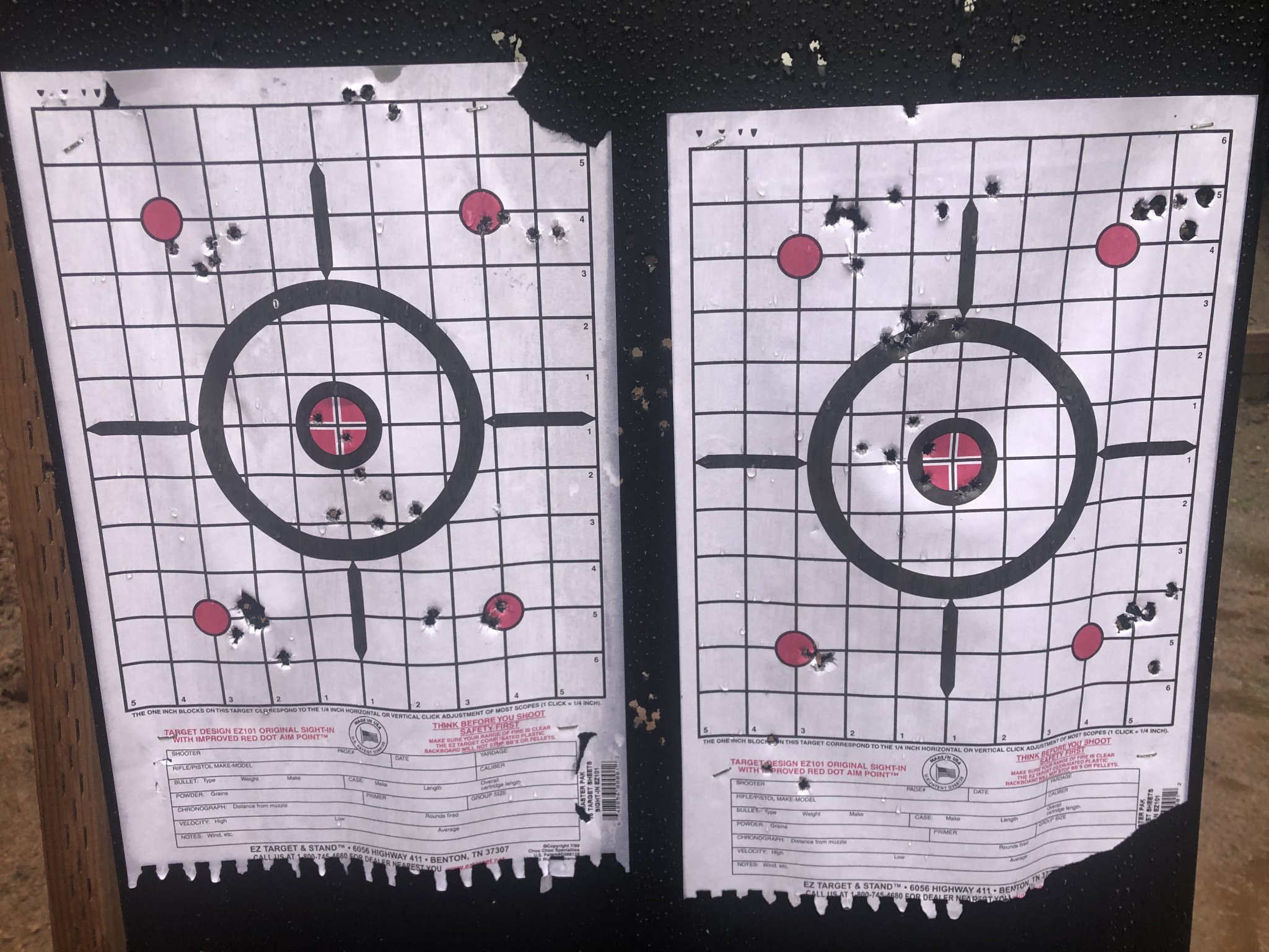

Heres a target from today at 100yds. Left target top left=68.6gr, top right=68.9gr, bottom left=69.2gr all other groups were messing around with new loads for my 6.5 Creedmoor

Best way to know would be to grab a box of another kind of bullet and try it. Although I think your experience with factory Hornady shows it will shoot a diffrent bullet just fine.
Hard to say without having the rifle in hand and seeing you shoot in person. But targets are showing classic signs of recoil management issues.
Very rare to have issues with Berger.
Next time I’m out I’ll try to get someone to video me taking a few shots. Do you think it’s a flinch or just recoil management. I will say that every time I shoot the recoil takes me left of the target, idk if that’s a sign of anything
Could be not perfectly behind the rifle as well as face pressure if you’re RH. I don’t overload my bipod by any means but with light weight magnums it helps to hold onto them and if you can put your bipod into something like the rib on your shooting mat, or grass you can control the rifle better. If you’re directly on concrete with the bipod you have to be perfect.
My guess is that you're not perfectly behind the rifle, if you consistently end up to the left of the target.
