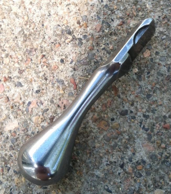

One question I have regarding the Tikka action.
How likely or unlikely is it that the bolt handle would come of? It looks like its hold down by the clamping force of the main spring? Its justed wedged in there, and kept in place by the spring?
I prefer one piece bolts, like a Mauser, Howa and some of the high end customs of lately.
It's highly unlikely that the handle will come off. If you remove the bolt handle, you'll see the precision fit required to insert the handle back to the bolt body. I've abused the Tikka and never worried about the handle. I'm sure if you want to break it you can, but you'll snap the handle first before it slides off.

The inner assembly rotates into place and holds the bolt handle in. It's not held in place with a spring/detent.

cb_tikka: I did not see your reply, but you have assured me some... The chissel like handle should be very secure in the positions you work the handle, up-> back-> forward-> down. Its just another way of doing that seems contradict how conventional rifles have been made..

So, how solid would you rate it?
I'll upload a couple pics to give you an idea of the connection.
In the picture of the Bolt Handle you can see a crescent shape that is used to hold the handle in place
In the picture of the Bolt you can see how beefy the dovetail is which holds the Bolt Handle, and you can see the steel shaft that locks the Bolt Handle in place.

The Dove tail on the bolt handle is strong on the T3 bolt. It would never come off. Finding a rifle builder that is willing to barrel a T3 is a little more difficult but chad Dixon from Long Rifles Inc does a great job and did a great job on mine. I run a lot of different actions like 700's, custom 700 platforms, the t3 is just another way to skin the cat really. They are silky smooth for sure! it really all comes down to what pipe is on the end of it and who does the work
