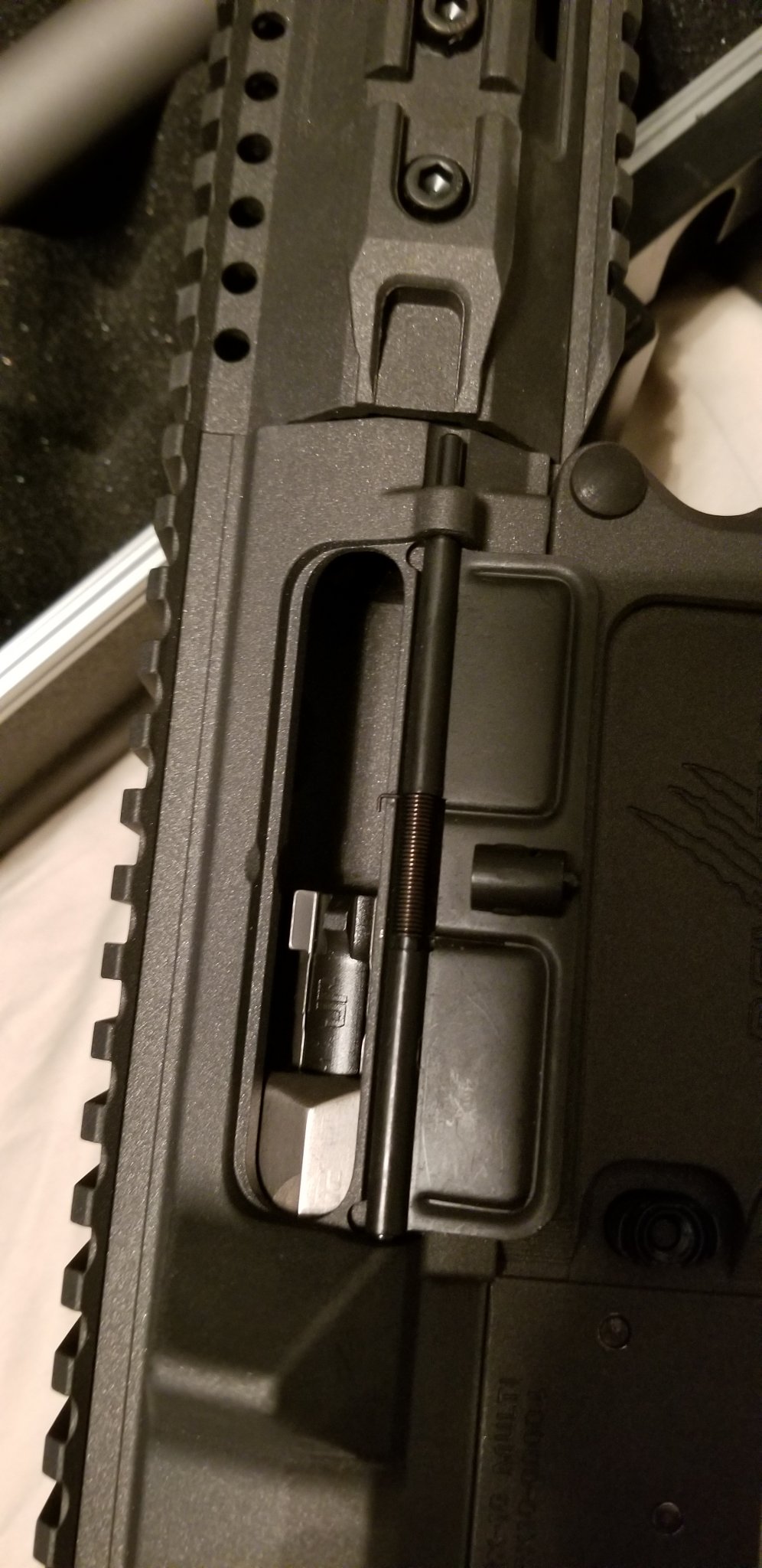

    Nope. This is as far as the bolt will go back before it starts to bind.
