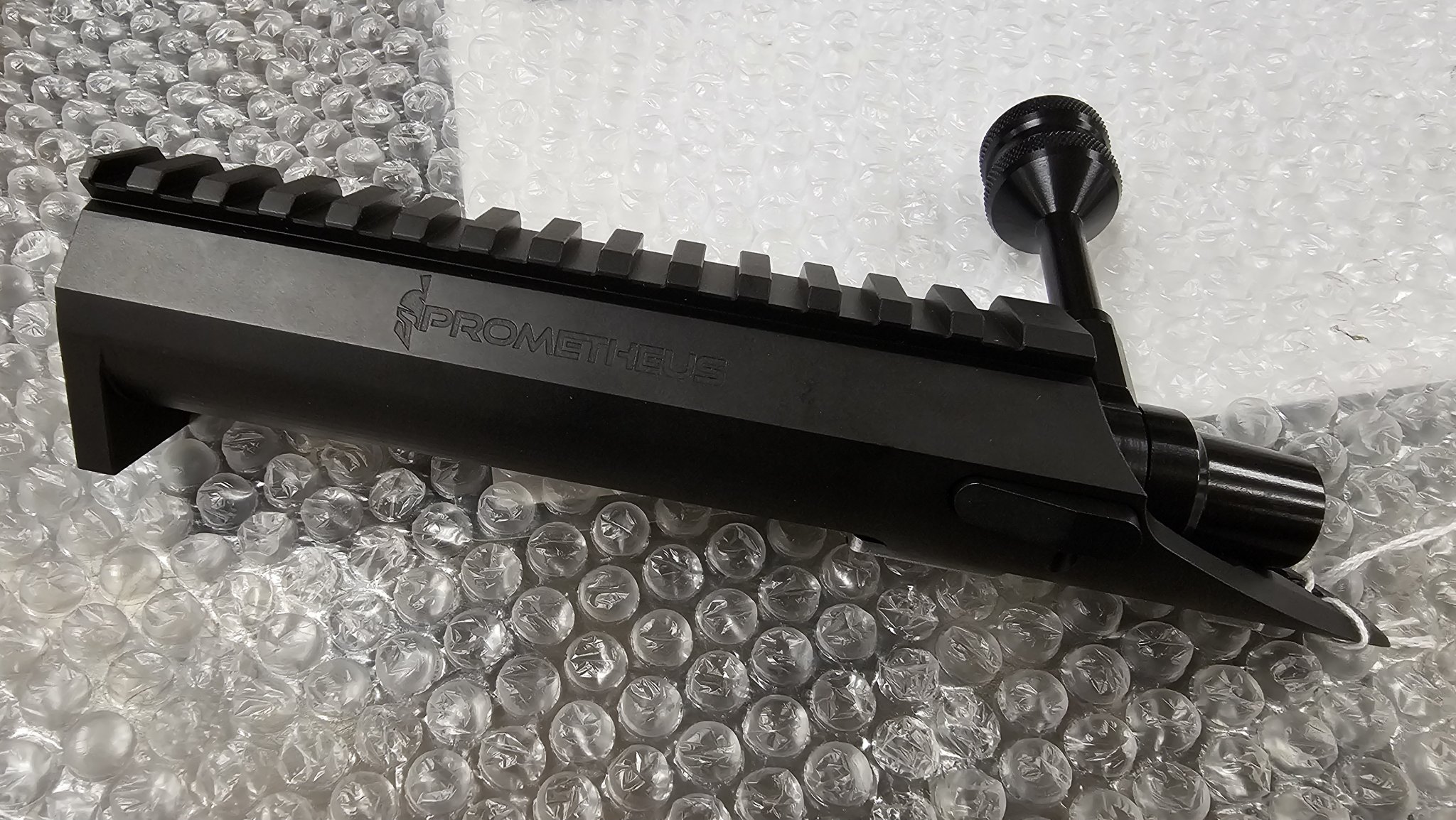

Preffered was out of lh sa mag bolts so I'm curious to hear from others tooBolts arrived today and I did a quick fit and function check without actually swapping over all the internals and firing pin assembly.
I really like the shorter throw but it is noticeably less slick/smooth than the original bolt. Not sure if it’s a different coating or something (maybe one of the Kelblys can confirm?) but it’s not even close to how smooth the original bolt is. Much “stickier” when cycling the bolt.
I’ve got 2 Atlas Tacticals and they’re super slick and have been from day one. I do love these actions. I may hold off on swapping everything over until I hear about everyone else’s experience and decide if I’m gonna keep them.
The stickiness can be due to the fact that an original action with it's bolt has been hand lapped to each other. That is what makes a Kelbly so slick. The new bolt will take some cycling to wear in all the contact surfaces and smooth out. If it doesn't get as slick as your original, we would be more than happy to lap the bolt to the action for you and send it off for BlackNitride.Bolts arrived today and I did a quick fit and function check without actually swapping over all the internals and firing pin assembly.
Perfect, ordered a seperate 308 bf from Preferred.

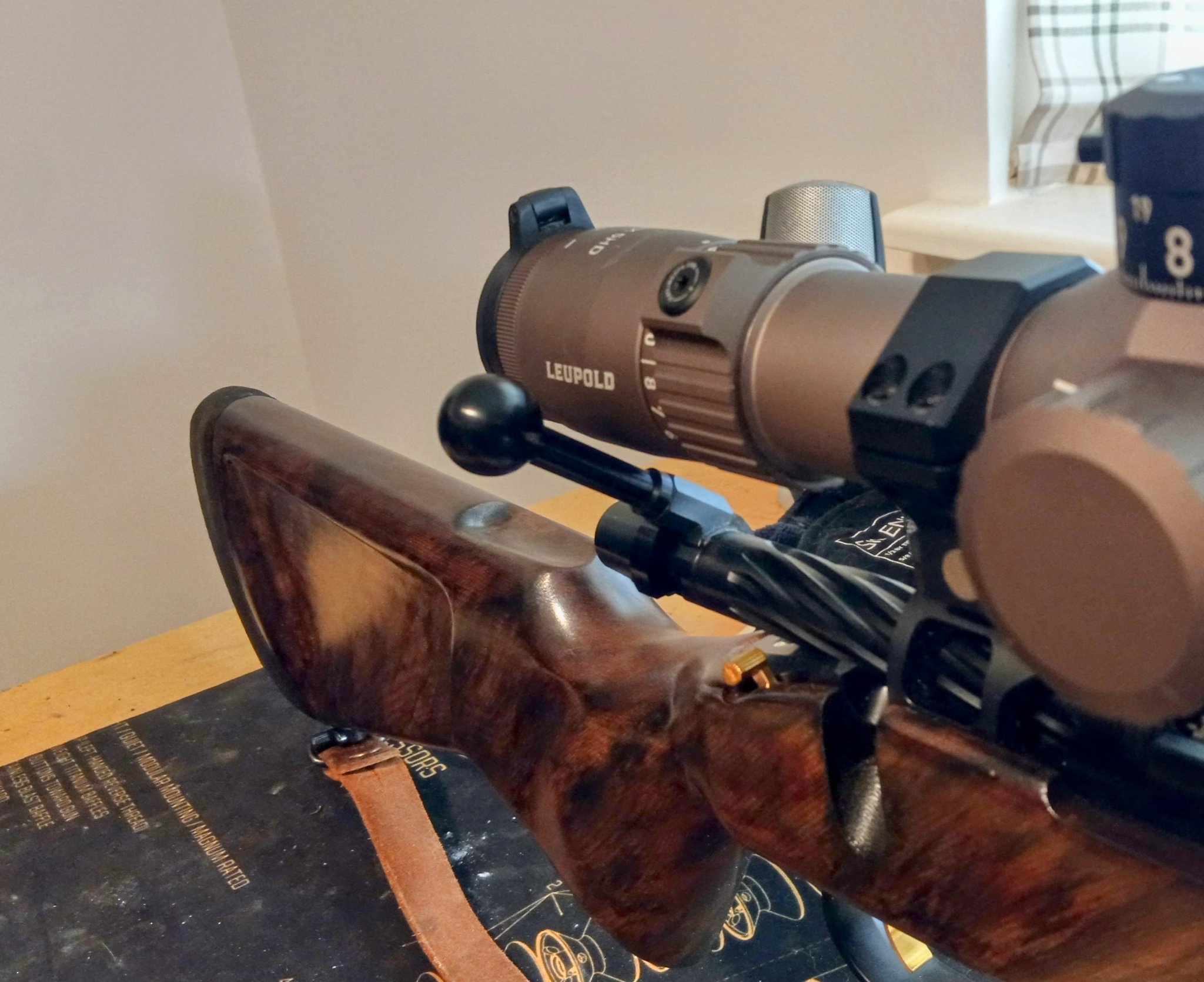

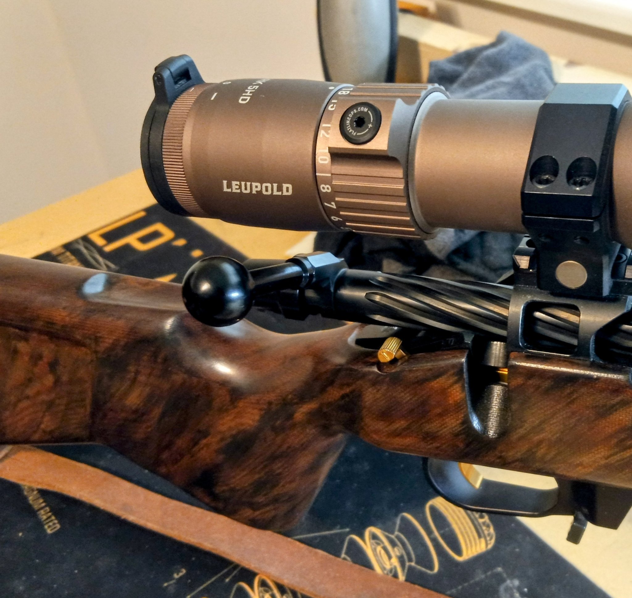

Sweet sweet setup! Enjoy it! Thank you for uploading more photos.By popular request...

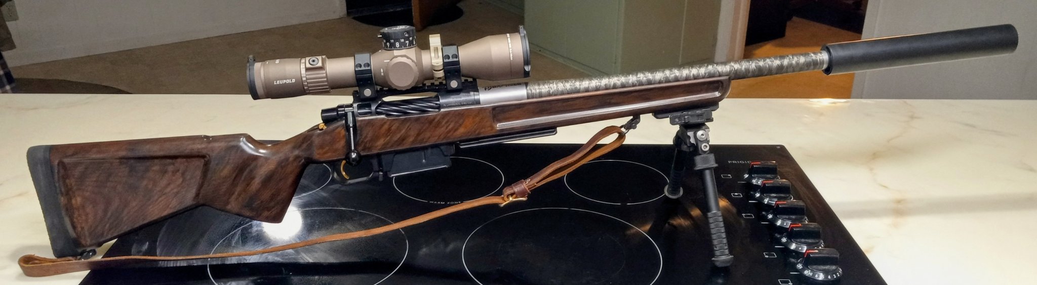

Atlas lite, Preferred CF 22 Creed, Foundation Revelation, Leupy 3-18. I currently use it as a loaner for hunters at our place. Excellent setup.
Great rifle. I believe that's the Dominion stock.By popular request...
You are correct. Fixed it.Great rifle. I believe that's the Dominion stock.
Is that an Allen Engineering suppressor? If so, which model?By popular request...
Atlas lite, Preferred CF 22 Creed, Foundation Dominion, Leupy 3-18. I currently use it as a loaner for hunters at our place. Excellent setup.
