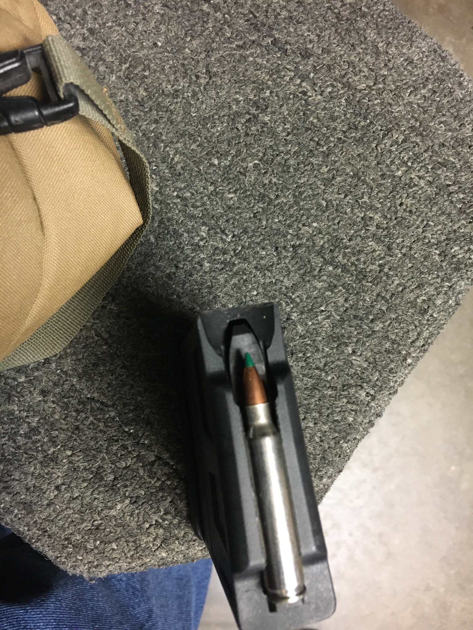

RPR MAG is proprietary but allows you to seat bullets much longer than norm mags
