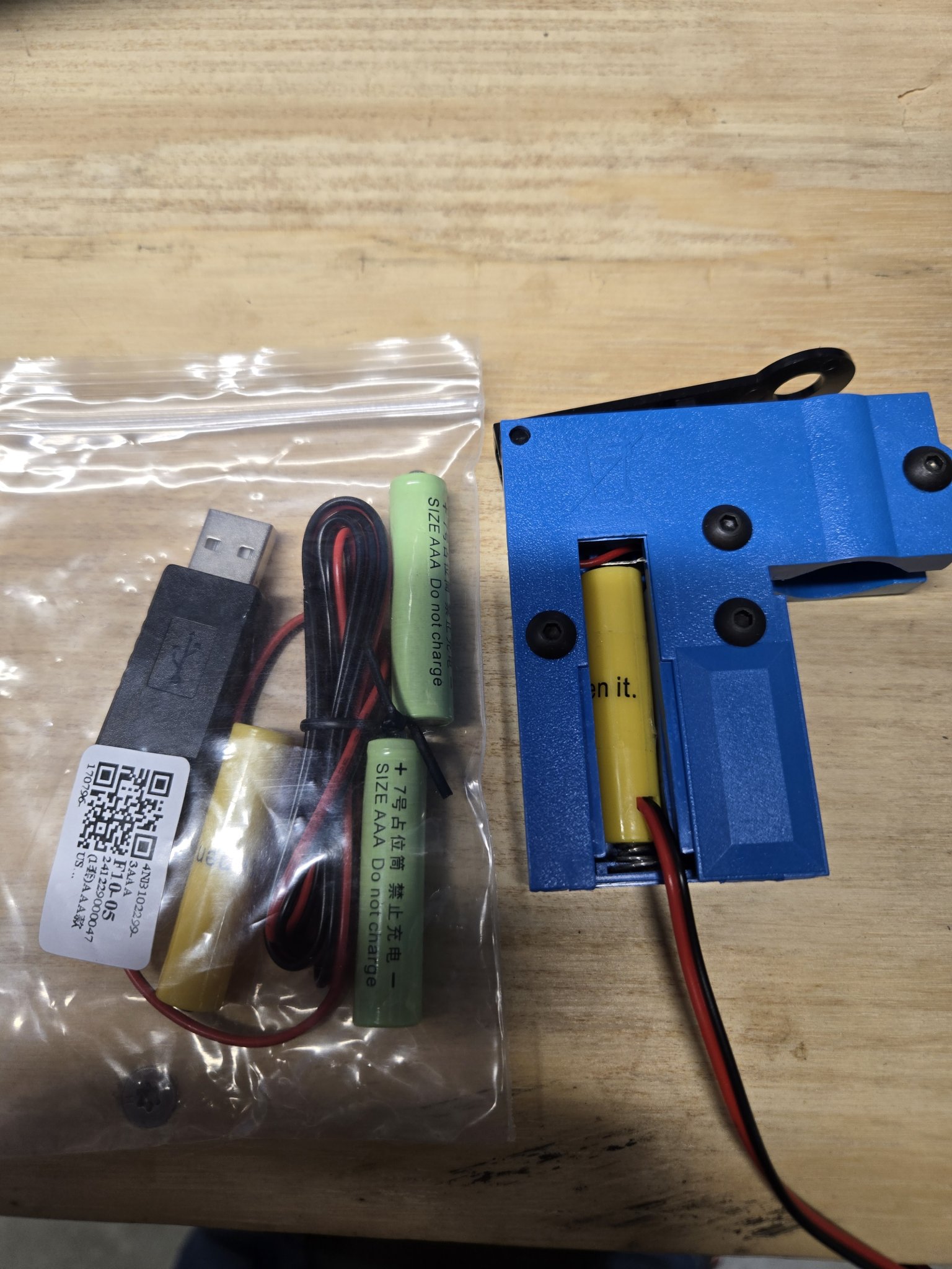

    At $3.99 a copy, you can't afford to NOT try one. I took all of mine apart and hardwired them back into my Autodrives. Even that wasn't difficult. Did require a little soldering though.

    Ahhh, gotcha. Yes, actually I did wire them (powder checkers in station 3) back to the Autodrives. Wiring them wasn't difficult either.
