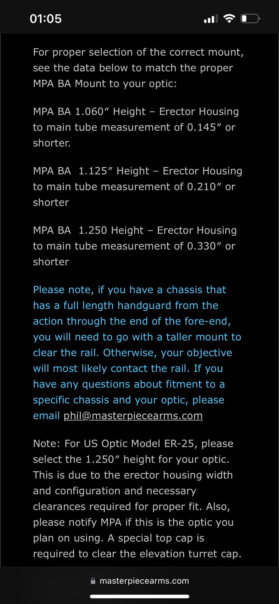

Anyone have a 1.5” mount, 50mm obj, and MTU or similar barrel?
akmike47
Rumpleforeskin King of the Poors
  • Feb 23, 2013
    11,692
    44,593

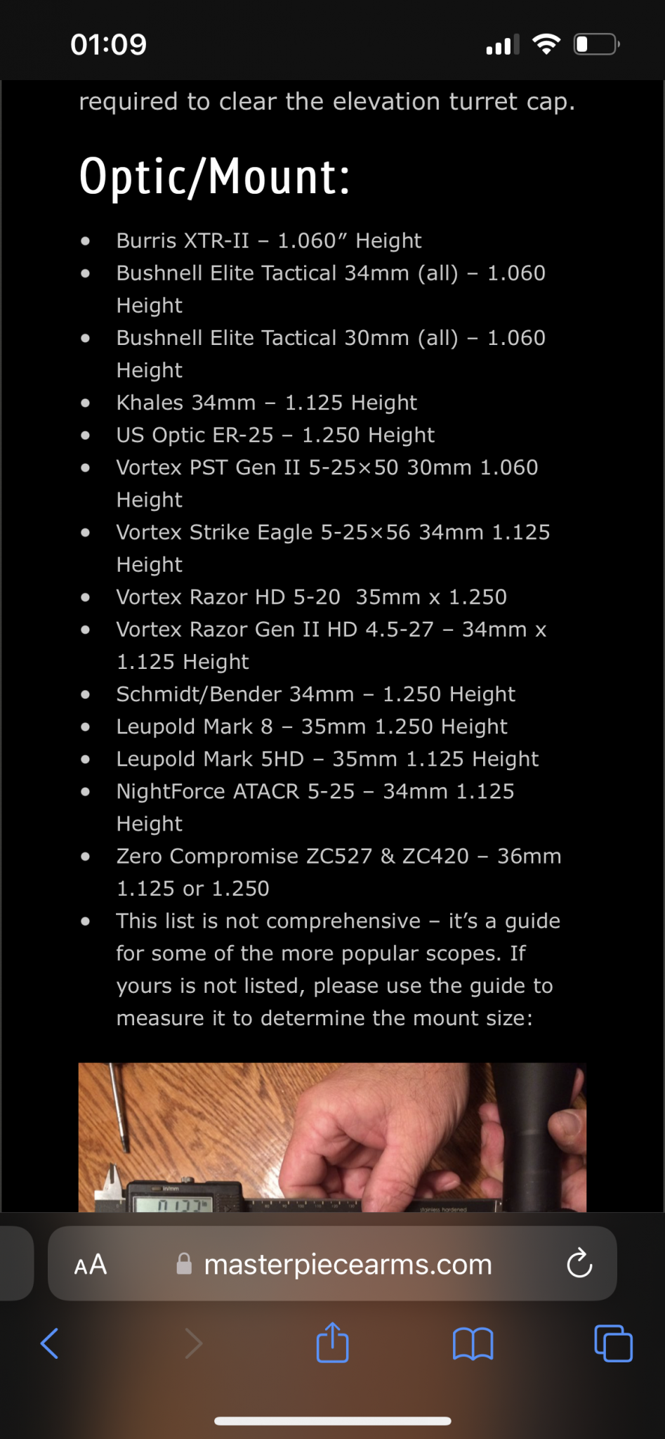

    I think I may need a 1.5” mount for my rifle, but don’t really know. I don’t want it to look stupid as hell either or hender me on barricades, I’ll be in pain instead.

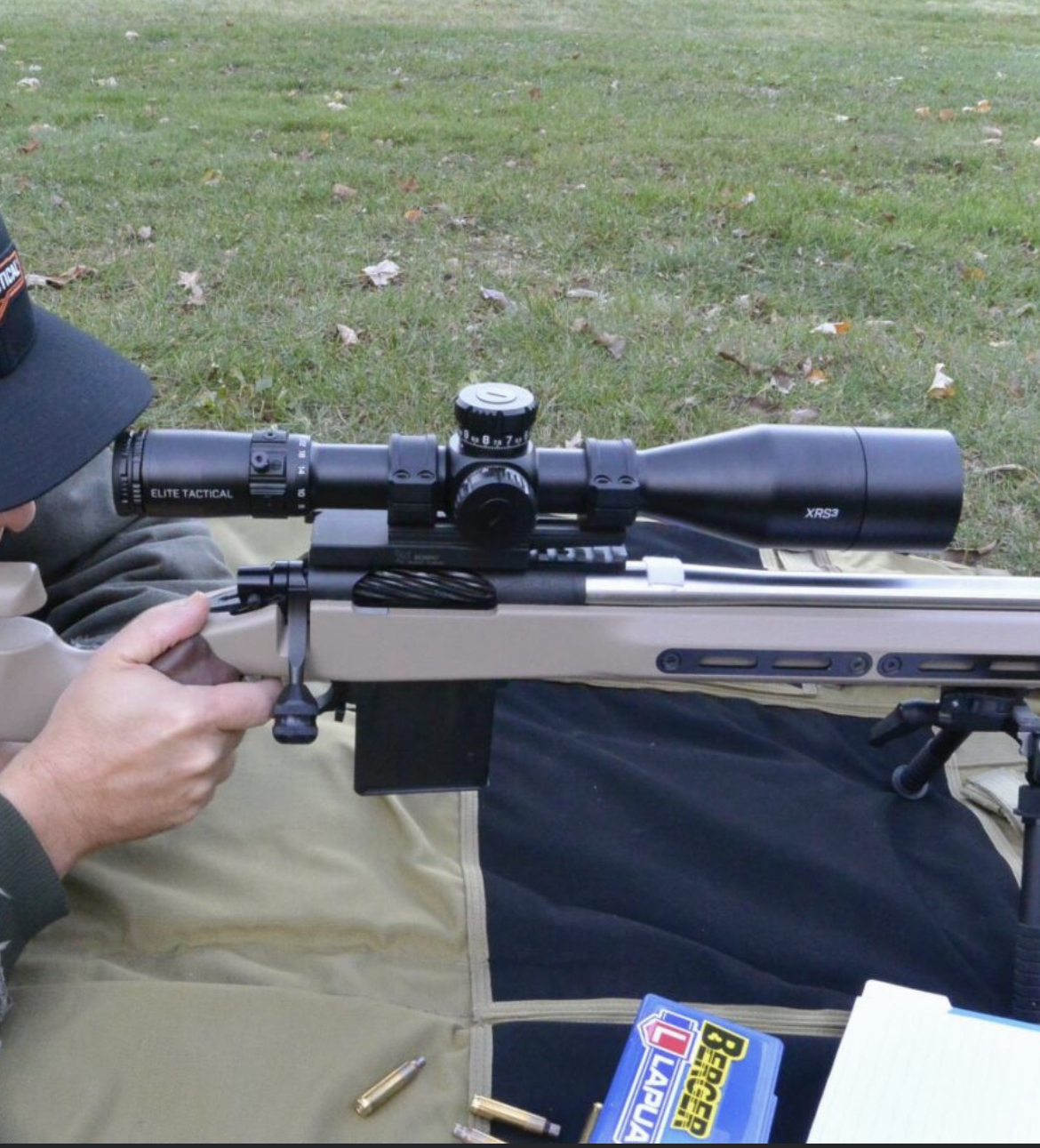

    Its a long shot but does anyone have a picture your rifle with a 1.5” mount, 50mm obj, 34mm tube, and a near MTU contour? Have trouble shooting through barricades with the height?
    Thinking about saving up for a SPUHR but not sure if I should get a 1.5 or 1.35 and there’s nowhere that stocks them around here.

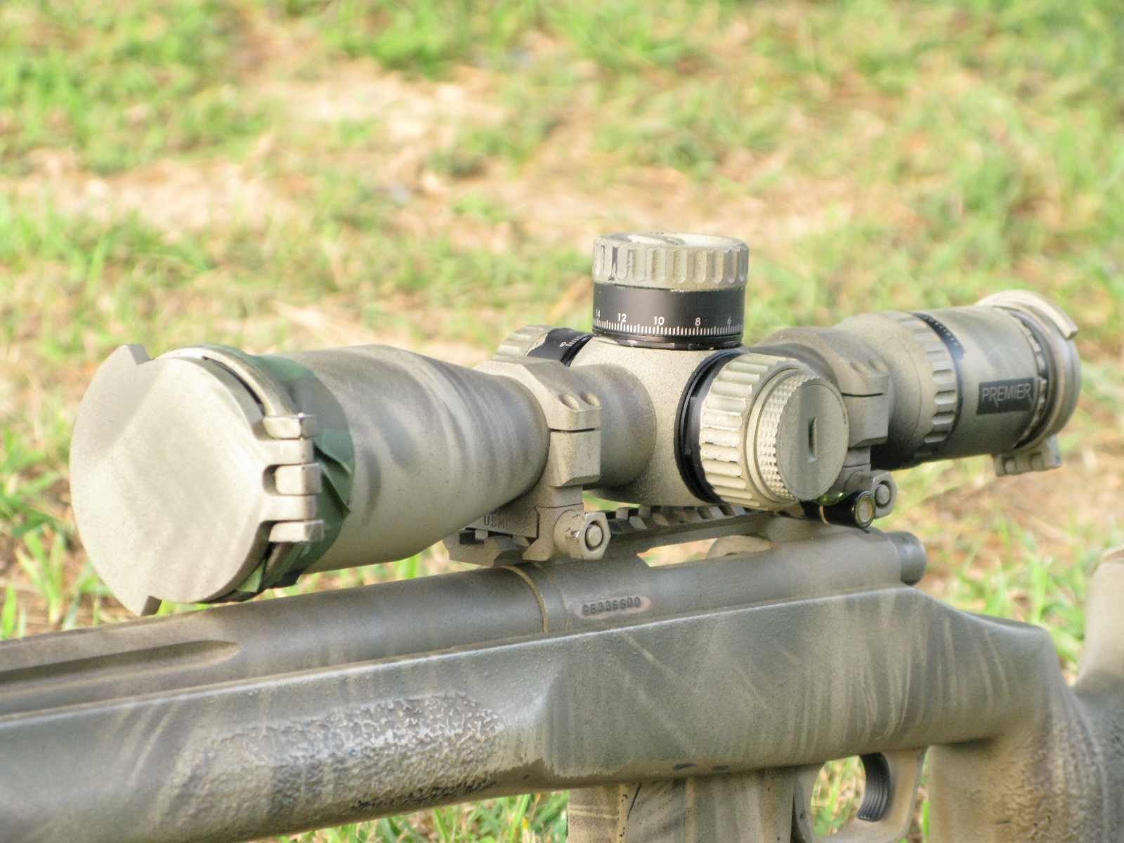

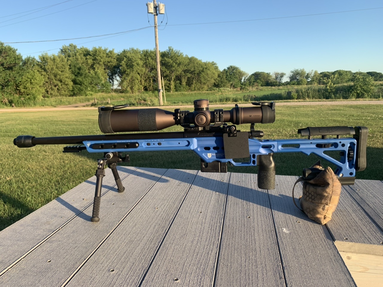

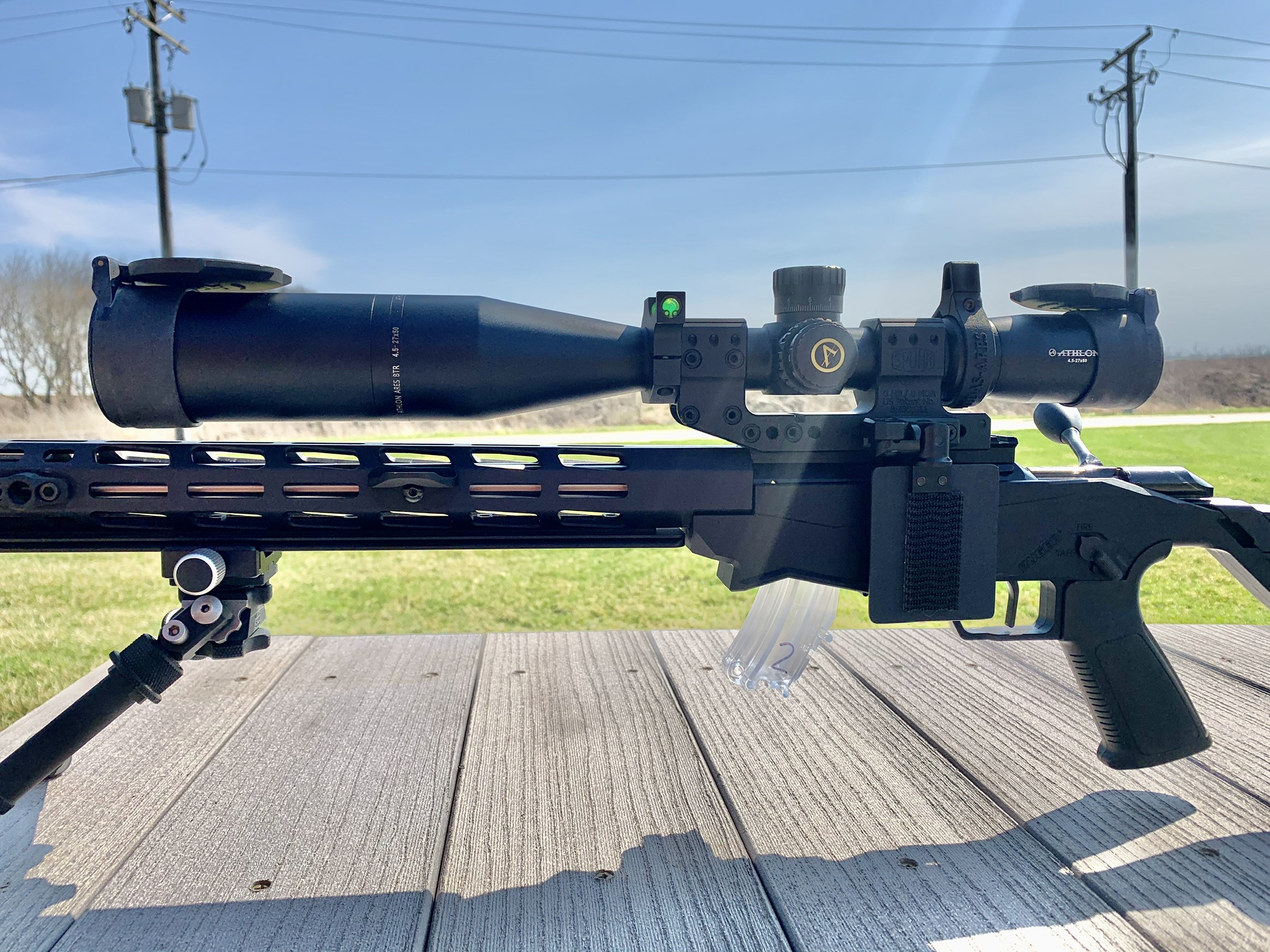

    Unless you're using a chassis system with an enclosed forend you should be able to get by with a 1.0" ring height with that optic you described.
    S&B 3-12X50 in Badger 1.0" tall 34mm rings
    Premier 3-15X50 in Badger 1.0" 34mm rings

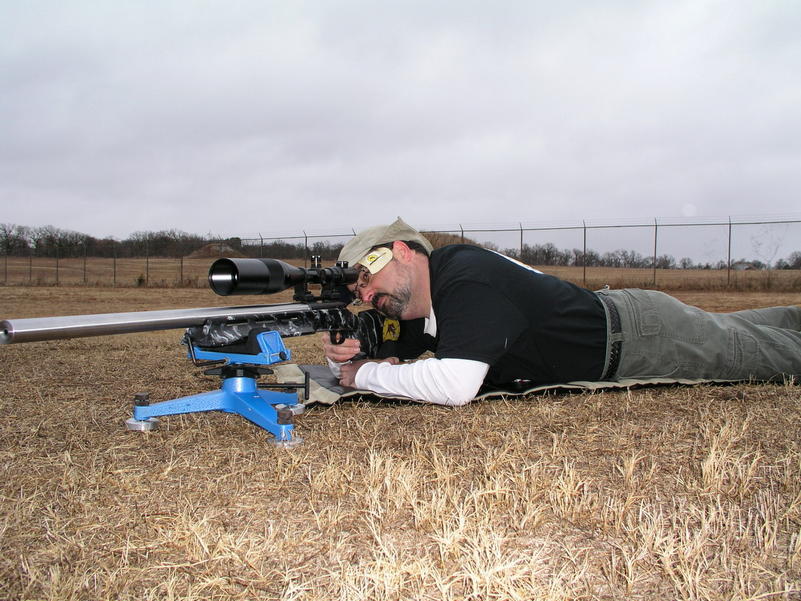

    I know what size you should run, and I have 1" rings. I have a fucked up neck and can't shrug much and can't crank my head over to the side long or at all sometimes. I need a more upright head position, I've already dropped my recoil pad about 1/3 down or more and I'm still having issues and obviously that's not ideal. I also have a acc almost as long as it'll adjust to fit my LOP if that lets you know my size.

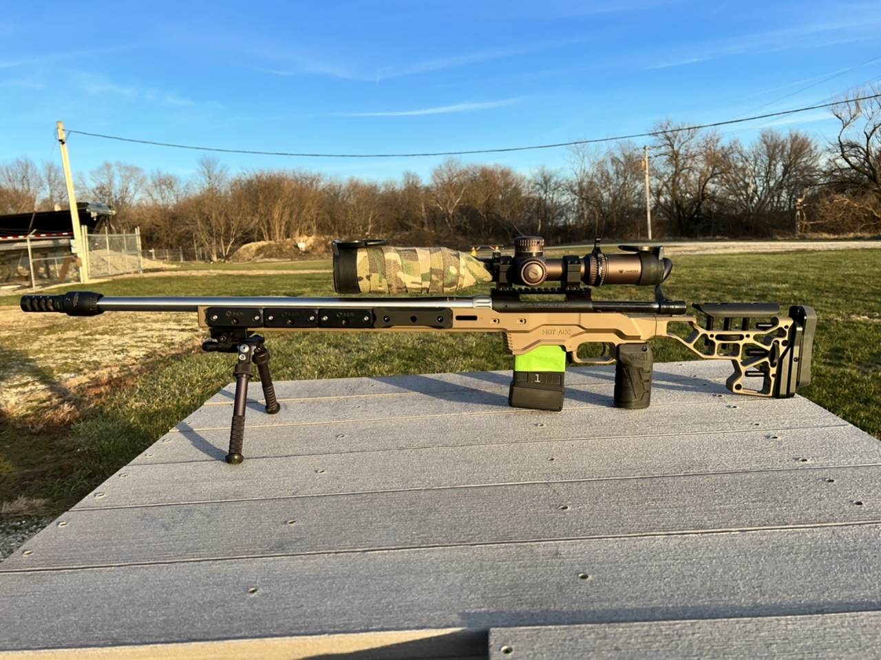

    This is my Vudoo with a MTU contour with a 56mm objective and the 1.125 mount to give you an idea of the clearance. I will see if I can find a picture of a 1.5 spuhr mount and 50mm.
    Thanks, I've been looking and can't find much it mostly just pops up 1.5 mounts on a table top
    Mostly Fudds at the range here and the local PRS spot is members only and usually empty when I get to tag along.
    Yea 1.5” and 50mm would be pretty high without a handguard.

    Pretty much all my optics are in 1.5" mounts (though mostly 56mm objectives) as some of my rifles (PRS rigs, practical rifles, gas guns) have full length pic handguards or NV bridges and some don't and I like to be able to swap optics around sometimes.
