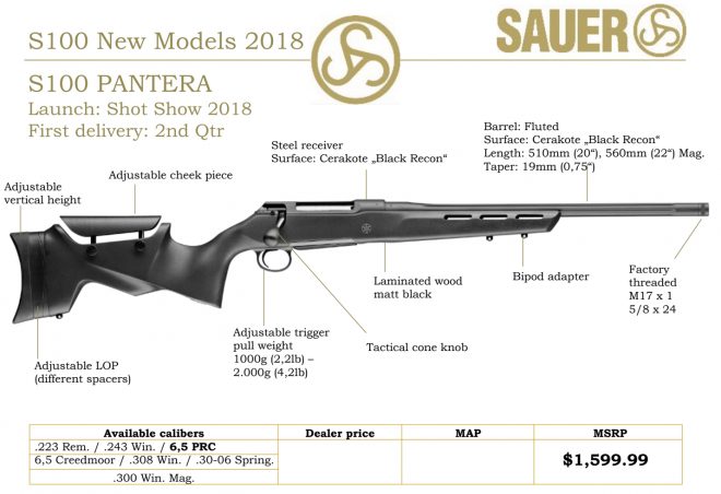

Anyone have a Sauer 100 Pantera or Fieldshoot?
redneckbmxer24
Banhammer
Banned !
  • Jan 15, 2005
    12,568
    9,813
    Gulf Coast, FL
    Thinking about buying one of these in 6.5PRC, probably leaning towards the Pantera since they're threaded and a hair lighter. Also considering 300WM in the Pantera.
    Some questions.
    1. Hows the action? Is the bolt lift smooth? Any binding or feeding issues? Positive feeding and extraction? Anything negative you'd point out?
    2. If you have a 6.5PRC or even 6.5 Creedmoor with the 8.6" twist per their specs, or a 300WM with the 1:11, how is it shooting and with what bullet? This is probably the greatest concern to me, not sure why they wouldn't use a 8 twist in the 6.5 and 10 in the .30. I'd like to be able to run the 127gr LRX in the 6.5 or the 200gr LRX in the 300 both of which call for 8 and 10 twist and are solid copper which generally requires a faster twist than the same length/weight lead core bullet. I think the 6.5PRC would run the 127gr fast enough to work but the 11 twist with the 200 is concerning.
    3. Hows the trigger for adjustability? Is it fully adjustable for sear, overtravel, and weight?
    4. Hows the stock? It looks like the grip may be a tick further from the trigger than your typical vertical grip stock. Does the cheek piece hardware lock up tight? No issue with it coming loose and dropping down? Is it KMW style? Is there enough meat on the side of the forend to install a left flush cup? Is the forend stiff? Any sort of bedding system? If not is there any issue with bolts loosening up in the cold?
    Overall how do you like the rifle and what do you really like about it, and what do you dislike or would change, if anything?
    Anyone in the Winchester, VA area with one that would be willing to trade trigger time on one? I've got more than a couple interesting rifles someone might want to play with.
