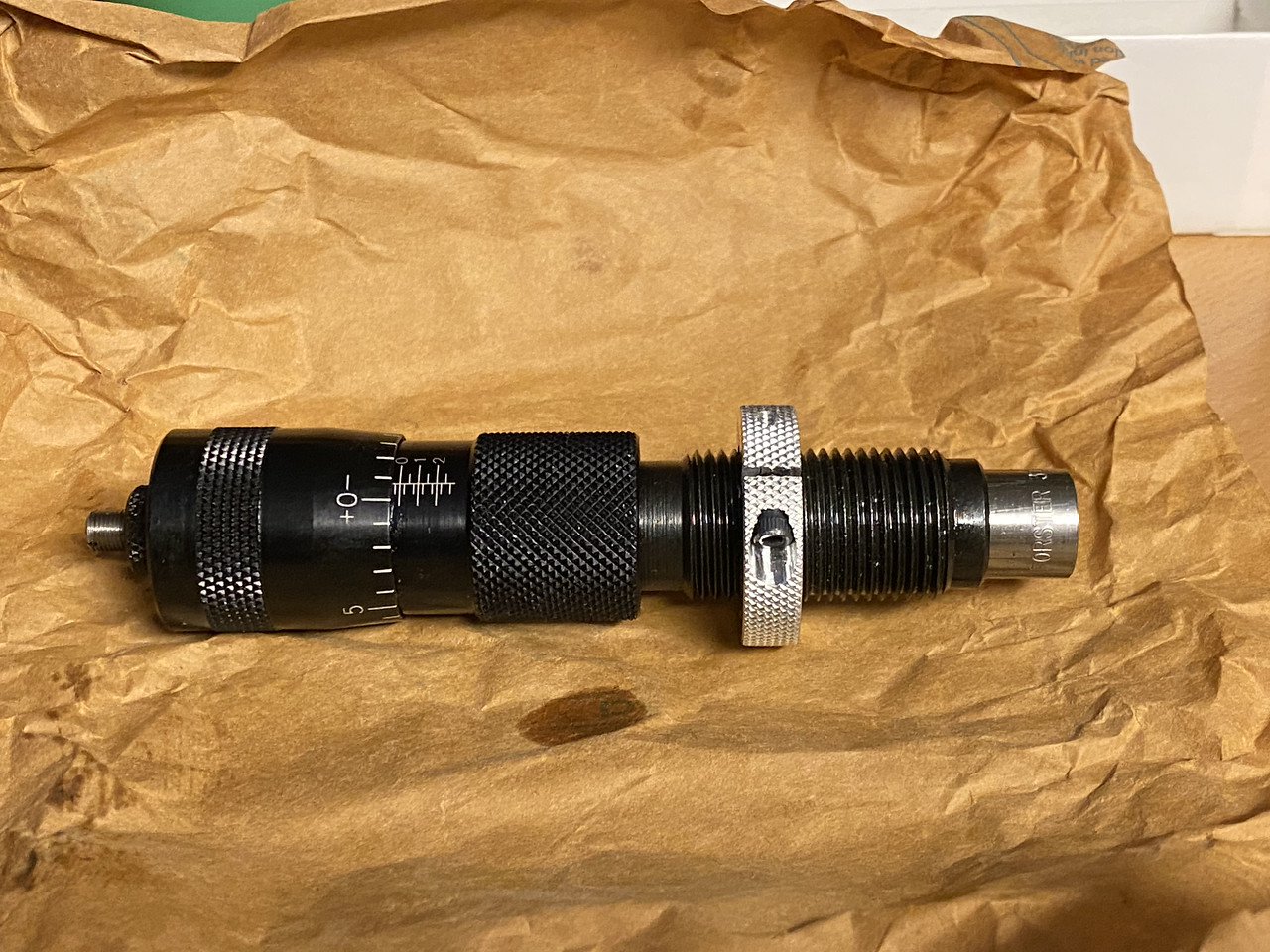

I was looking for a micrometer seater die and found plenty of recommendations for the Forster Ultra, seemed to check all the boxes so I ordered one.
Well, it arrived this afternoon. Looked okay straight out of the box but the threads were a bit rough running the lock ring, I put a bit of oil on and it smoothed up some. Started threading it into my press and it started getting tighter and tighter until about half way in it stopped, I had to tighten the ring and crank on it to get it out of the press.
My cheap Lee dies are smooth as butter, as is my Redding full length. I'm assuming this is not normal.

Odd. Hard to tell from the picture, but is there any finish wear on the threads? It is possible that the finish is a touch too thick, either on your press or the die or both.
It doesn't look overly thick just eyeballing it but honestly before oiling it I've felt smoother threading on Chinese garbage, after it's still rough but at least the ring will run up to the top.
All of my other dies are smooth as silk in my press so I don't think the issue is the press.
Both of mine were the same way. Cleaned the threads a little, screwed in and out of the press a few times and all was good.

What press are you threading it into? Could be tight threads on either the die or press. I run a MEC Marksmen and its a great press but I have found a few dies that thread into it very tight, this doesn't happen with my Redding press. Might be because the Marksmen threads are coated and the Redding's are not.
