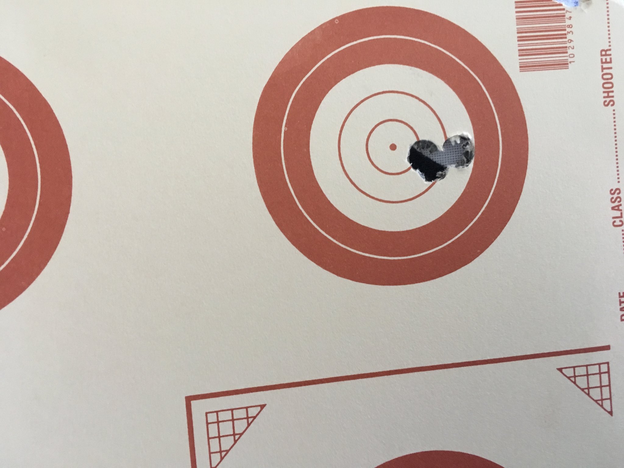

    Finally got a replacement extractor in Aus after a 4 month wait. Dug some old ammo out of the
    locker and went to check zero before some ELR next week.
    This is 3 shots with the 230, out of a 9 twist Bartlein, after over 1000 rounds down a 300 NM Imp.
    Love the 230 Berger, tunes easily and seems to run fine in my rather tired barrel . Some impromptu
    off roading with the rifle in the back seems to have moved the zero a click tho : ) .

    What powder are you using?
