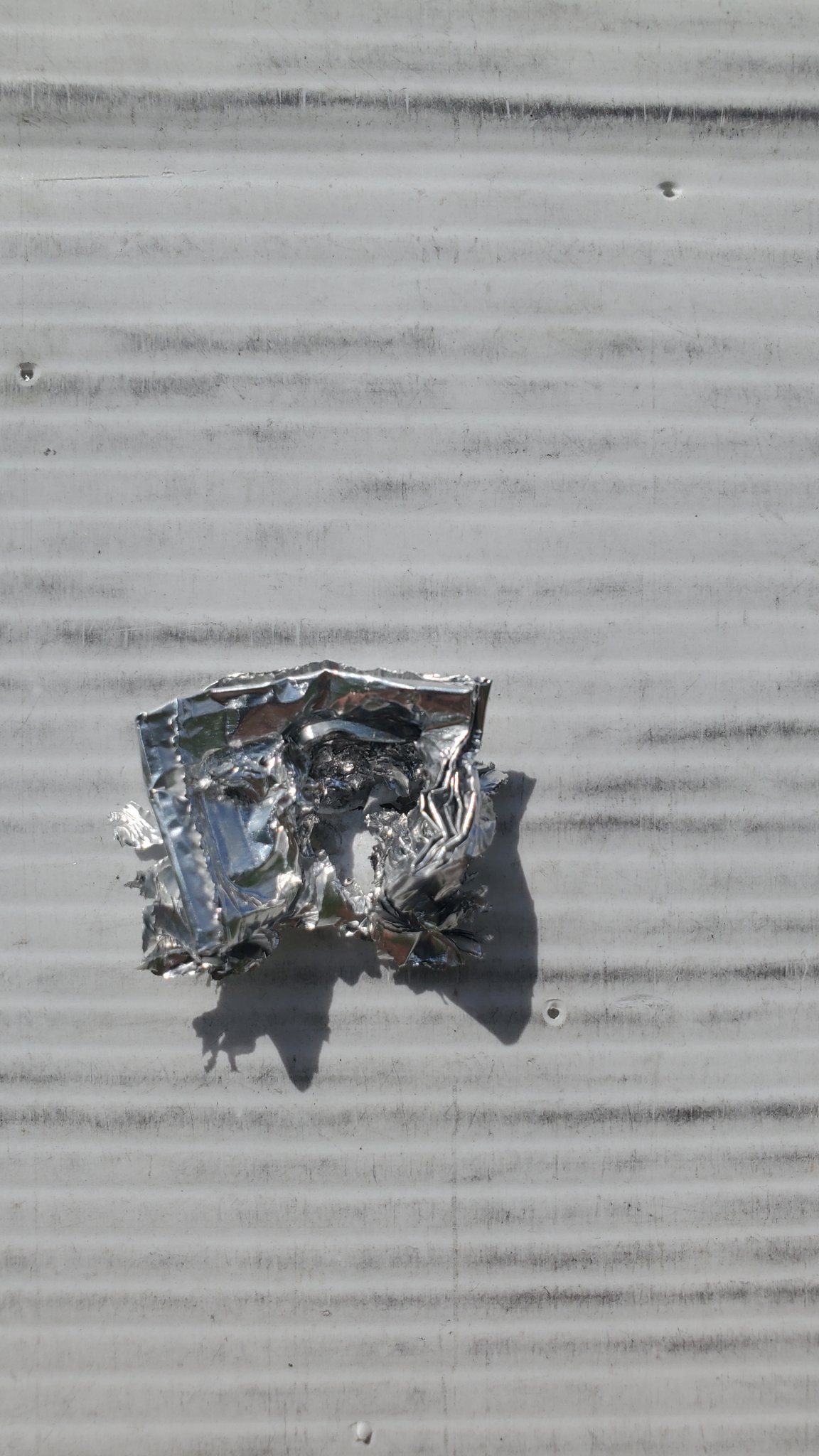

i bought a trail for thermal night use. I also watched alot of reviews on it and most of the guntubers were using green tip and other shit ammo. A few were using decent ammo but we're shooting from a card table with shit rests. Here's mine, confirming zero at 65yds(gives me a mpbr of 265 yds without being over 2.5" over/under crosshair). These are 50gr vmax handloads that is good load in multiple 223 rifles, not tuned for this rifle. Foil is .75x.75"
Reactions: Mean_Man
