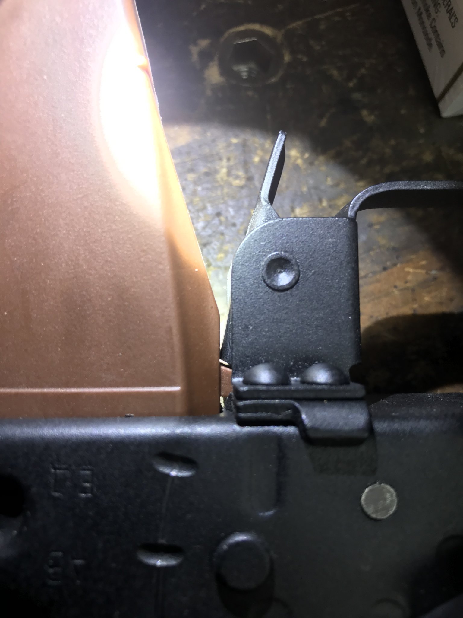

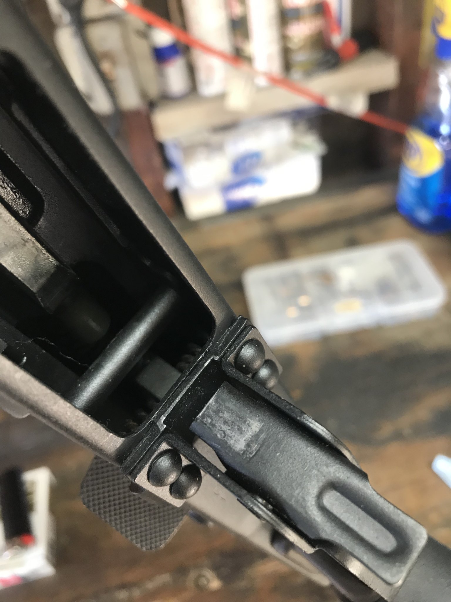

    can you take some pics? In my search I’ve read a few problems with the rails being off on childers receivers.
    If I push upon the mag it feeds fine. If I let the mag hang I get bolt over rim issues. I’m using Circle 10 mags. These are pics I took while talking to the builder when I was having issues. I don’t have the rifle because it’s with the builder. I haven’t been able to meet with him yet. Still waiting on him so I can get it back. These are the only pics I have right now besides the bolt hanging up on cartridges.
