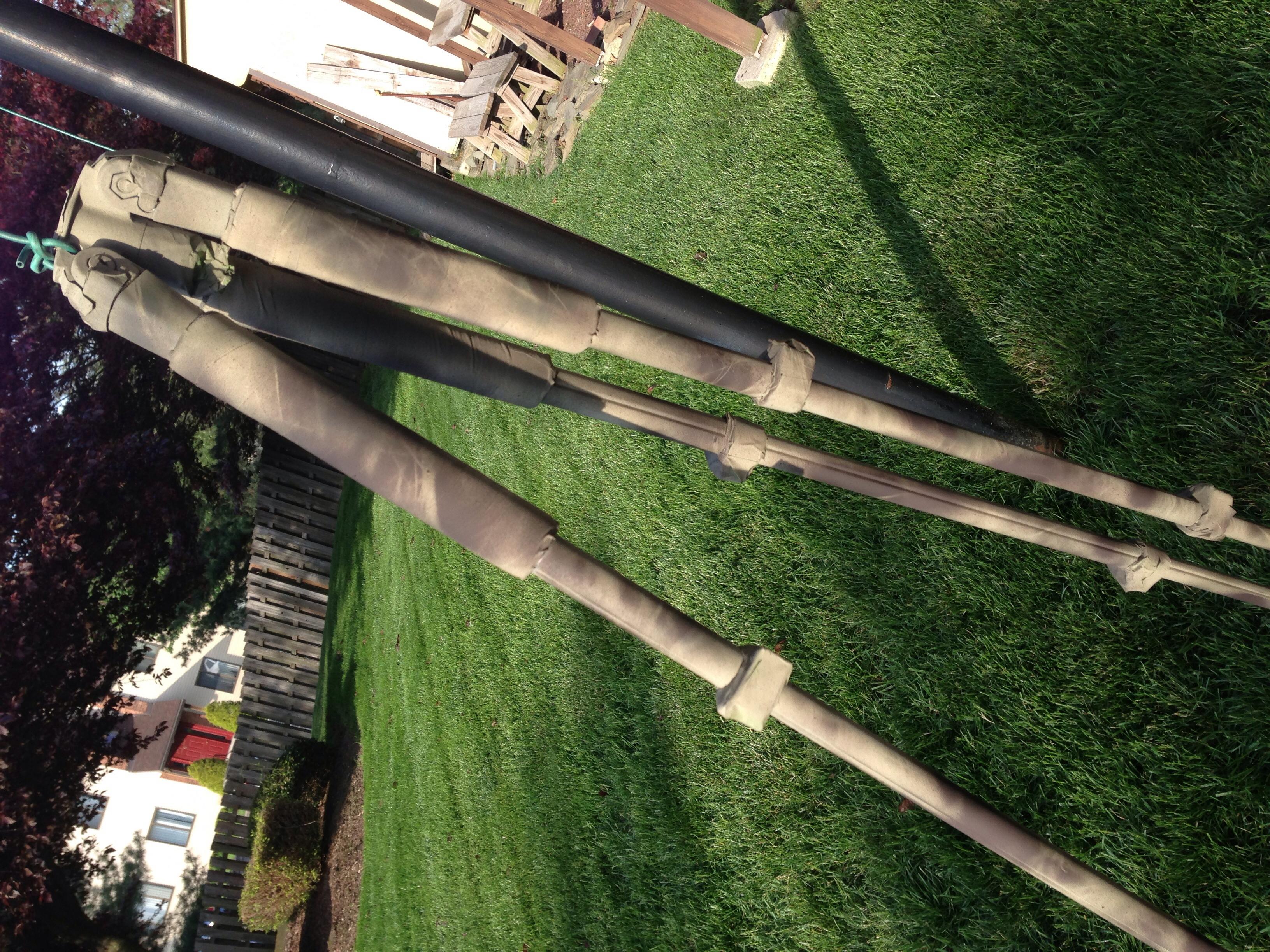

Personally i wouldnt sand the carbon fiber - or at least be sure it is a very light rub. like SRS said, the friction locks will eventually wear the paint, but then since its krylon, its cheap to hit it again. On the hog saddle I taped off my vise pads. Didnt think the paint would hurt them, but for the price i didnt want to chance it. I took some old burlap cofee sacks - sometimes Starbucks will have em - and hit them with a little krylon and tied em into strips and wrapped the upper part of my frotto. helps with the break up when i'm out hunting.

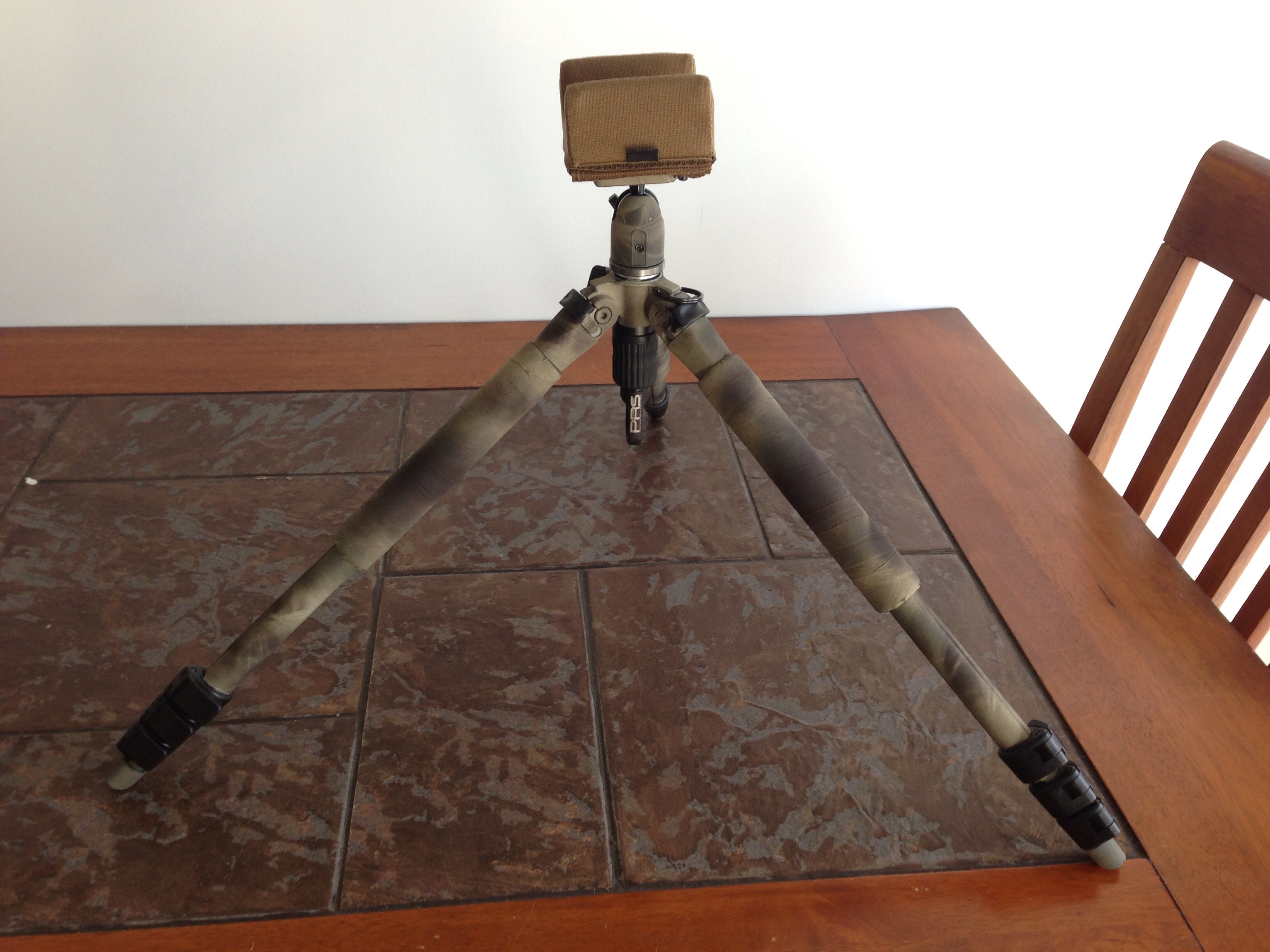

Attached are pictures of my tripod, ball head and hog saddle that Custom Gun Coatings painted for me. I believe he disassembled them before painting them and not sure which coatings he used. The paint on the legs has not shown any scrape marks yet from telescoping them. His handle on SH is Shortbus and you may want to check with him on what coatings he used.

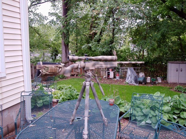

I painted my Tripod and HS Precision Stock
I painted my tripod and rifle stock with "Aervoe" Military Vehicle and Recreation CAMO Paint. They have many colors. I used Dark Green as the base, Earth Brown, Sand and Black. All were flat based. After wiping down tripod and stock, used Dark Green as base then held pine tree boughs along side tripod and stock to add the other three colors for an even mix.
