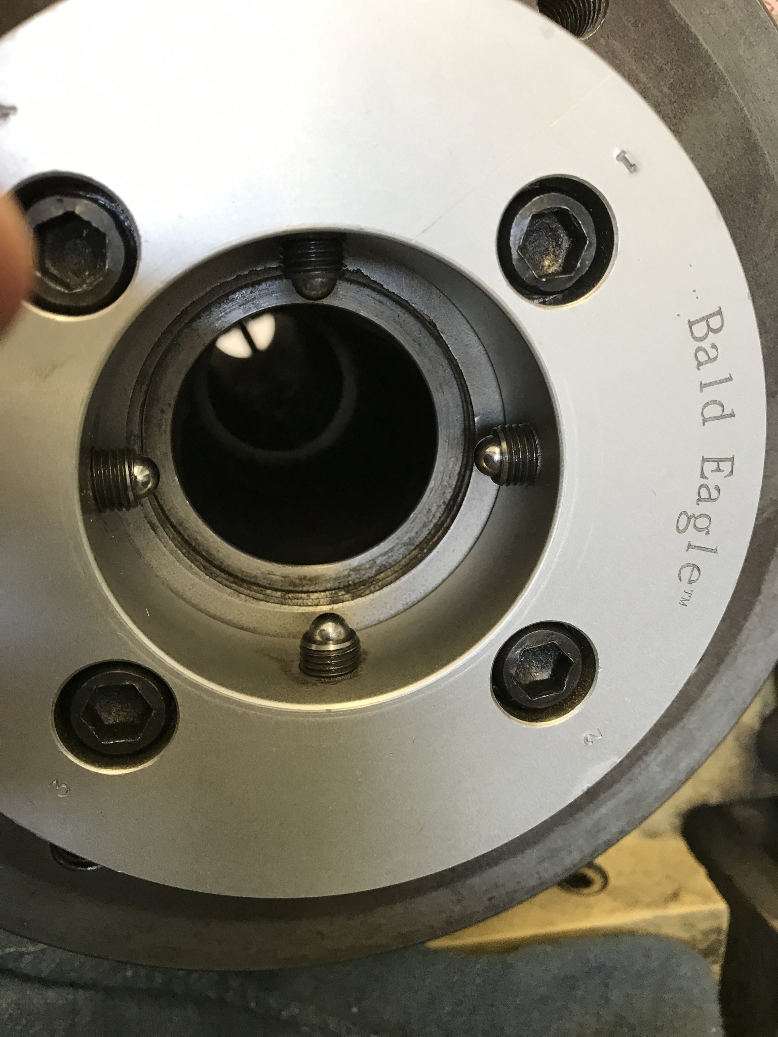

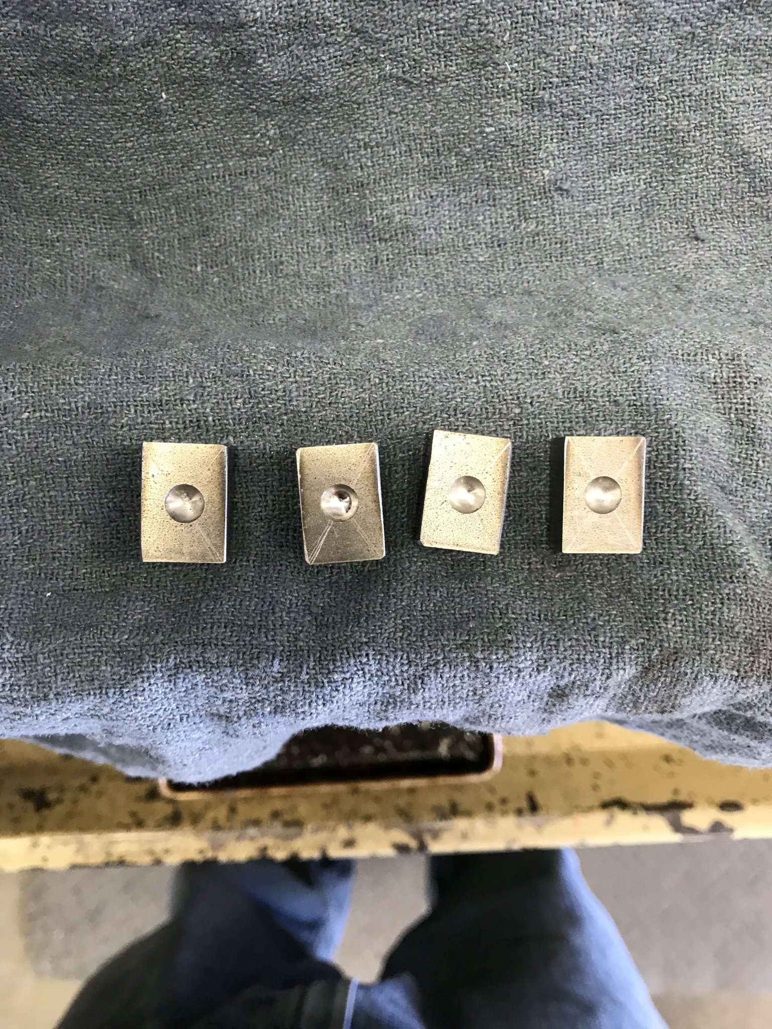

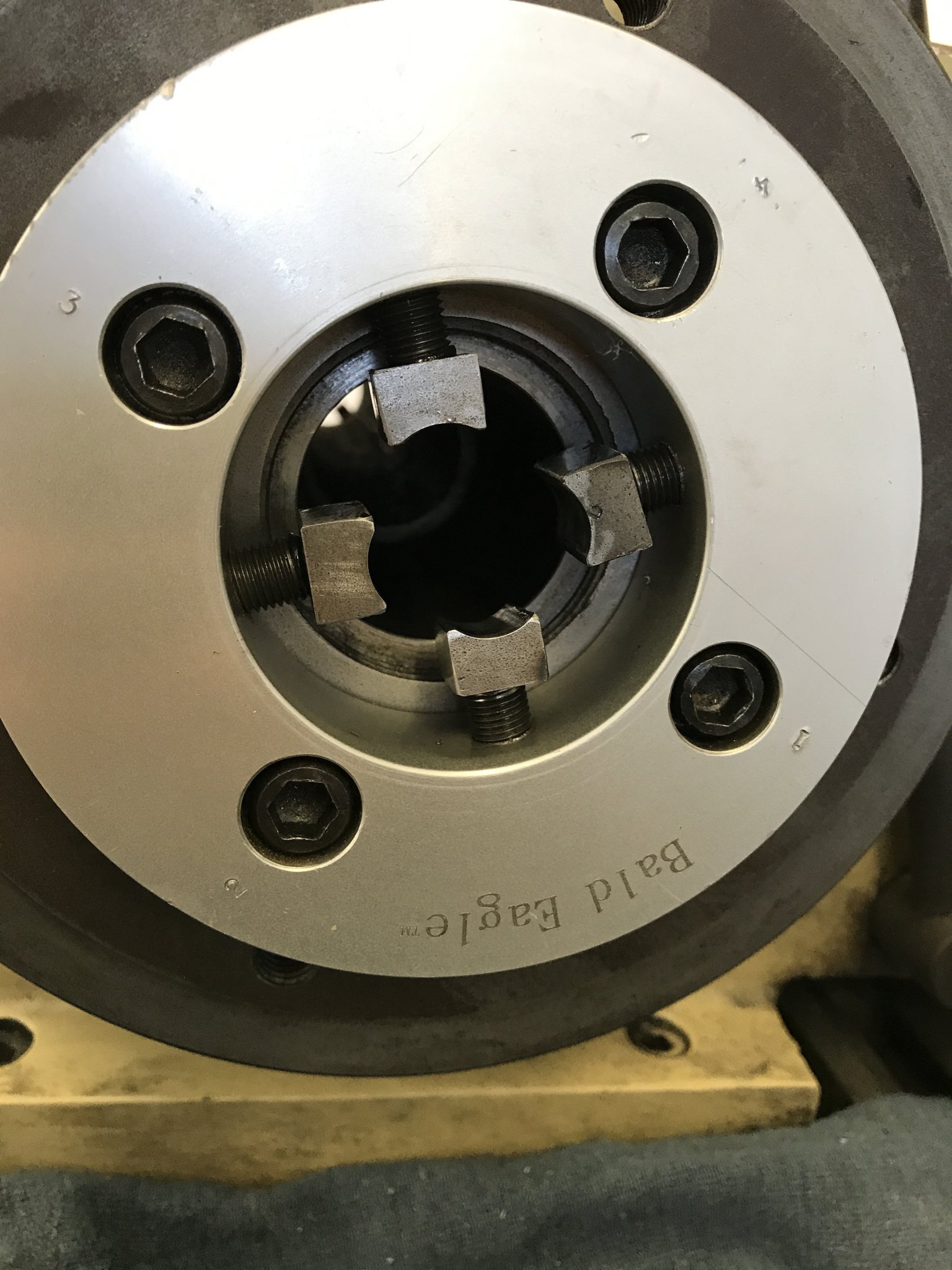

    All steel ball bearing gimbling feet. This has worked well for me for years now. Never had a barrel slip and the setup is rock solid. Got this method from Alex wheeler.
    I use a similar setup as @Danny1788 and works a treat.

    Grease holding the "shoes" to the bearings, or something else?
    Looks like a ball end mill would be use to cut them- how critical is the diameter of the cut to match the barrel? Obviously if it doesn't exactly match the barrel it's only going to contact at the outer edges. Do you have multiple sets, like for 1.2, 1.250, and a few common muzzle diameters or do you find that doesn't affect rigidity of the workholding?
    I'm thinking the female on those cut with a 90* spot drill and it would be better than trying to match the ball, personally.
    Also, on the shoes, I think a vee shape would be better than trying to match the barrel diameters. You'd end up with 8 points of "wedge" contact, vs. potentially only 4 very small contact points if the radius is even slightly larger than the barrel. A vee shape would also be better on tapered sections of barrel.
    As far as the previous comment about drilling in increments, I personally feel going straight to the largest drill that will still allow a clean up boring pass would be best. A core drill is technically the proper tool to open up an existing hole, but sometimes we use what we have, or make compromises to allow the use of a single tool for multiple applications. I pre-drill all standard bolt face and larger calibers with a 140* 11mm carbide drill. I can't even remember when I changed it last, but I'm sure it has a couple hundred barrels on it. Non-magnum chambers take a single boring pass, and magnums take two or more. I want the body of the chamber to cut like a reamer, and then when it gets there, let the shoulder forward act as a form tool. This nets a really nice and true chamber, and saves miles of cutting on the leade/FB. Yes, the outer edge of the shoulder will wear on the reamer, but if you lose a couple/few tenths on the shoulder diameter, probably NBD. Lose a couple/few tenths in the freebore due to reamer wear, you're going to start having issues. This is a non-issue for most since the reamers typically last indefinitely for the home user.
    My guess is something in your setup probably moved after boring, if you ended up with runout in the finish chamber. I would think you'd notice if a boring bar didn't make a full circumference cut.
    I've had great luck with brass tips on outboard spider and "L" shaped thin aluminum stock on the jaws holds everything securely. I normally do very little set-up until after pre-bore. Once I've drilled the majority of material away, then I'll dial the bore in measuring with a long reach dial in the "to be" throat area. Then I will use the boring bar to true the hole. I also periodically reconfirm my tailstock trueness at a set torque, so that I know the reamer is true to the chuck/work piece. Seems to work great at keeping things true and minimizes wear to the reamer.
    Agreed, thanks. No different than a v-block setup in the mill when I think about it... I've got a small 90 degree end mill that would be perfect for the blocks and the female holes on the back side.

    I did not have a mill at the time i made the shoes or i would have cut them in a V shape. They are .750" Radius and hold the barrel shank with 8 contact points evenly. They dont work for small sporter barrels muzzles. I have a 6 jaw set tru that i mainly use now.
