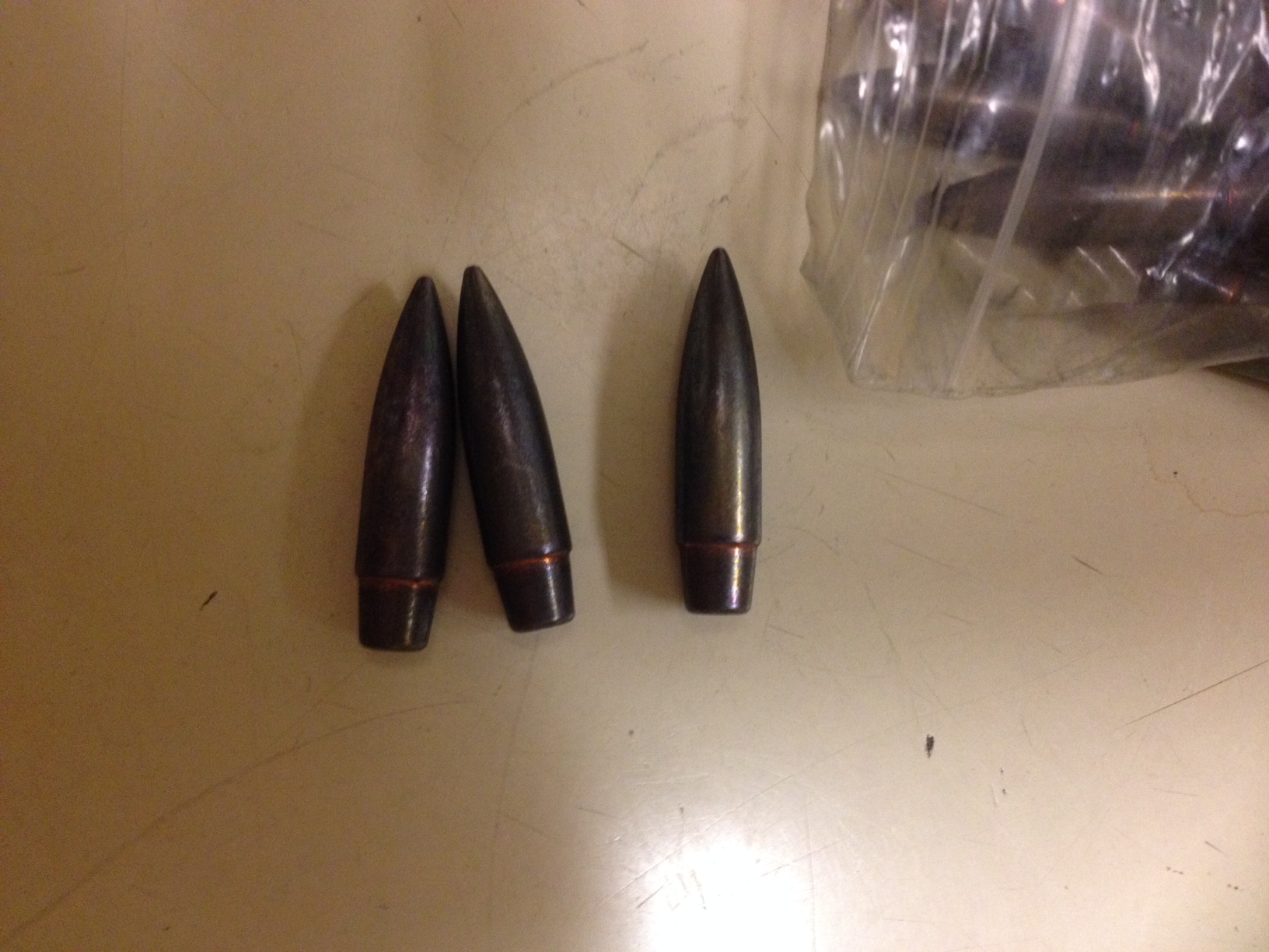

These are Lapua's I had laying around for years.

IIRC the difference I seen between a rebated 175 vs a Sierra 175 MK or Old style Hornady 162 BT in a 7mm rem mag was like 3-4+ minutes at a grand in Florida long ago. The thing I enjoyed about them is they would go toe to toe with a flatbase for 300 and in. So one bullet did it all. Rebated bullets were even used in 7.62X54R ammo by the Finns to reach out and touch Russians long ago.
