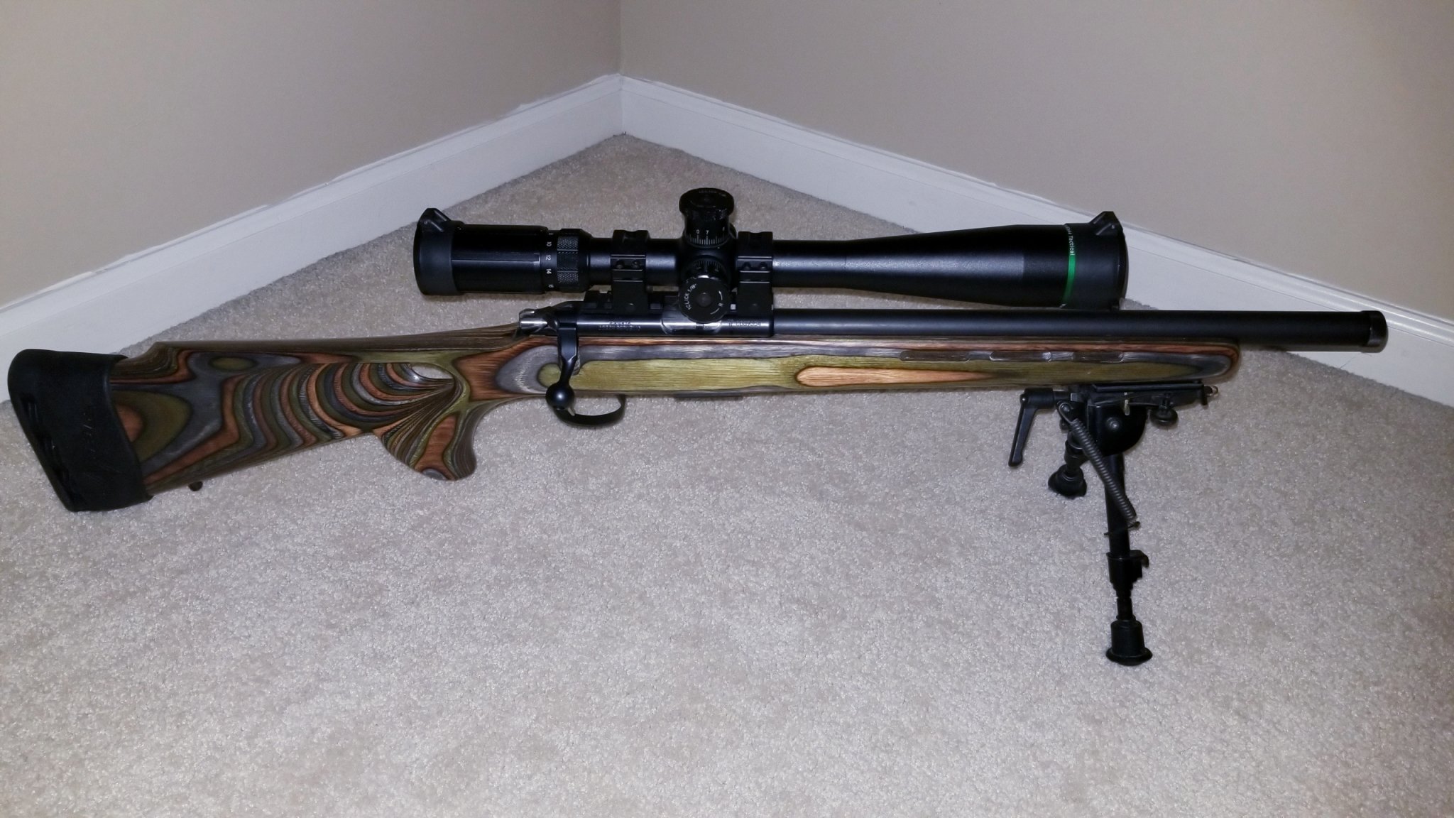

I used to shoot my arsenal of them daily until about 2-2.5 years ago when ammo became hard to find hear in the North East. I actually found my CZ 455 Varmit to be a great shooter! I found that it liked the CCI Maxi-Mag 40gr HP the best. I did well with other ammo but that was the best for my rifle. From what I remember I had no issues grouping 1 MOA at 100yds. But as said above ammo cooperation is the biggest challenge. Good luck.
I recently purchased a new Savage A22mag and while I love the gun right out the box its a horrible travesty against shooting! The cheap plastic stock I swear is made from old milk jugs and has just about as much strength. Would not shoot under a 4 inch group at 50 yds! When I finally figured out the accuracy issue I ordered a Boyd's stock and glass bedded in the action. It's a great shooter now with around 1-1.5 inches at 100 yds and big bug holes at 50. Sadly there is just not really and decent ammo for the 22 mag and I feel that is the limitation of the round.

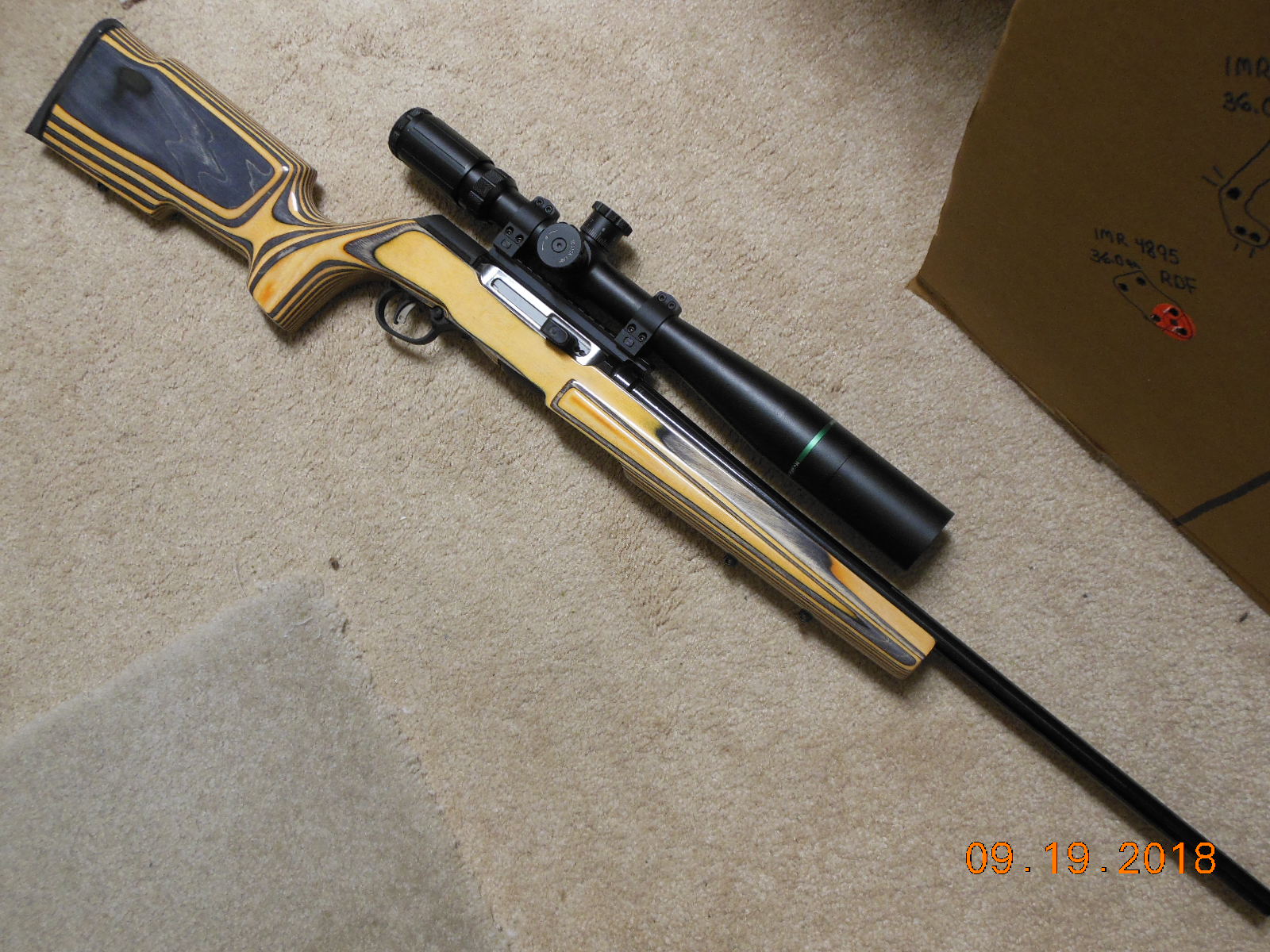

I just tested all the brands and types of 22wmr ammo I could get my hands on.
The entire box, 50 shots at 200 yards, across a chronograph, at a single aimpoint.
CZ 455 Varmint, set trigger, Feddersen 16-1/2 inch heavy barrel, Mueller 8-32x44 scope

Here are the pics of the target results...

I'll be doing this with the 17hmr, 17wsm and 22lr.
It's an entertaining way to start out a morning at the range, before setting up my F-Class 223.
Work out all the yips before attempting precision shooting with my centerfire handloads.
Nice posting of results. Looks like Fiocchi JHP had best groups for you. I too shoot F T/R with .223 - shot this weekend and hosed relay three with a target crossfire... 0 really blows match and an aggregate!
