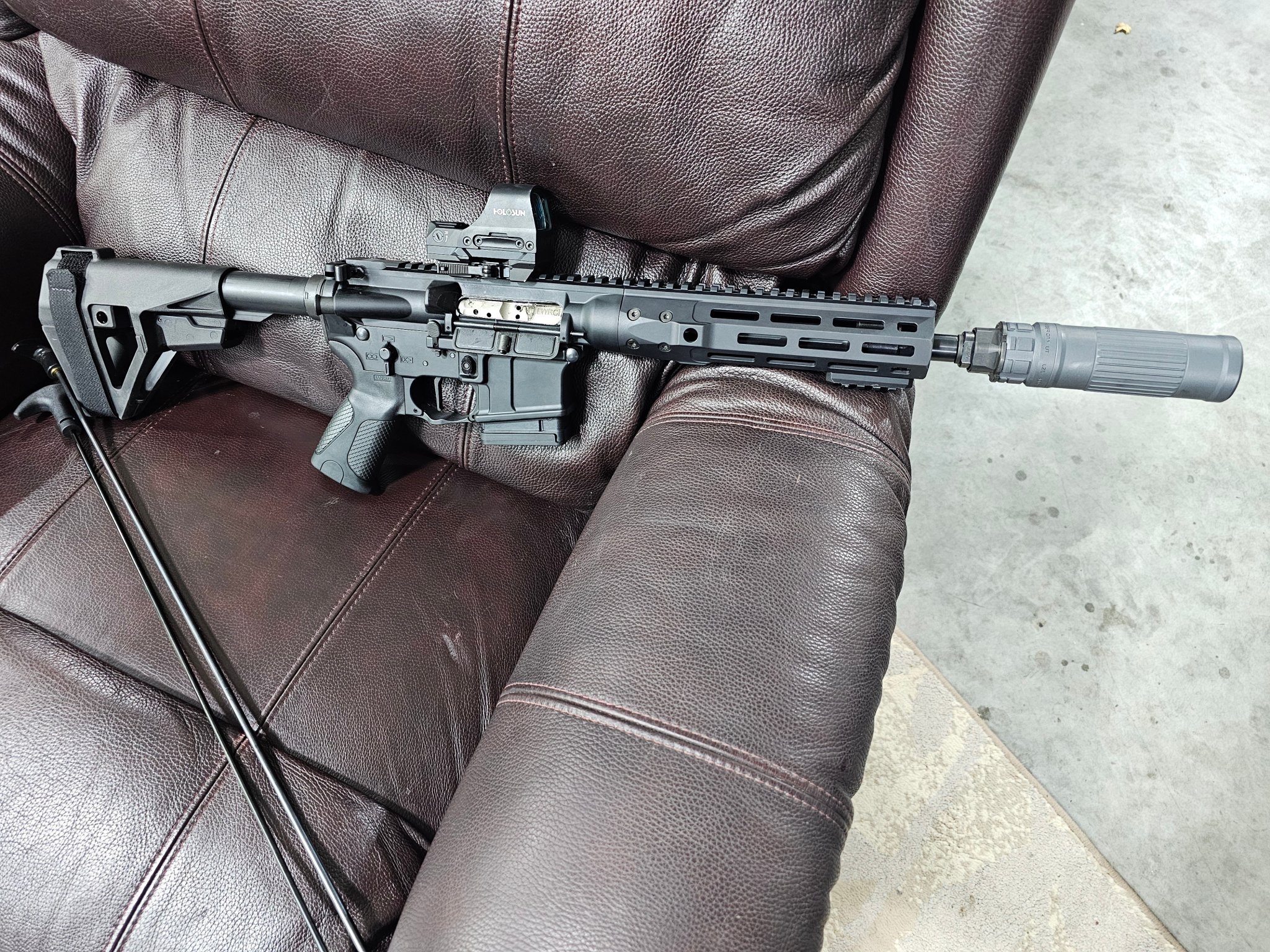

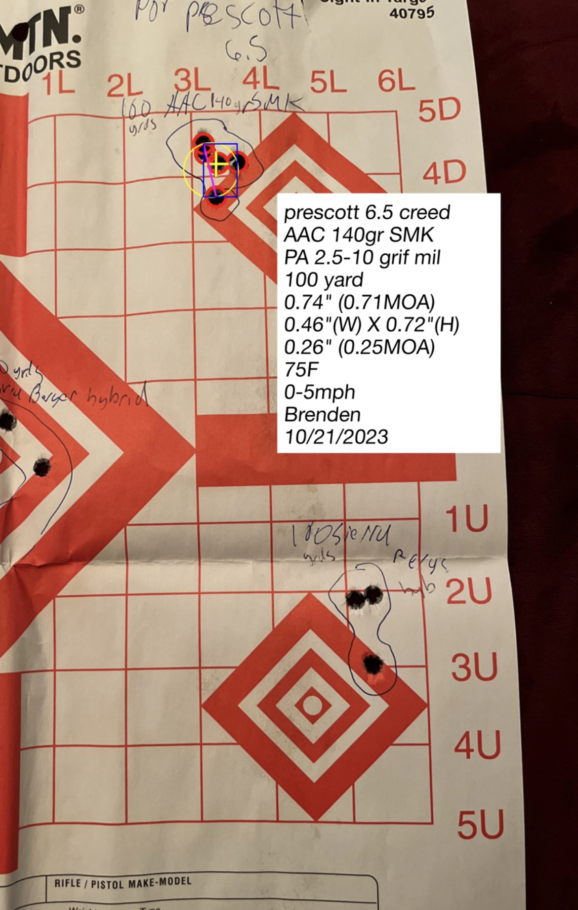

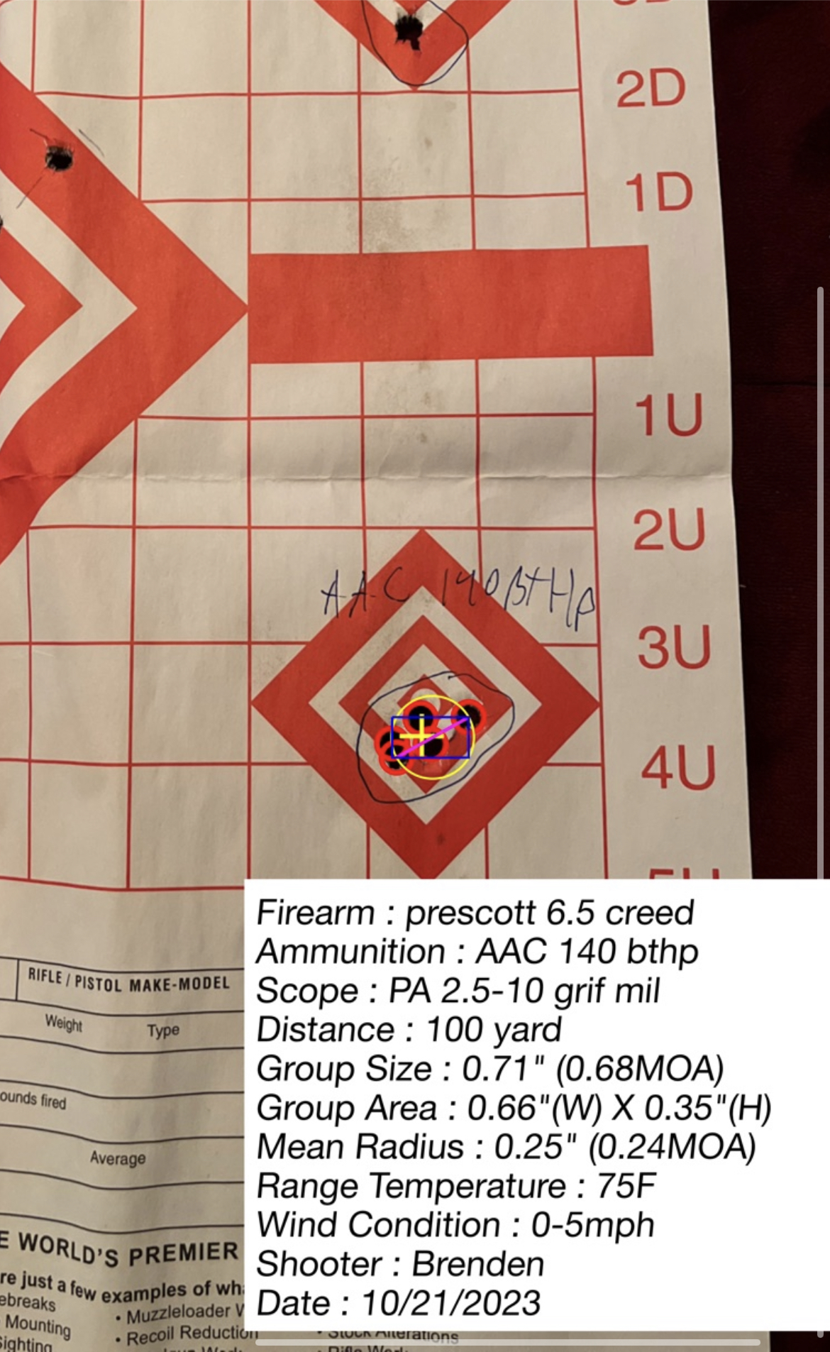

New here but I have a POF Prescott I have been waiting to put some more rounds through before posting a review.

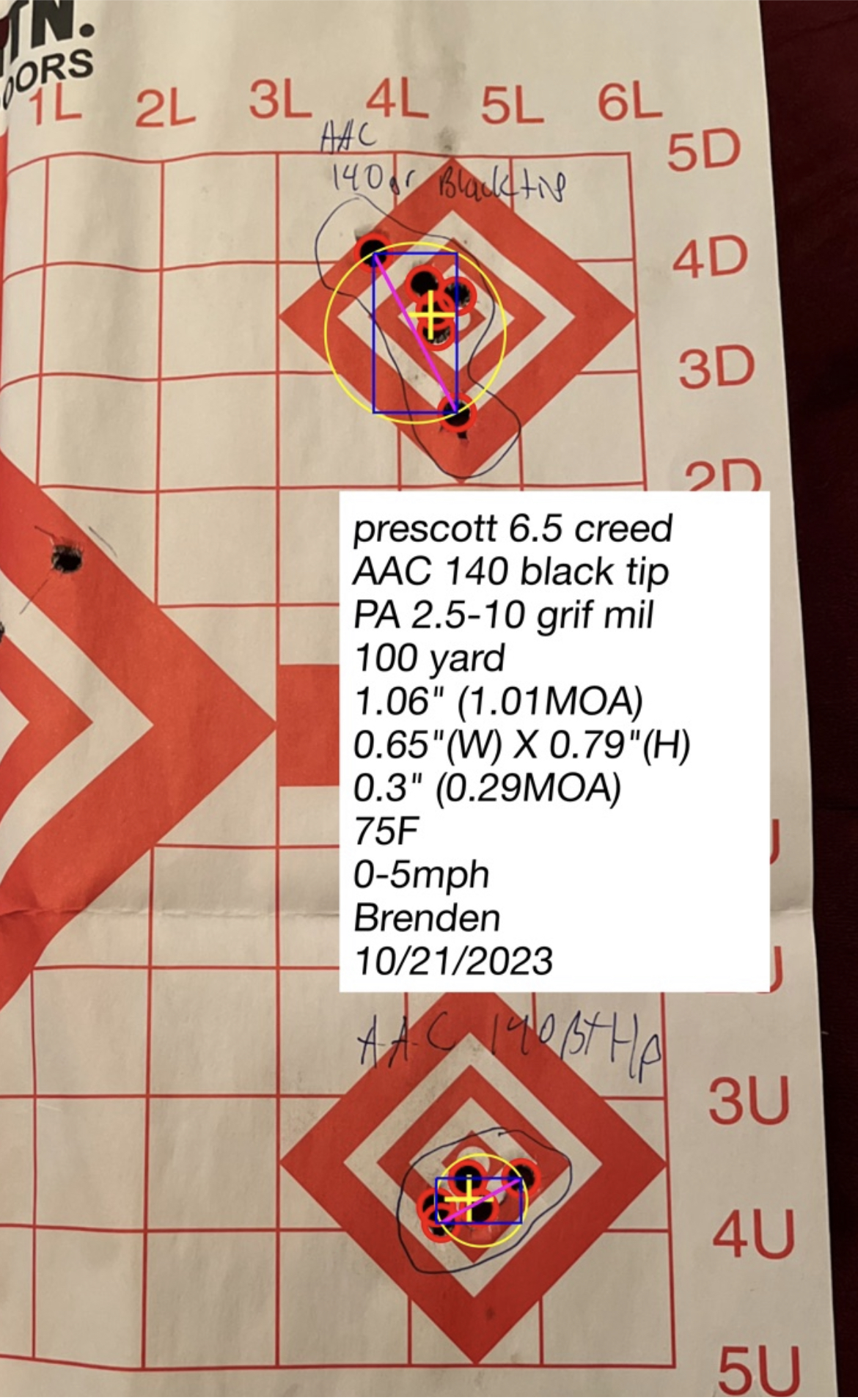

I had some good groups with their 6.5 but I will say the Sabre black tip line was the worst of the bunch for me but still very acceptable for “defensive” ammo.
I have shot their 140 BTHP:
140 Sabre Black tip
140 SMK
140 Sabre Black tip

Man that Prescott looks like it shoots pretty well. I've been thinking about getting one myself. Are you having any issues with it? Does it beat up brass like most Creedmoor ARs?

Yeah, for the money I’m impressed with the precision. I’ve only shot it suppressed and immediately added a superlative agb but still getting some beat up brass. My suppressor is an Enticer-L so it adds a good amount of back pressure. I’m planning on playing with the buffer weight a bit as well just haven’t had time yet. I never shot it stock so unsure what it would do out of the box but given it’s a rifle length 20inch barrel I’d say it’s prolly similar to other traditional 6.5 gassers.
I’ll have a full write up on it once I get to the ~400-500 round range I’m only around the 150 rounds in so far.
Did it not come with the Dictator AGB? Also is the gas tube length Rifle, not +1 or +2?
I had a 6mm Creedmoor +1 and it seemed like it was extracting too early, bending the rims.
mine did not, I don’t believe the rogue or prescott come with agbs. It is rifle length wish it was +1 but unfortunately not. I was just gonna cut it down to 18 but it shoots so well and the flutes are likley too deep to make that work.

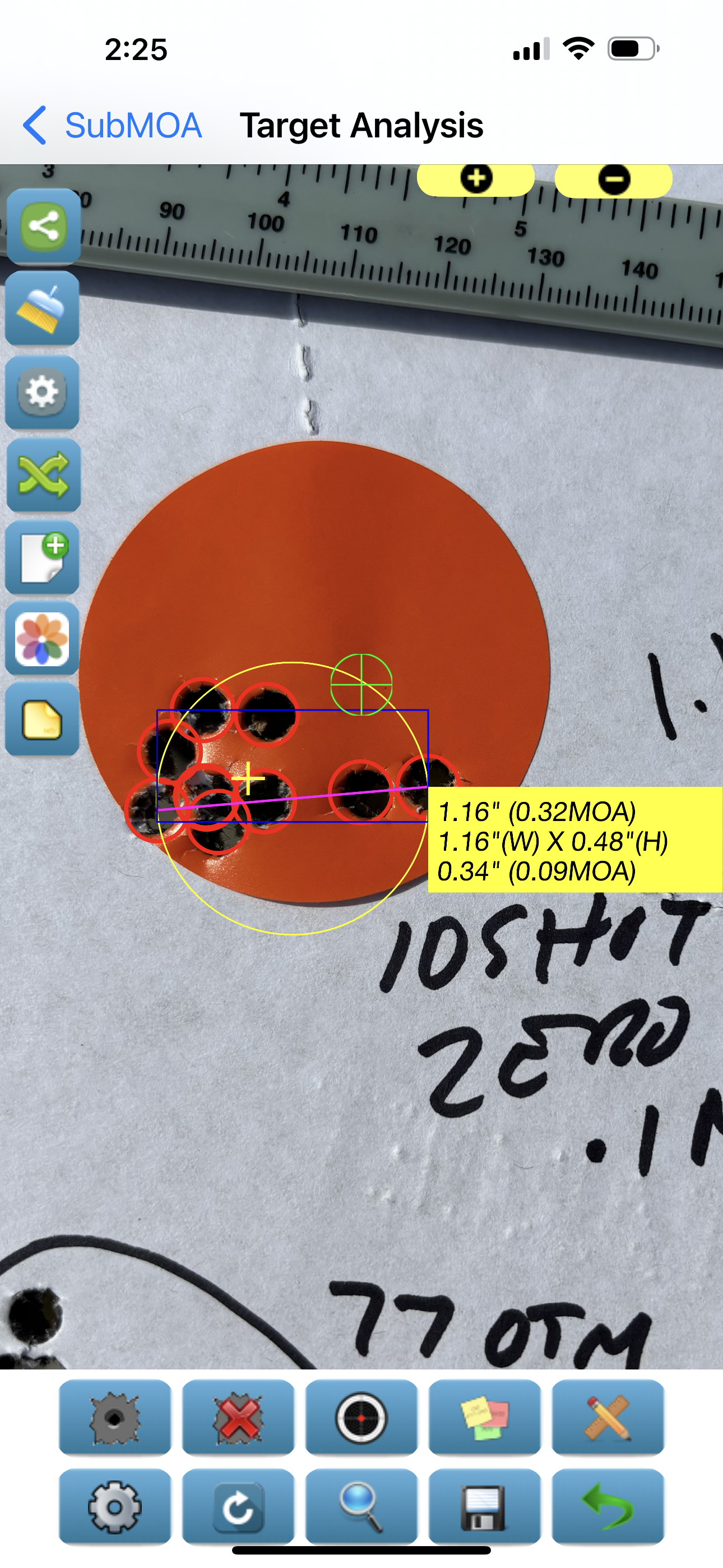

This is one of my my newest LWRC's its a 10.5" pistol that's just waiting for the SBR paperwork to come back. I ran 60rds of the 5.56 77gr SMK through it the first day I picked it up. 3 10rd groups and they were all under 1MOA.

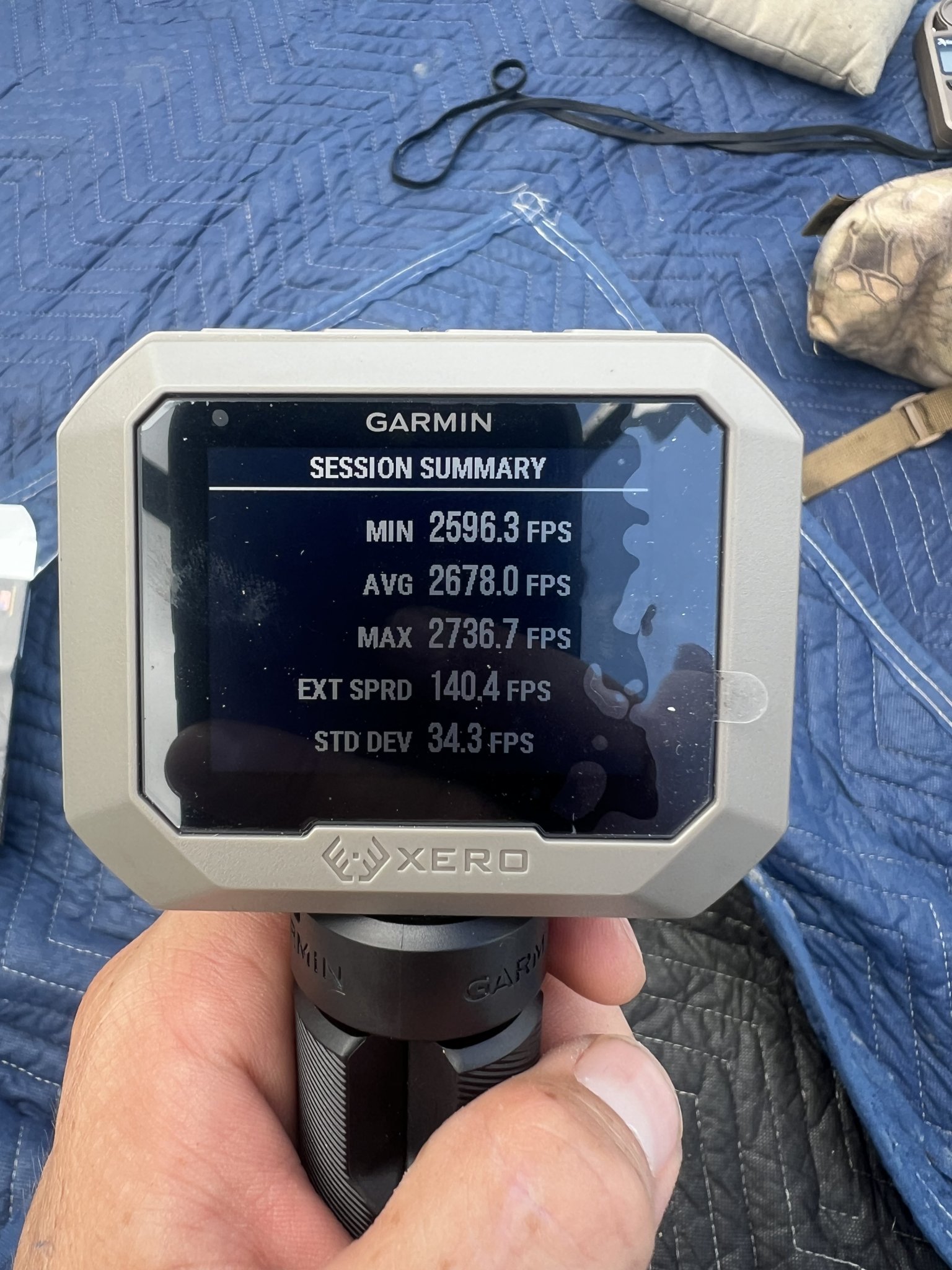

I put around 800 rounds of the AAC 140gr bullets through my criterion barrel AR10 last year. They all shot well at 100 yards but once I got out to around 750-1300 I noticed the consistency shot to shot dropped off. I suspect the SD's were really high but I didn't have a chronograph to verify it with. One round would be spot on the next one would be like 4 feet low. I would recommend it for plinking if it is still cheap and plentiful.

My experience as well. Had a sd of 130 in 50 rounds. Some would just be way off
