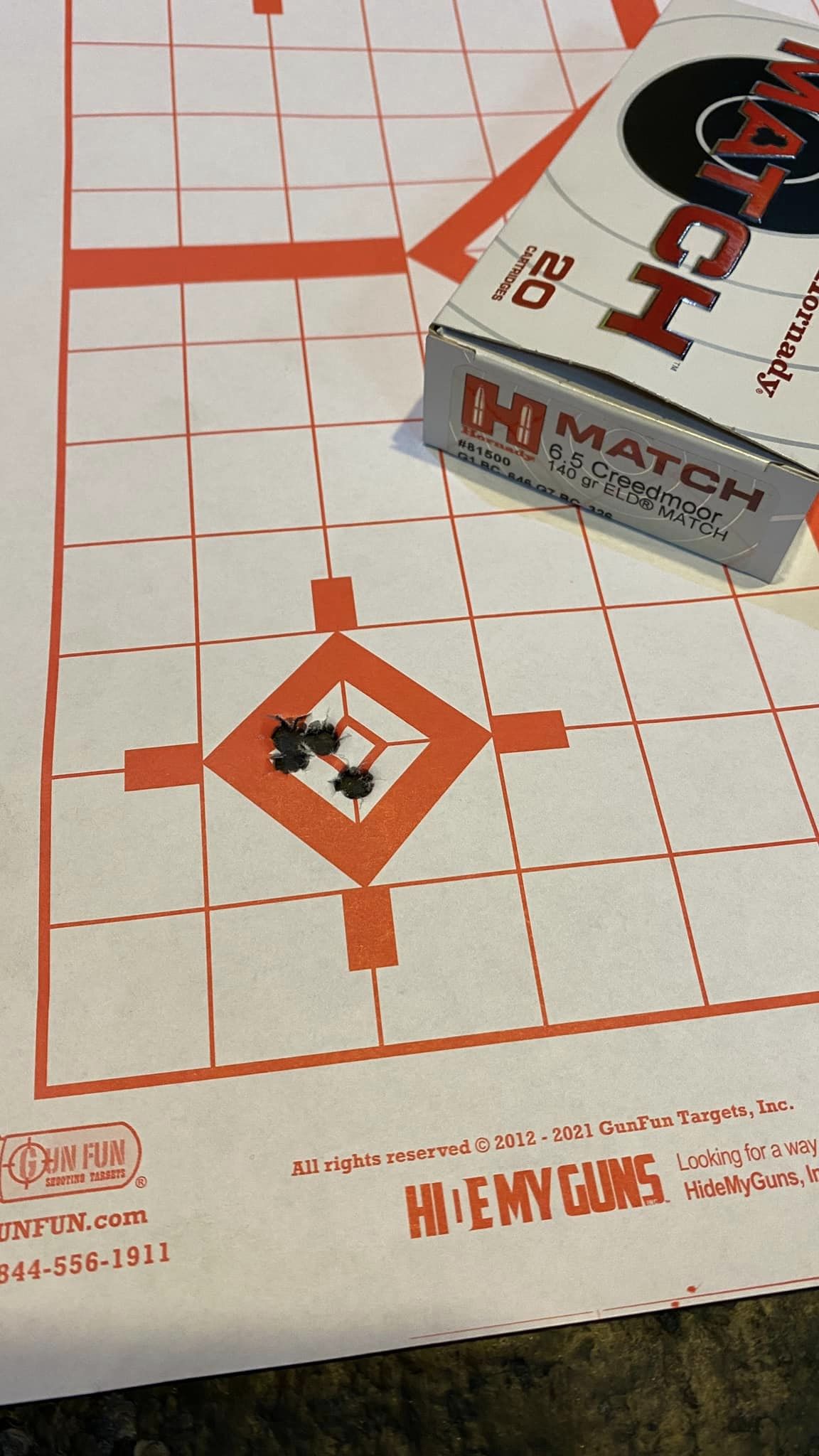

Mine absolutely loved Hornady 140gr and the (then) cheap Win black box Match 140gr (smk I think). Tried, some Fed GMM but given the less-expensive stuff shot just as good, if not better, I stuck with that

I teach a bunch of classes and we are having great results through that exact rifle with Hornady new military 147 grain load

All the factory Hornady 130-140-147 ELD have shot MOA out of my gun. I feel like a bunch of ammo will shoot MOA, but Jesus the price is gross. Good luck getting your reloading up to speed.

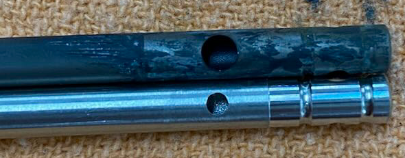

Installed a 0.086 Black River Tactical EZTune gas tube in my 24" factory LMT SS barrel in 6.5 Creedmoor, unsuppressed. No issues cycling with a 3.0 oz carbine buffer and the factory LMT buffer spring. Ammo is Hornady American Gunner 140gr HPBT. Cases eject at 4 o'clock and land about 6 feet away. The last round ejects at 3 o'clock due to no upward pressure on the BCG from the empty magazine.
BRT originally sent me a 0.078 gas tube, but the rifle would not cycle properly. They shipped me the 0.086 tube at no cost and a prepaid return label for the 0.078 tube.
Here's the factory LMT gas tube compared to the 0.078 BRT gas tube.
Originally I used a 8.5 XH carbine buffer and 308 spring from Heavy Buffers. The XH buffer works well to tame the MWS, but it does add a lot of reciprocating mass. The BRT tube and the 3.0 oz buffer operates a lot smoother and there less induced forward movement when the BCG closes.
