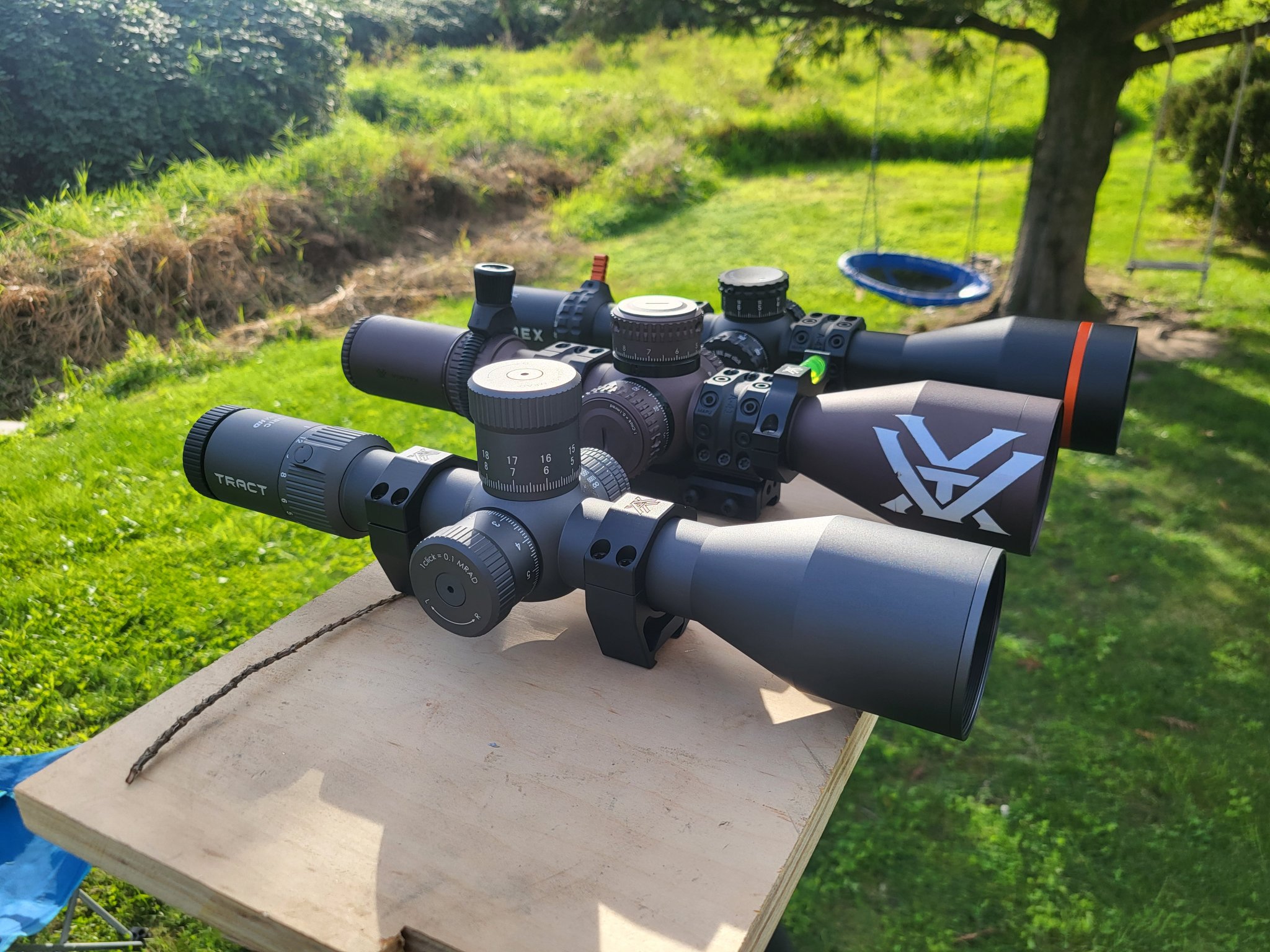

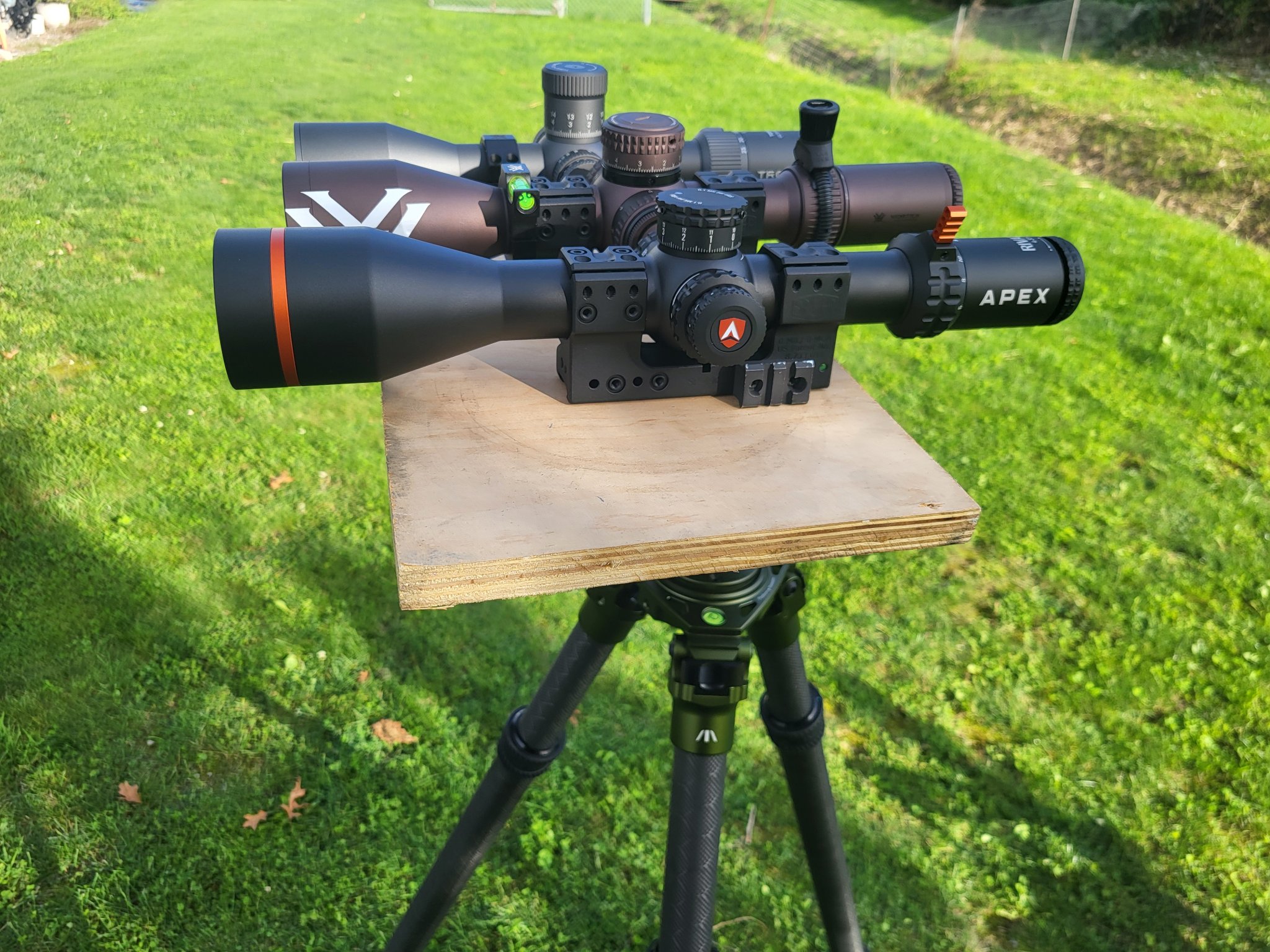

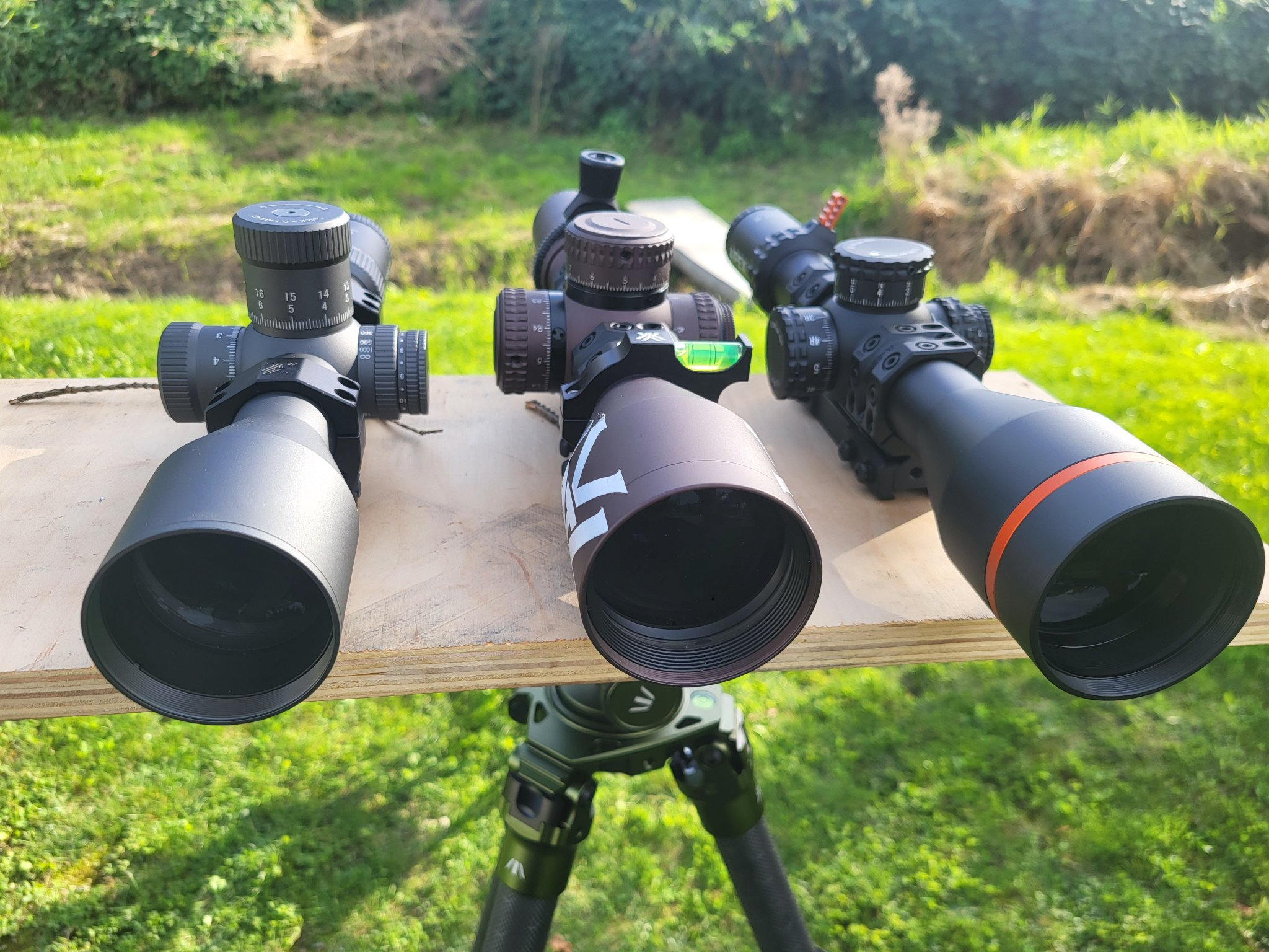

It's been a while that someone posted here about the Rival. So I thought i share my experience.
Yesterday i decided to take my scopes off and do a little testing and comparison.
Specimens are
Apex RivalX 4-32x56
Vortex Razor Gen2 4.5-27x56
Tract Toric 4-25x50 ( I know it is not in the same mag and objective bracket but i wanted to see how it performed.)
All scopes in MIL and set to 15 magnification because that's where am most of the time when i shoot. Also turrets set to the middle of adjustment range to keep it fair as possible.
We tested at 100yards and over a mile on my Fat Boy Tripod with an Improvised board.
Sample size of one each, so don't take everything to serious here.
Not brand loyal to anyone otherwise i would not have three different scopes from three different brands!
You make a good product " I am in" you make a bad product " I am out".
Test took about 4 hours with help of my Wifey, neighbour and his son which is a ERT team member of police in Canada. ( ERT stands for Emergency Response Team of the RCMP here in Canada) Similar to SWAT teams in the states i guess. So i am located in Canada.
What we tested was Focus, Parallax, Field of view, Edge to edge clarity, colors, distortion, low light performance, reticle
In total 4 people, 2 have optics and firearms experience and 2 doesn't just to see what there eye is telling us.
Focus: was easy to adjust and set on all three off them. Smooth turning and stays put so it won't move on you.
Parallax: The Apex Rival was very easy to adjust. It was "in"or "out" that's it. I like that. Best out of the three.
Vortex Razor was a little more fine tuning required till it was just right. Good though
Tract Toric was a little finicky and needed more attention on the dial to get it right. That costs more time on a PRS stage if you have to mess around with it.
Field of view was great on all of them. The Tract should have more when you look at the specs on there website but i was about the same with the other ones. No big difference there at least not much of a difference to our eyes.
Optical performance is probably what most guys are interest in when comparing scopes and i can tell you right out of the bat that the Toric even with the smaller objective lens of 50mm was better performing than the other two. We were all surprised that it performed better during the day in different light conditions and at low light towards the end of the day. The Schott Glass really gathered some freaking light in there. WOW that's bright!
Just in general the clarity, brightness, colours, edge to edge image was the best with the Tract.
Second was the Apex Rival. Excellent during the day but the edges were not clear and crisp. Colours and Image was still good and close to the Tract.
The Vortex is in my arsenal the longest and you can tell that the optical design is older compared to the other two.
The image was clear to all of us but it was slightly darker overall compared to the other two. We all agreed on that.
I have the Vortex for about 4-5 years now and it was not ones at the warranty department.;)
Reliability is top(y)
We did our best to line up behind the scopes as good and consistent as possible but it gets tiring for the eyes after a while.
Just wanted to remind that we are nitpicking here on the optics, All three are capable of spotting and hitting steel at distance.
The Apex actually has a warranty claim as i am writing this. The zero stop/rev indicator is not working as intended.
After I passed the first revolution, the rev. indicator pops up and as you turn further it falls back down in place and prevents me from turning back to zero. Anyone else have this issue?
Imagine that happens during a match:oops:
After talking to Apex, they are sending me a new Elevation Turret Cap. I hope this resolves the issue but leaves a big question mark about quality and long term reliability.
My personal preference from each optic:
I like the Apex CLR reticle the best with the Tract ELR right after and the Vortex EBR-7C last. You make your own choice.
Mag range indication is also best on the Apex at least for me, because it is tilted on an angle and you can see it better behind the rifle.
Included throw lever is great as well. I wish Vortex and Tract would do that too.
The best turrets are the Tract, hard zero stop like a brick wall,tactile clicks, smooth turning turrets, nice big numbers,
Locking Elevation and Windage turrets are effortless to operate. Just taller turrets then all others if that's a con.
The Apex Rival is missing the locking function. I wish they would have it at least on the windage turret.
Nice feeling turrets though and short.
Vortex Razor Locking turrets is a little harder to disengage and engage and the clicks are LOUD and takes a little more effort to turn.
Nothing bad just personal preference.
Overall we picked the Tract over the other two. Fit and finish is better than the other two, Controls are just butter smooth and effortless!
If I could, I would implement a few changes to the Tract like shorter turrets, Mag range indication tilt up, the CLR reticle, Parallax adjustment of the Apex Rival, Just wishful thinking;)
Maybe Tract is listening! It would be a Hybrid between the Tract and the Apex.
I hope you guys like my little write up and test.
Please correct me if something is wrong and keep the comments positive and criticism respectful.
Thank you.
Thank you.
