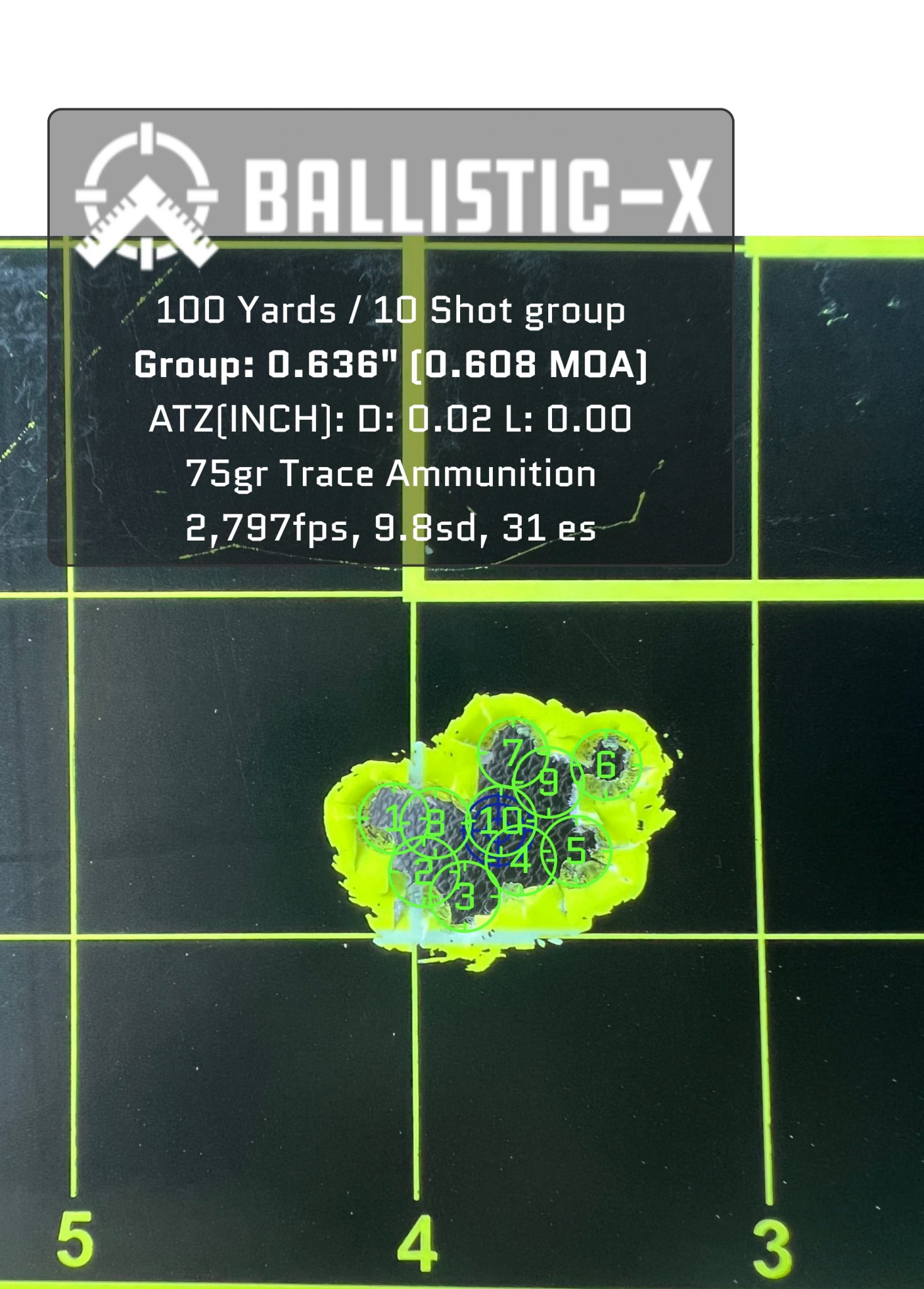

    I can’t speak to the brass, but I can tell you the results are impressive. I tested it thru a factory JP rifle and got sub Moa easily. First shot on the second target was checking zero.
    Chris
