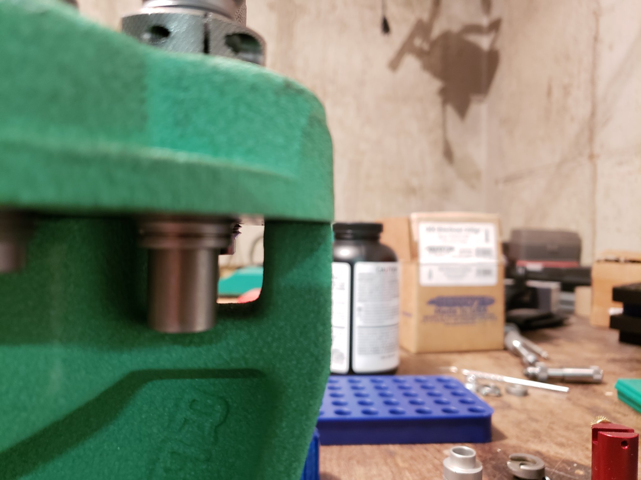

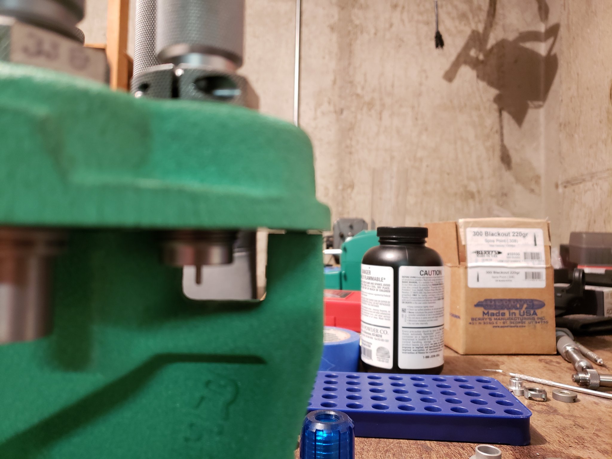

    I had flex in mine. Probably about .002 or so of random tilt. Noticed it in bullet seating originally.
    Turns out if you stone about a thou off of the turret bushing it takes that slop out. The downside is the turret is much harder to rotate because of the lack of clearance between the frame and the turret mount point. Not impossible to turn, but definitely requires more force.
    Reactions: Hillpuller and KZP
    Same as AIAW....had the press for about a dozen years...I really like it. I did have a little flex, but ran the bushing on some 1200 paper to take a thou or two off and it’s very consistent. The ability to keep the dies set and not have to try to get them back to the exact same setup every time I switch calibers is very nice. On my 6.5 Creed and 6 BRA TIR on loaded rounds is typically .0015-002 around the ogive—much less by the neck. Using Whidden and Forester seating dies...don’t think I can consistently do much better than that.
    ZY
    Reactions: AIAW
    Enough you can see it. First pic you can see light through the back of the press where the detent is. Second pic is fully raise with brass in the die and the light is gone.
    Huskydriver....that’s a good pic, illustrates the issue well. Stoning the bushing will significantly decrease that gap.
    ZY
    I stoned mine years ago. Just gotta go real slow bc if you over do it you will get grinding when you turn the turret. I may have done mine a thou too much, but not too bad at all. I don’t think I needed to stone it though. Another case of me trying to fix something that wasn’t even broken
    So I went thru all of my turrets to see if it looked like your press and even with the ram down it looks like the second picture without the gap. I don’t know why it’s different than yours but I thought it was worth mentioning my experience.
