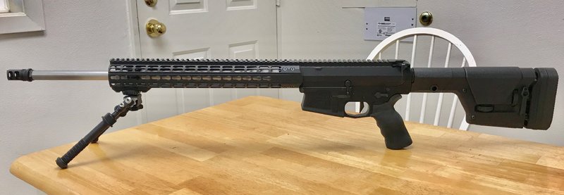

Here is mine, built on an Aero M5E1 set. Still saving for the glass so I can't comment on accuracy yet but the build went together well. Like stated before, if I had the budget I would have went for the Mega but I am happy so far with the Aero.

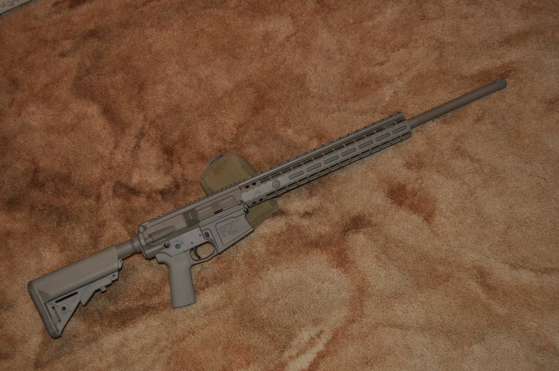

I've put several of the Aero Prec M5 & M5E1s together - all 6.5 CM - using both Ballistic Advantage & Krieger bbls. This one has B5 Bravo SOPMOD buttstock & PG, a contoured Krieger I chambered & finished at 24", JP LMOS/HP bolt, SLR Sentry 9 adjustable gas tap, RRA lower parts kit w/NM 2-stage trigger. I ordered the upper & handguard in Magpul FDE (all they had in stock at the time), then blasted & painted the lower to match. Haven't shot it much so far, just enough to fine-tune the gas tap with Hornady 140 AMax Match Ammo. Need to work with handloads in it to see what it's capable of.
